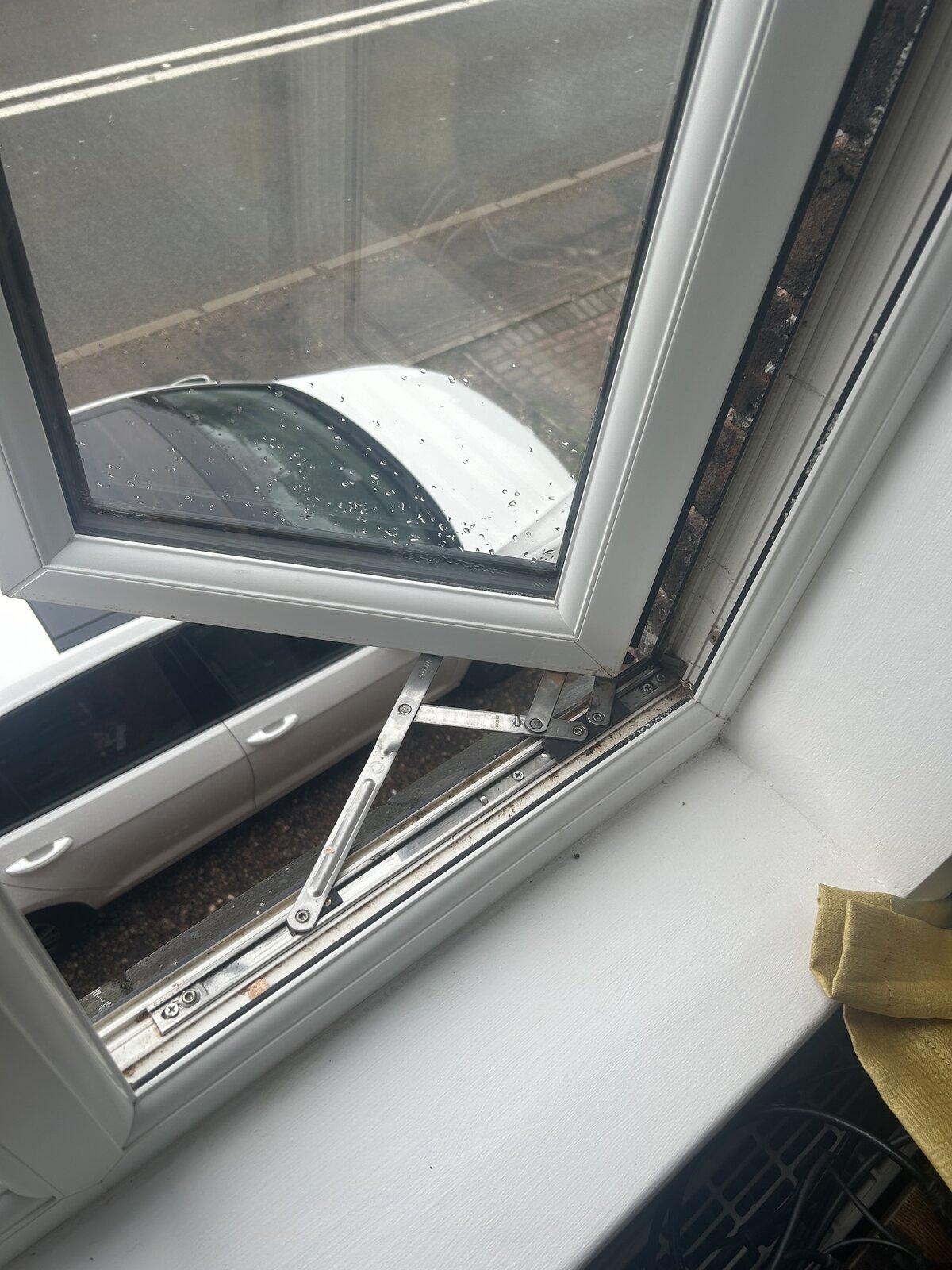

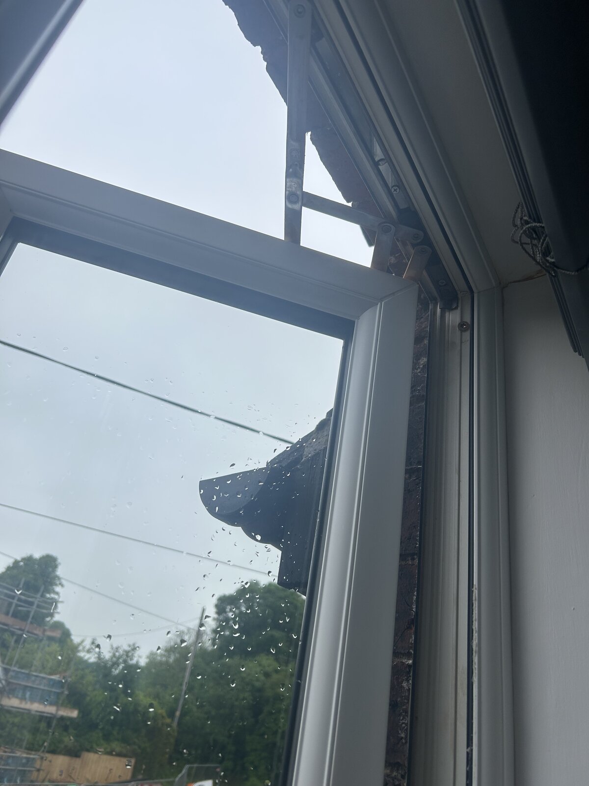

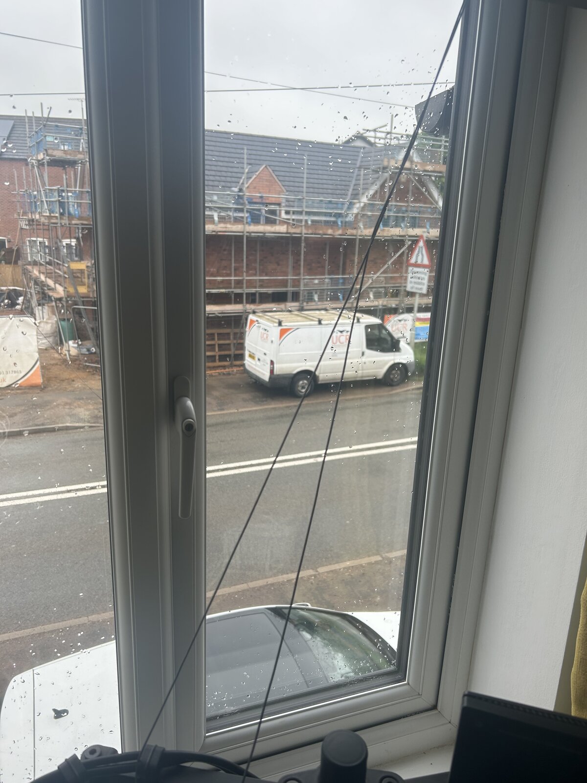

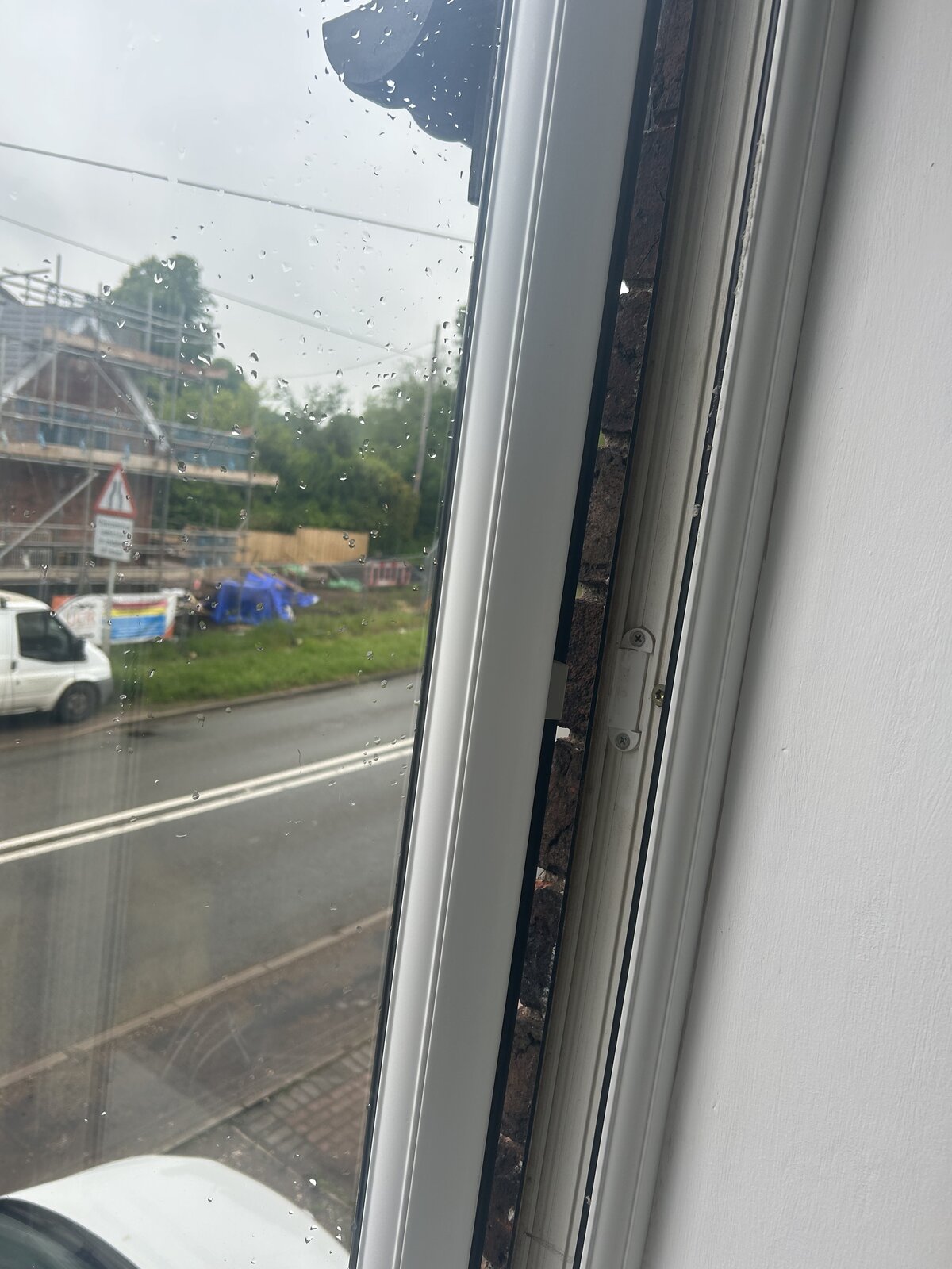

Hello all!
So, bought a house in 2021 and 6 months prior the previous owners had all the front windows replaced. All 4 sets have side hung, outwards openings. In the middle of the hinge side opening (vertical), there is a gap large enough to fit a piece of card through. A trades person who is replacing a glazing unit (hit by stone from road) pointed out this defect to us.
When we had the place knocked off internally, there is a wooden frame that the window sits in. there were gaps on the sides which the plasterer said are usually braced by further timbers when installing modern windows in an old (1800s) house?
I have rung the installer (found the CERTASS certificate), but he has yet to respond. I've dealt with this person before for other poor / failed workmanship and am preparing for a long-running row.
My questions are:
What do you believe the issue is here?
Can it be remedied easily - i.e. not a complete remove and replace?
Anything I should mention to the tradesperson in particular?
Pictures attached.
Ben

Just spoken to the contractor who put the windows in. Conversation started with a blatant lie which set the tone. Said he couldn't get to us for 6 weeks (we're 5 miles from his business) because he's so busy. Then says the guarantee for installation is none transferable. Still offers to come out, but not sure what he can do...
I guess the question is, are these fixable or do we need to start again...?
Guarantee is 100% transferable ... it's one of Certass's rules and has been for a while BUT not sure when it came in. First guess at that position, would be the frame is bowed slightly . Depending on the height of the window I'm not sure there is enough fixings in it , they should be no more than 600mm apart
