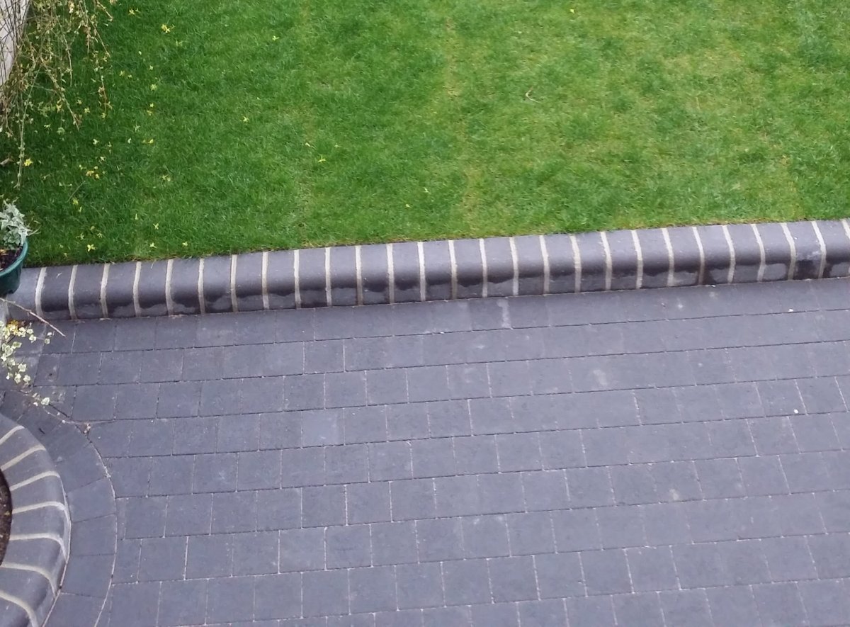

The job is done, I asked him about the inspection looking chamber and he said it was redundant. I don't think it would have been a problem to insert a cover with the patio if needed unless he forgot to instruct his employee to put one there!
Must I legally have one somewhere on my property because I don't think I have one? Could I share one with either one of my neighbours?
I can only take his word for it as he's supposed to be the expert, just hope I won't find myself in a ****ty situation later on.
The main thing is that all runs of drain can be rodded from one end or the other. If that's from next door it's not ideal but at least possible. Our architect designed our extension with a chamber just outside, the builder tried to convince us he knew better but of course it depends whether they just want to save some time. So if you think one would be necessary to rod any part of your drains then get him to correct that.
