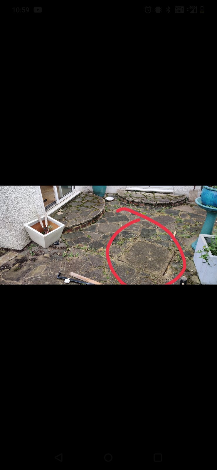

Hi all,
I was checking the drain maps on my property and discovered that the foul sewer line runs through the garden v close to an extension I have. I had plans to knock down or add to this extension but thought the sewer line may create challenges with build over etc.
I have two manhole covers down an alley nowhere near the area I would extend to. I check the flow of sewage and waste and it doesn't go to the back of the property according to Thames Waters map rather to the front.
However there is a sewer line running through the garden according to maps and neighbours flow does go to back.

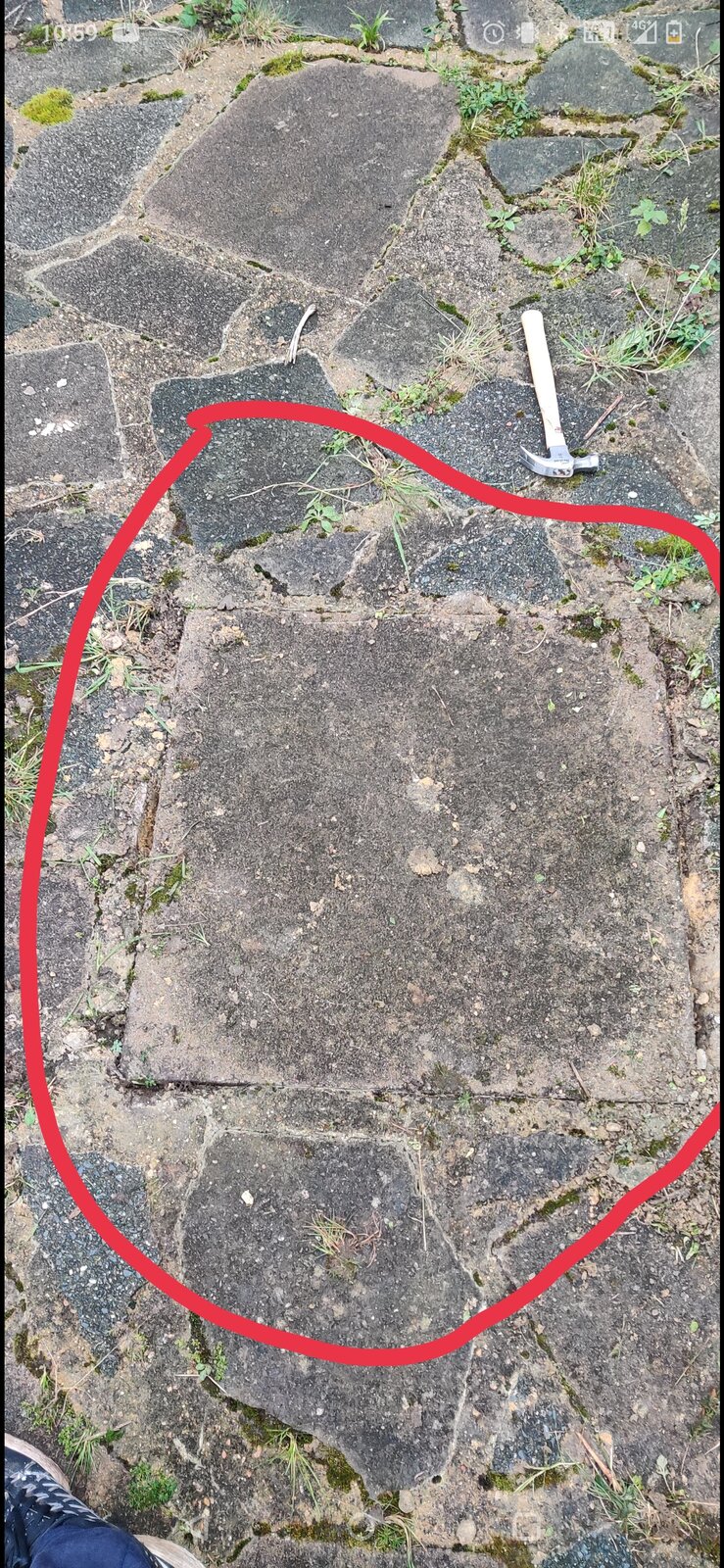

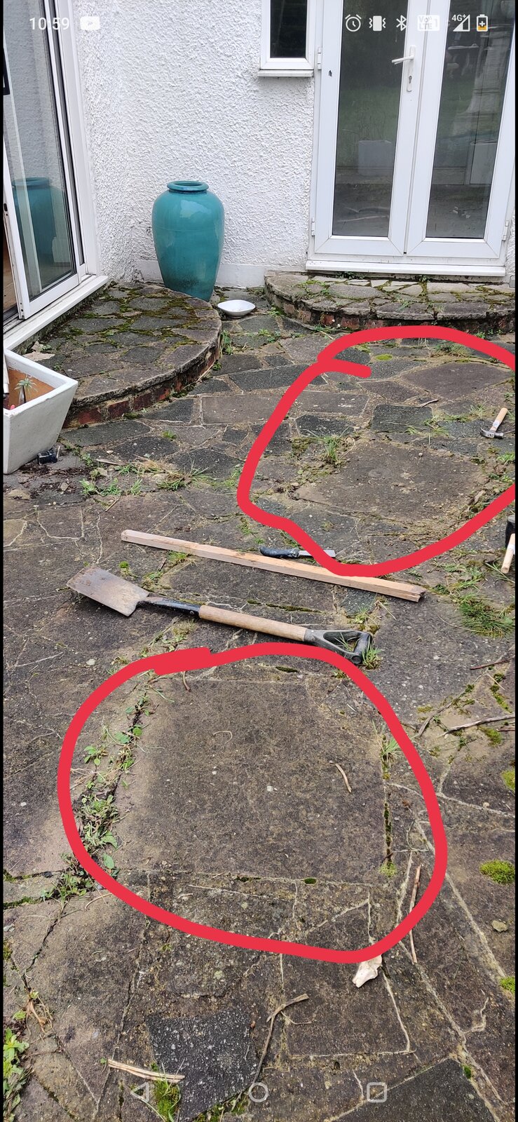

So I wanted to see if I could get an idea of the diameter of the pipe and used the manholes I can see to do that that's all good got it. But then when I was looking at the crazy paving I noticed a questionable perfect couple of rectangular slabs in the paving. I'm immediately thinking there could be drains under here.
I need to look. Because if they are drains that need access they would have to be moved and that may affect any plans to extend. I can't for the life of me pry them up. Any advice? They got to be drains or at least one which would make 3 or 4 manholes in this property alone.
Thanks,

Wrecking/crow bar (the rigid type not the flat ones that flex)

Slabbing around an IC tends to settle more than the IC, meaning the covering slab would have tell-tale cracking around it. As said, lift them up with a pick or a strong shovel.

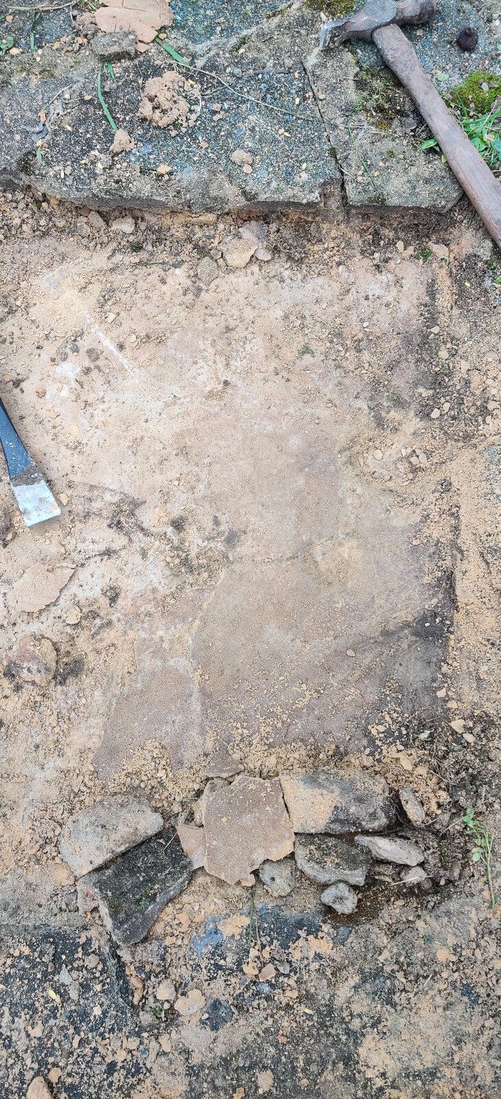

Success. Got one up. God knows what's under here how should I proceed?

Break the mortar, very gently.
Crack the edges with a chisel and lift it up.
It will probably break into smaller pieces.
In fact, there's a bit on the bottom left that has an edge, try starting the lifting from there.

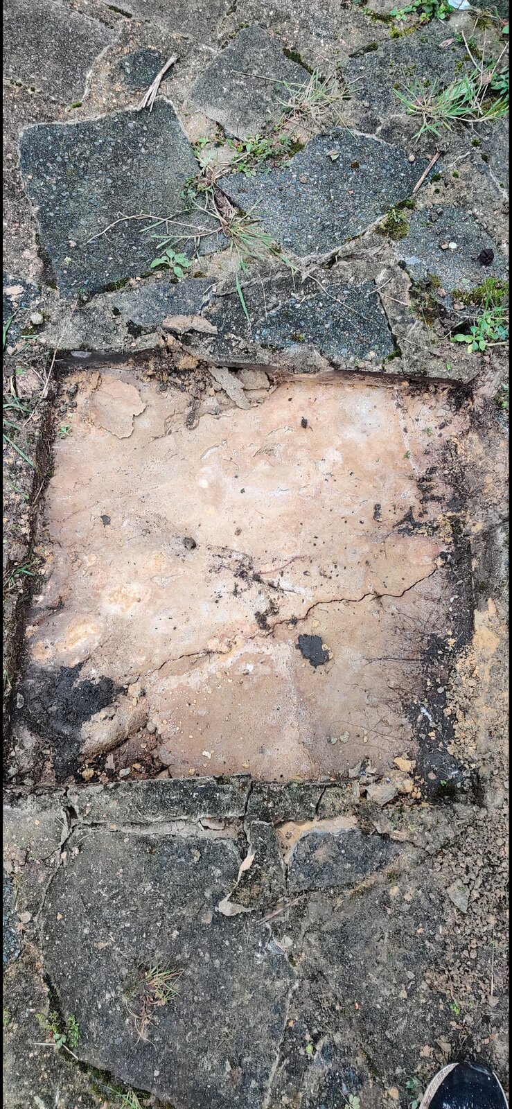

Yeah I saw that and wondered what it is it was quite hard. I'll try a different and see. It's definitely covering something
I wonder if it's just that Mr Crazy Pave just happened to have two whole ones and a load of shrapnel.
Do your neighbours have chambers in their back gardens? If so then ask to have a look in them, hopefully this would give more of a clue than just wrecking anything rectangular!
Just seems to be some stone... Not sure I can go much farther... I'm not sure how deep this is.

Yep I think the plans are correct. What I want to ascertain is if there is a IC under here. Because if there is I'm unlikely to get a build over agreement to extend sideways or if I do a huge expense to move the chamber. Anyway I went down a couple of inches and it's solid. No idea.
