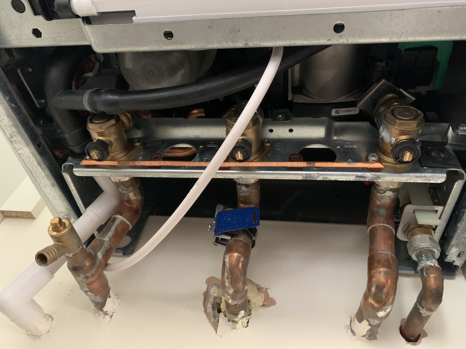

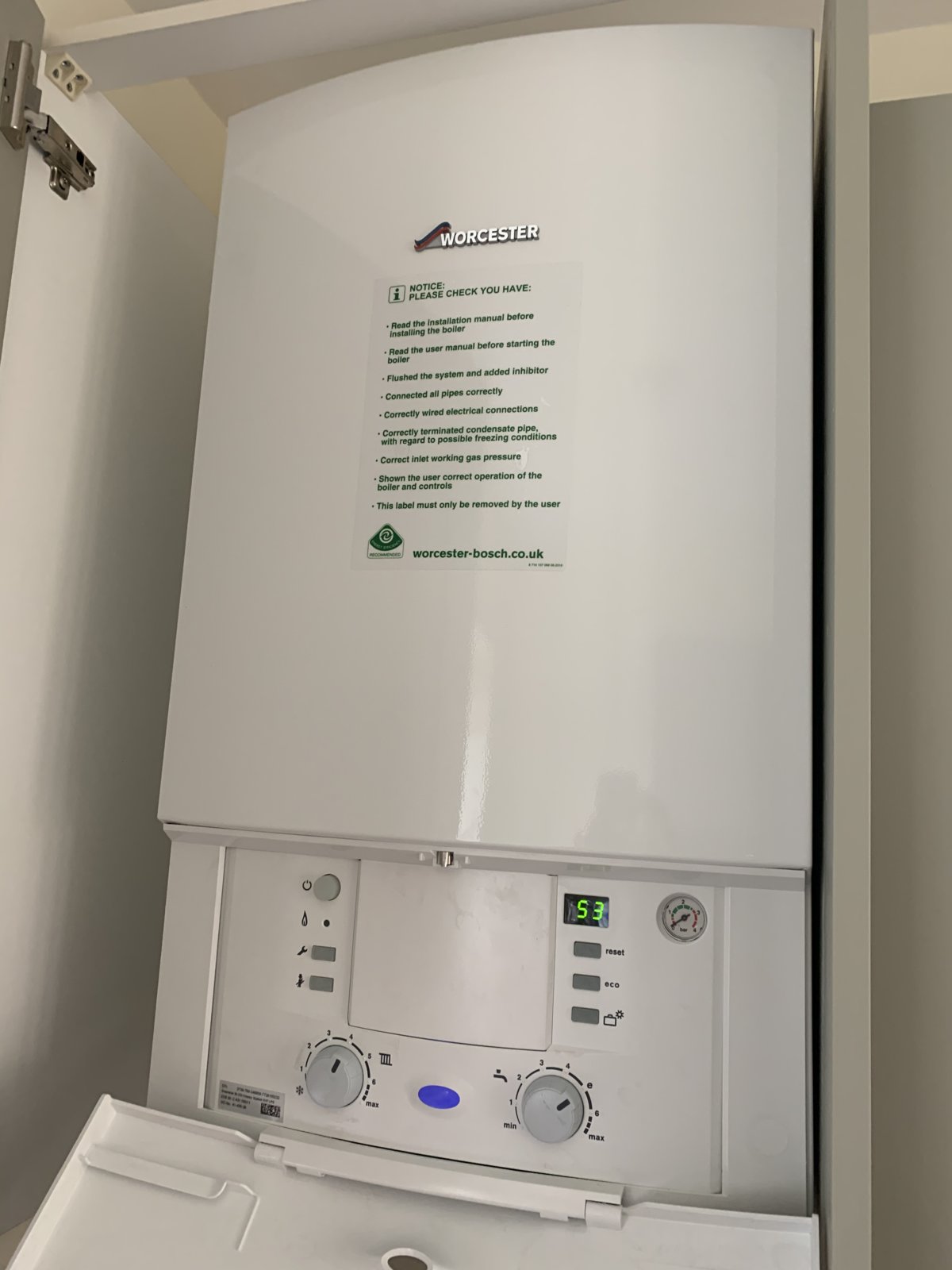

We have just moved into a new build which has been empty for 2 years ... the towel rail has to be bled because it was full of air - we now have no pressure ... all of the guides and videos show using a special key (which we don’t have) in a port underneath which we also don’t seem to have.
Pictures attached ... any advice greatly appreciated!

Your filling loop is elsewhere on the pipework ,it is not in the pic .
Look for a silvery braided hose thingy, most likely in your airing cupboard.
