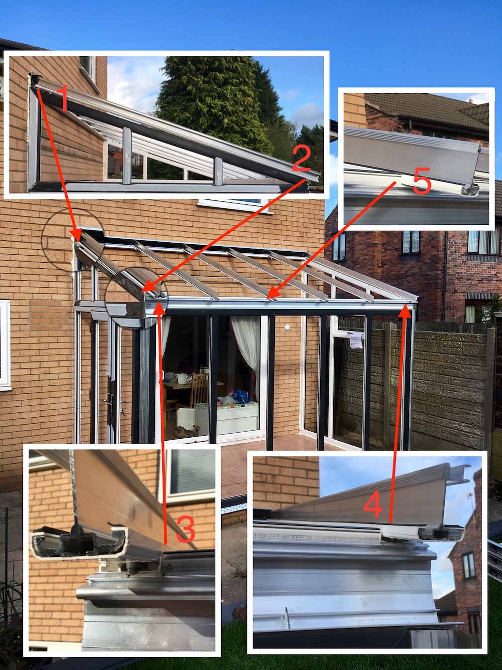

Hi,
Fitters have gone home, they are due back tomorrow to fit the glass.
Looking at it, a few dubious things. I would be grateful if someone could help and confirm my fears please with the rafters to roof.
At Point 1 rafter is 20mm above frame and at Point 2 it is touching frame leaving a triangular gap between frame and rafter. This is the same on the other side. I am worried this is just going to have a cover piece stuck over, hiding it.
At Point 3 and Point 4 the outside rafters are 10mm above the rest of the surrounding seals so the glass won’t sit flush. The middle 4 rafters Point 5 sit correctly.
Thank you.

But I agree with all your points I would have thought they would just fill it all with mastic unless you stand over them and get it fixed.

Thanks, iPhone SE, the little one. They chamfered the frame in the end so they sit better, but yes, mastic, trim and expanding foam! Went off site in afternoon, something urgent, so not all glass in yet.
Ask them why the glazing bars have not been seated properly and tell them to rectify it before they fit the glass.
Its your hard earned ...youre the boss.
It’s hard to get the front eaves beam trim on when the bars are bolted right down they are usually tightened afterwards (as long as they don’t forget). Still, keep an eye on them though.
