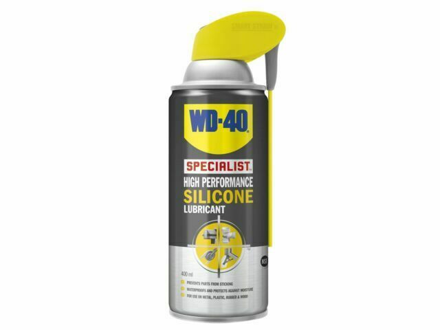

WD40 Silicon spray lubricant.

The objection is to anything that leaves an oily or greasy film, which holds dirt and grit and causes wear, so the silicone grease is also unsuitable.
Graphite powder and teflon particles are dry lubricants and suitable.
Some older greases used to stiffen with age and go hard, but I do not think I have seen that with modern grease.
