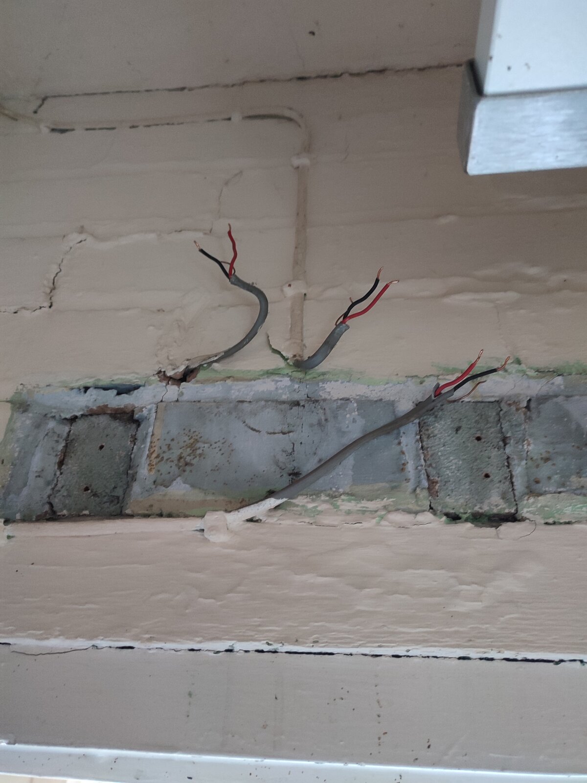

So I've just removed a cracked lightbulb housing and didn't expect so many wires.
I have a new lightbulb housing but before I fit it I want to know if I can use these wires to wire an outdoor PIR security light?
The external wall is just to the right of the photo so I can run a straight line of flex through the wall.
As for these 3 cables.
The left hand one traces through the wall into the pantry lightbulb which are both controlled with a single wall switch just out of shot.
The top wire traces up through the ceiling to the bathroom.
The wire on the right hand side traces into the wall switch that is just out of camera shot.
I want the outdoor PIR light to independent isolated with a switch so we can switch it off in daylight time avoid pets and birds from tripping it.
Any advice is much appreciated.

Damm I can't believe I forgot to add the photo i took before I removed it! I hope this helps!

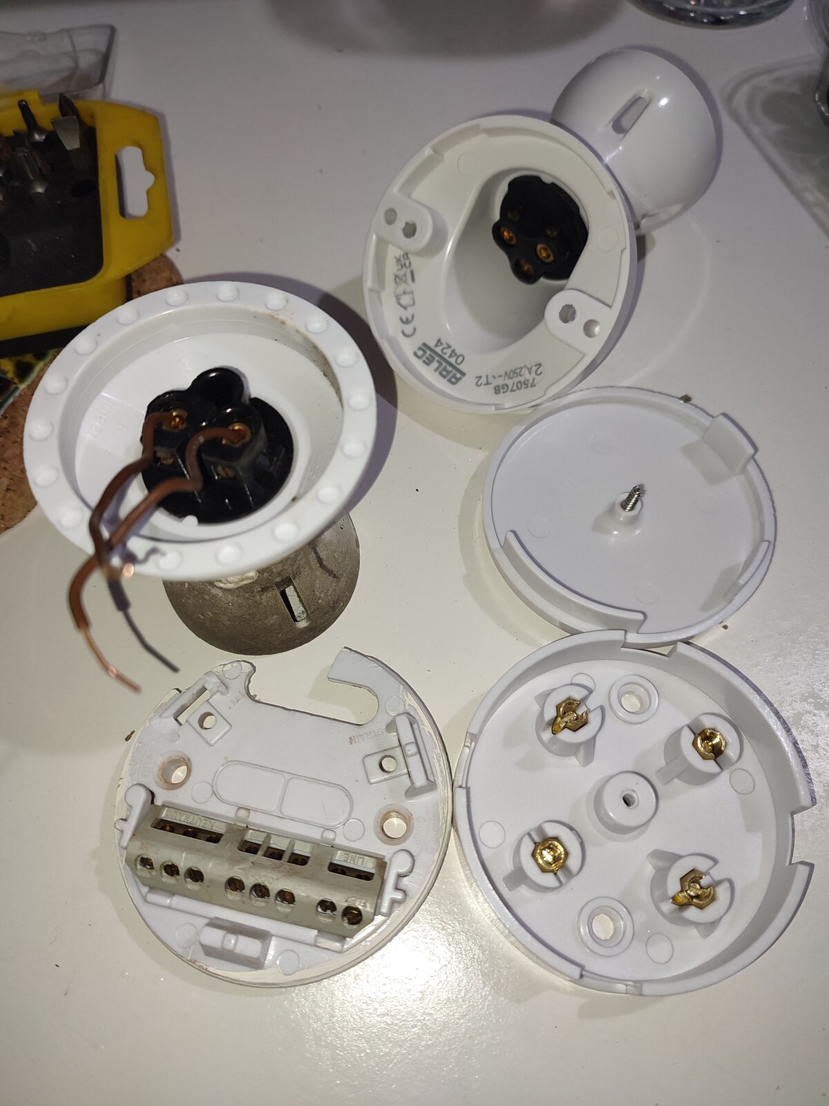

I picked up a new bulb socket and also what was the only thing in Wickes that looked remotely similar to the old "junction box" thingy however upon opening the top cover looks nothing alike. Also I can't figure out how to access the 4 brass grubscrews as if they're upside down.

Make sure that you mark the black and red conductors that are in the right hand side of the old connector. If you don’t then you are going to have a day of pain, AND you’ll need your full sparkles kit and the multimeter!!
Looks like there is a permanent live,neutral( and of course an earth ) present. It's the middle twin and earth cable in the pic. And you can pick up a supply from it to your new light.

The old "junction box thingy" is part of your old light fitting - your new one doesnt have one. You should have got a normal batten holder if you wanted the same terminals. Wire up as before and add a cable for your pir light using the earth, neutral and loop terminals.
