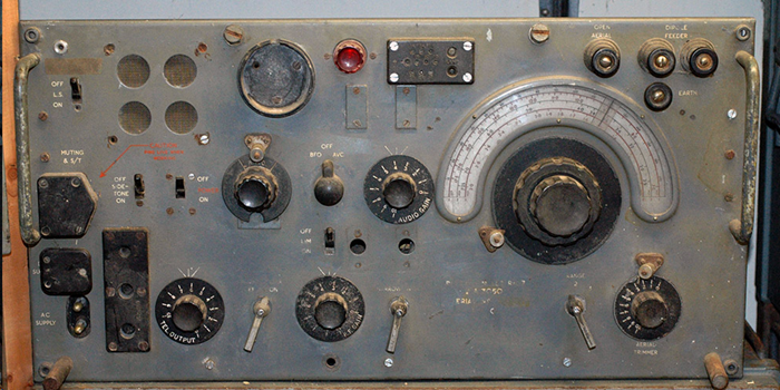

Ah - nostalgia :-) Back in the 60s, for years I used an R107 receiver, which had an inbuilt vibrator PSU for use off batteries. The 'muting & R/T" plug on the left, did the switching by connecting an HT supply (via a relay) to 'earth'. If, as often was the case, the plug was not present, one could get a nasty shock by touching the exposed pins (and if enough current flowed through one's body, it would do the R/T switching!) ...

Yes - it was in a tin can with 4 pins and plugged into a socket inside the unit IIRC.
We had 2 R107's, I spent hours listening to radio amateurs and chatting on the CCF radio network (5330Khz generally, otherwise 4972.5KHz - funny the things that stick in your mind) using the 19 set (and a linear amp to boot the power) or a 62 set. I had my own callsign - 27C I think. A friend over at Kingston GS was 27D
