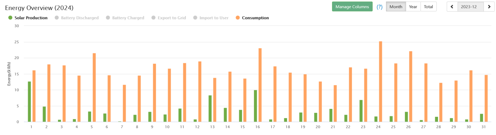

But at just 3.2 kWh they will not allow 24/7 running off the solar supply, specially in winter, this shows
how in December no day did solar production equal or exceed our use, since December we have had a smart meter installed and off peak supply, so we can charge the battery with off peak but typically use around 10 to16 kWh per day, so when solar is low, the more that uses the off peak supply direct, the better.

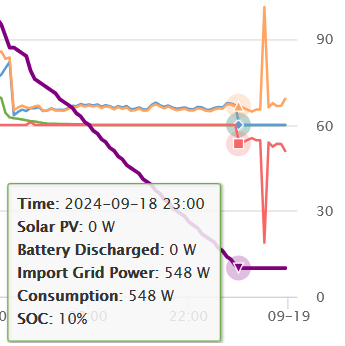

Considering second battery, typical run out of power around 11 pm 1726743344914.png can be as early as 4 pm in winter, or still have 15% left in height of summer, but from end of solar to running out around 5 hours, second battery would double this, maybe more as stop at 10% to leave some for UPS, could drop to 5% with second battery.
But the main thing, it would not matter so much if appliances used at the wrong times. I have suggested to wife cooked meal at midday instead of evening, but it falls on deaf ears. And today only 800 watt, so may not charge battery anyway, so it is the off peak which makes the system work as a whole.
