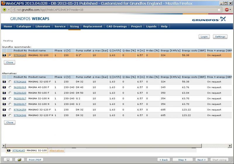

Grundfos Webcaps seems to have moods
Must do it suggested a magma 25/80 for me
Unless we are entering different data of course
I used 1.633 for flow rate and 6.57 for headloss
I also played around with the other variables and it still suggested a 25/80

Am I right in saying a Grundfos 25-80 would suffice, as a single pump for the whole system ? Looking at the pdf, it seems it would be ok (and definitely be a cheaper solution).
It would do the job, but a Magna 25-80 would be a better solution because it is a variable speed pump and would automatically adjust to the varying load as rads and zones open or close.

I used 1.633 for flow rate and 6.57 for headloss. I also played around with the other variables and it still suggested a 25/80
Just done it again! If Grundfos can't provide consistent results, what chance has the poor plumber!
Was that using the same figures?
Try using the same figures but pick canned rotor / union / in the more option
I also used max temp 80 degrees working temp 75 and min temp 30
I will have another look when I get in as on mobile at mo
Ah! you were using the 'overview' option. I unticked that and went through all 9 stages.
If I used the overview with your suggested changes it still came up with the Magna 1 32/100 as first choice; the Magna 25/80 was third.

mmm yes I am using overview but it still gives me a magna 25-80
I don't know if the above link will work for you but I am using
flow 1.633
head 6.57
min temp 30
working temp 70
max temp 82
working pressure 1.5
I am using canned rotor only
material cast iron
thread= 1in
