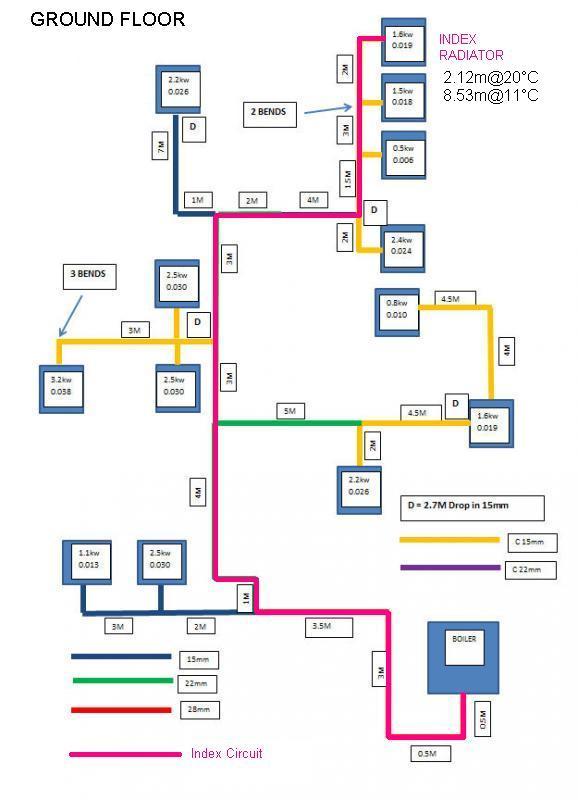

I'm not sure where to go from here. D_Hailsham is being kind enough to look at my circuit pictures and hopefully work out the head required / pump required. A lot of information to assimilate from this thread, but Im thinking solution will either be:
1) Fit a single pump to the entire system, probably a light commercial. Cost ~ £400 including labour. Not convinced this will solve all of my problems. I.e. will i be able to range rate my boiler to max output (38KW) to accomodate all zones open in winter, but not get S53's with a single zone open in summer ?
2) Fit a LLH. I dont completely understand how this works, but it looks like a magic solution to eliminate the S53 problem, whilst providing adequate flow to all zones, as and when they require it. Cost ? Can anybody give an approximate ?

Here are the results of the Index Calculation.
I have assumed: flow = 75°C; return = 55°C. (20°C differential)
The index rad is on the ground floor, but not the one suggested by the OP. It is the top right corner. The loss is 2.12m. The worst rad on the first floor is only 1.09m.
If an 11C differential is used (75°C/64°C), the head losses are 8.53m (gnd) and 3.74m (1st). The high losses are due to incorrect pipe sizes for an 11°C differential so you get a max velocity of over 2m/sec in the pipe from pump to boiler.
The losses above do not include the loss through the motorized valve (0.4m) or the heat exchanger (4.05m). If these are taken into account the total loss is 6.57m.
The flow rate for 38kW at 20°C differential is 1.633M³/hr.
The Grundfos recommended pump is the Magna 25/100 @ £1200
The total loss is 6.57m.

Full marks for taking the time to work the head loss out Dave, but I would have Thought the Magna 25/80

Thanks very much for taking the time to do this.
A couple of points which are interesting:
This would mean the first floor rad requires 5.54m head. Looking at:
http://www.anchorpumps.com/media/downloads/75/Grundfos Light Commercial Circulators.pdf
It doesnt look like the 25-55 provides more than 4.25m head at 1.6m^3/s. So the u/s definitely requires either a bigger pump, or a secondary pump. One thing I would say is that my pump is a Grundfos 26-50, which doesnt look to be identical to the 25-55. I'll try and post a picture of the front, as I believe it may be more powerful than the 25-55.

At 26KW, flow rate is 1114 l/h, and the boiler head resistance is under 2m. This means total head loss is just under 4.5m, at which the 25-55 would be sufficient.
I did attempt to do the head loss calculation for upstairs, and have come up with a figure of 0.8m for the index circuit upstairs. This was using a 20 degree temperature differential. Based on this, it would seem my single pump is sufficient for anything less than 30kw output on the 438 (factoring in head loss at the boiler).
So my u/s calc wasnt that far wrong (!)
Correction, after thinking this through more clearly. At 26KW, the u/s circuit has a resistance of less than 4m, which means the S53 is not a flow problem. Someone correct me if Ive missed something ?
