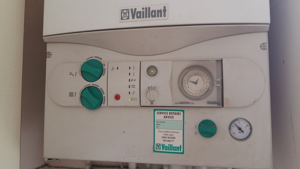

The attached picture is my boiler in its current state. Hot water works fine but we have no heating and the boiler is so old/ doesn't have a model number that I can't find how to fix it. There's no digital display. Please help ^_^
Turn the dial in the middle to the clock symbol.
The clock on the right has tappets on the outside. These are the on and offs. Can't remember whether out is on and in is off.... But one way or other you should be gravy.
If not post back.
Vaillant Turbomax is the boiler BTW.
Hi Dan thanks for your speedy reply!
Yes ive set the tappets. The boiler is on constant at the moment and still no heating :/
Does it fire up to a demand for heating? Have you got a room thermostat that needs turning up?
