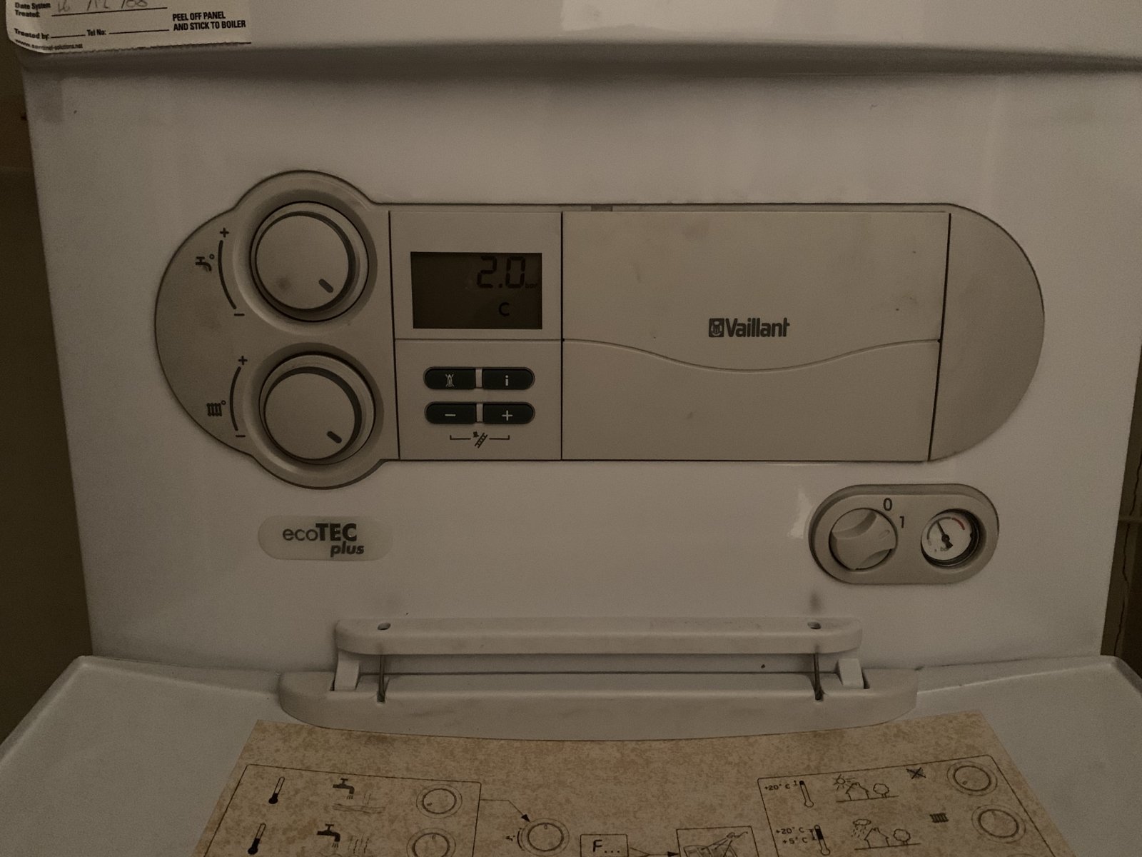

my boiler is showing as S.30 code. I have tried new batteries in my thermostat, I’ve tried taking it from it’s usual place and pairing it next to the boiler, I’ve tried turning the boiler off completely and I’ve also tried turning the receiver off but no luck so far!!! I have hot water and when I put my boiler into service mode the rads do heat up for about 10 mins. Does anyone have any other ideas I can try before I call a plumber in? My house is bloody freezing!!

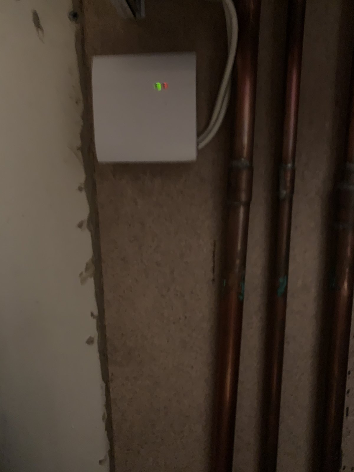

which salus do you have ? and post a pic of the receiver and the control panel on your boiler
@ianmcd What is a Timeswitch sorry? I have a Salus RT500RF. I’ve attached a photo of the receive and boiler below. @The Novice if I’m honest, I think I just replaced it with Ikea batteries - could that be why?

There are two lights on the receiver. Red and Green
The Red light shows that there is power present, and the Green light shows that the heating is (or should be) 'on'. [It looks to be on in your photo]
If you turn the thermostat up and down past the current room temperature, does the green light go 'on' and 'off' accordingly? Wait a few minutes each time, because the thermostat and receiver don't communicate with each other continually. If the green light does go 'on' and 'off' the thermostat is OK, but there is a problem with the receiver or boiler.
Only if the light does go 'on' and 'off' as dictated by the thermostat, and if you are capable of making a test safely you could try this. Isolate the power, access the wiring at the back of the receiver and you should see two terminals marked COM & NO. Note where the wires are connected so that you can put them back afterwards and then without disturbing the existing wires, either insert a wire to link the two terminals together, or put the wire(s) from NO into the COM terminal with the other wire(s) already there. Restore power and if the boiler works now, the receiver is faulty. if it doesn't there is a problem with the boiler, or its wiring. Don't do this test if you are not competent, or have any doubts. Any questions post back.
If the green light doesn't work as described the thermostat or receiver are at fault.
@stem Hey, thanks for explaining that! Ok so I’ve just had a look and if I turn the thermostat up or down the green light doesn’t go off it just continuously stays green. Shall I still look at the wires or you do you think it is definitely a fault with the thermostat/ receiver?
