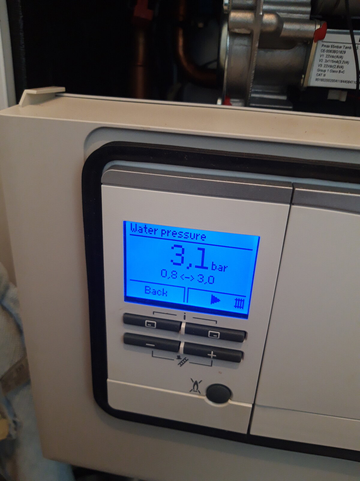

Hi. My Vaillant boiler will only run on high pressure above 2.7bar. Anything below that and the dreaded F75 low pressure warning comes up and I have to put more water in till it gets to 2.8.
The sensor has been changed at least 3 times on this 6 year old boiler. It runs an underfloor heating system and the only metal parts are the boiler itself and 3 circulation pumps. Was power flushed in 2021.
Any thoughts please?

What does the pressure rise to with a hot system?, the boiler PRV lifts at 3.0bar.

When the boiler is running normally and if you very slowly bleed off some water from a rad or where ever to reduce the pressure, does F75 annunciate?.

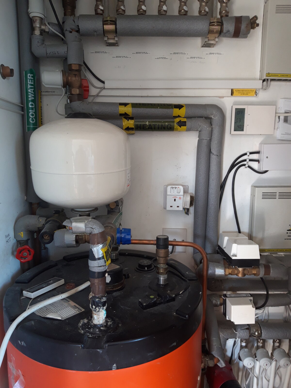

There will be 2 E.vessels if your HW cylinder is unvented, (except it contains a air bubble), this is normally white, there will be another one in the boiler which is probably red but these serve 2 different purposes, the white one is to aborb the volume rise when the HW cylinder is reheated and the other one is to take the expansion when the boiler/system volume expands.

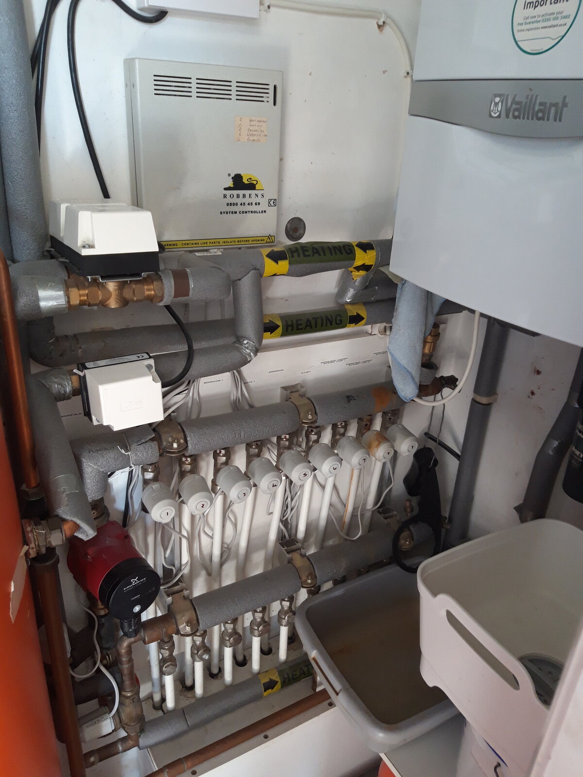

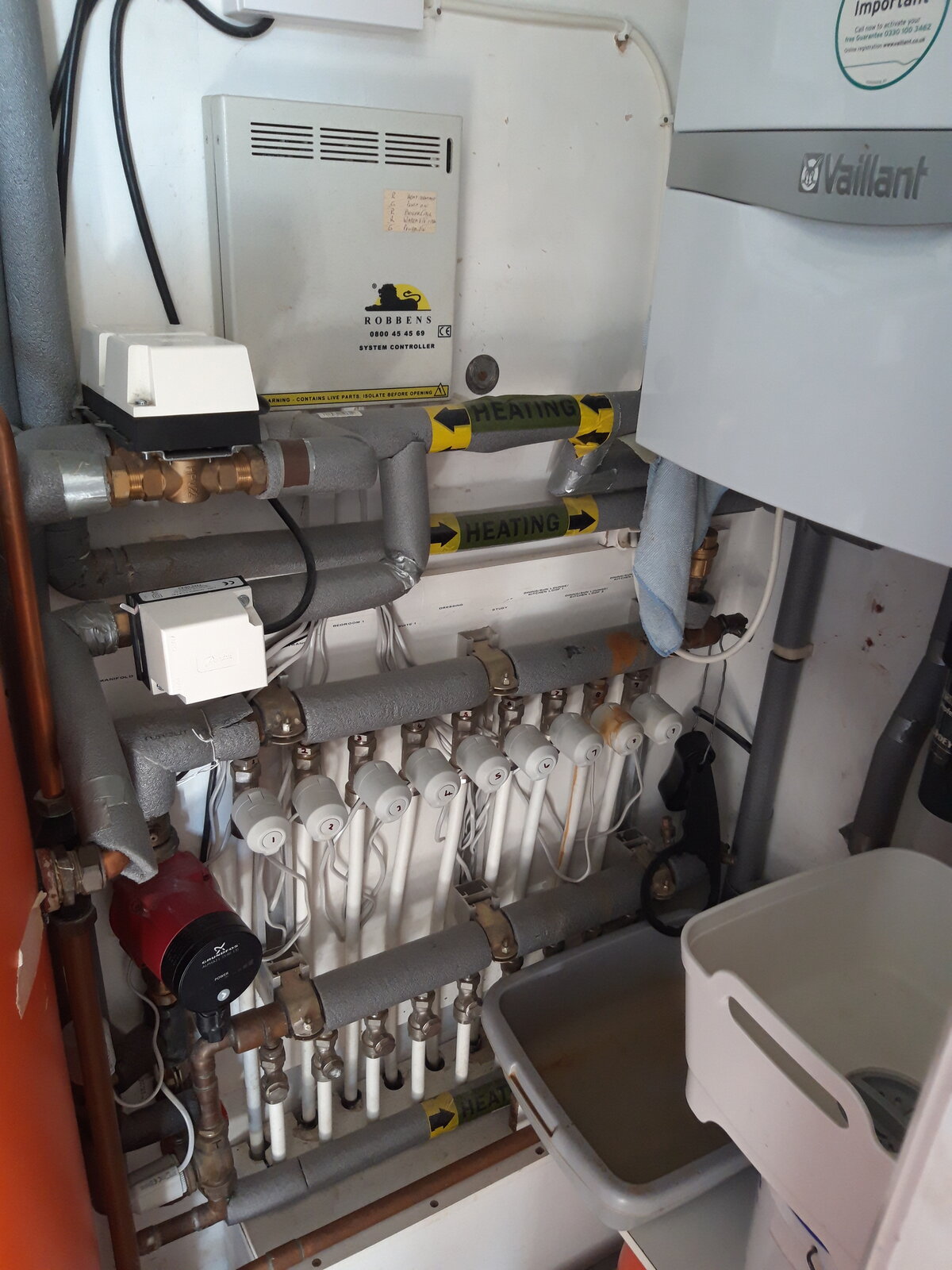

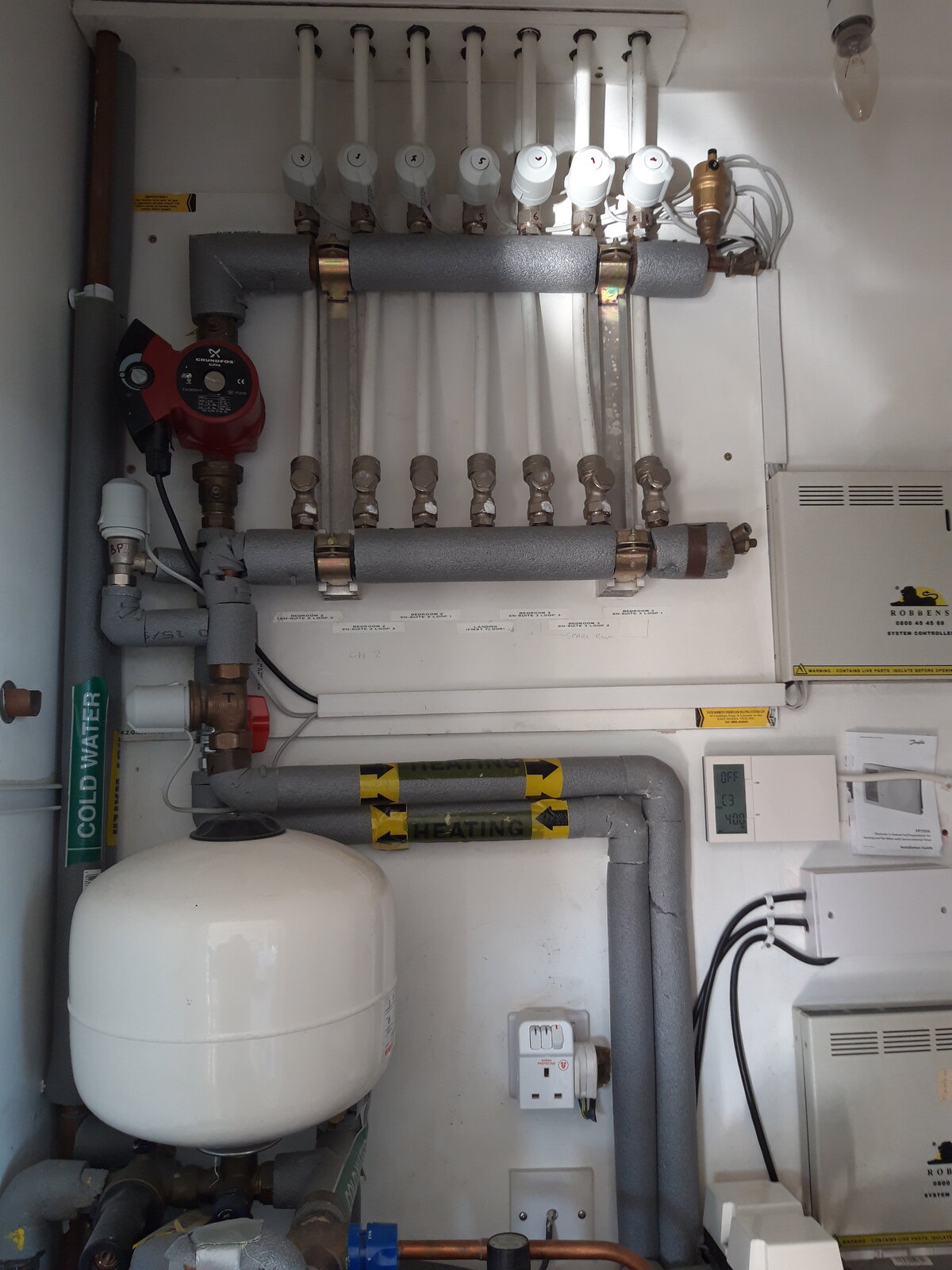

You might post a photo of the UFH manifold and pump(s) etc, any rads on the system?.

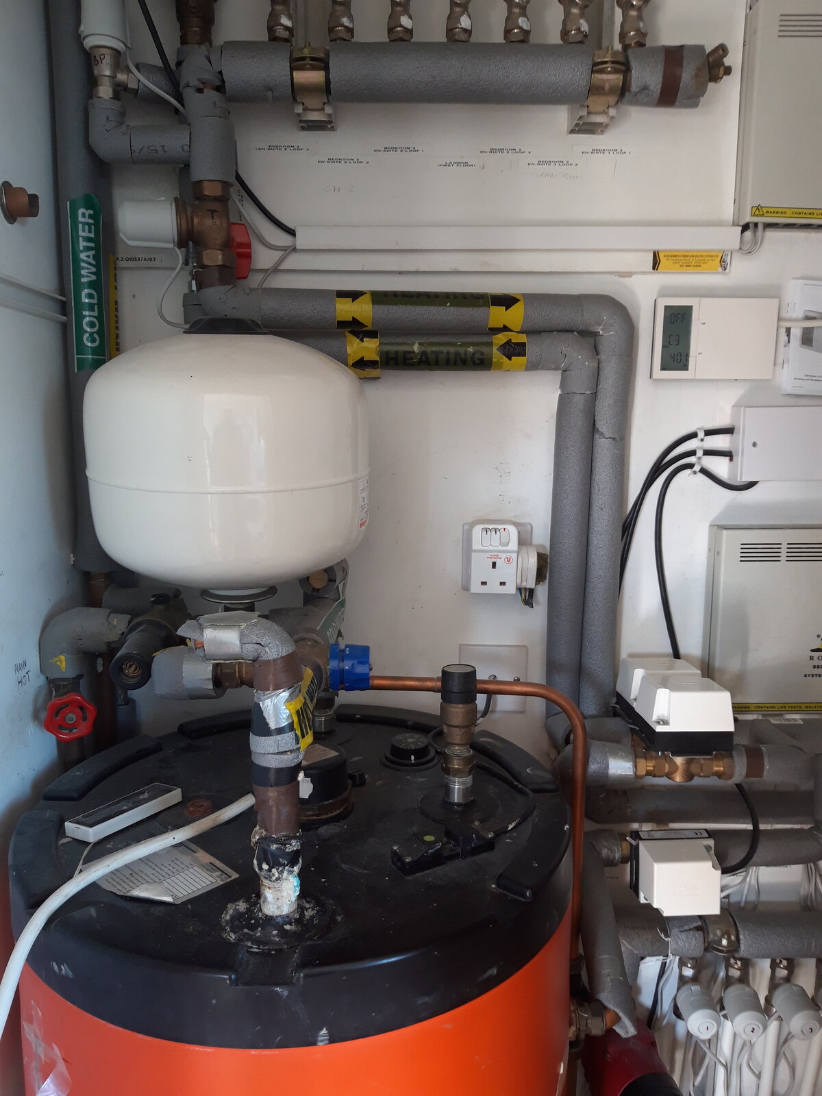

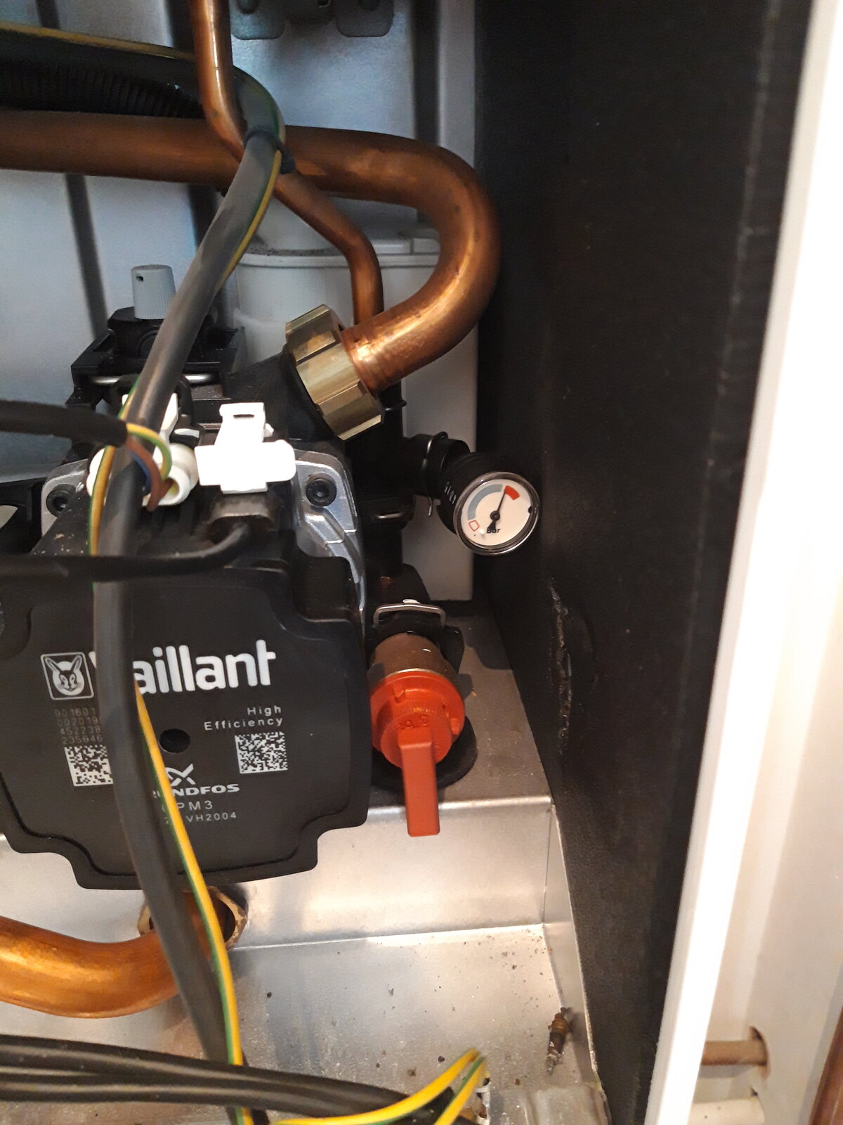

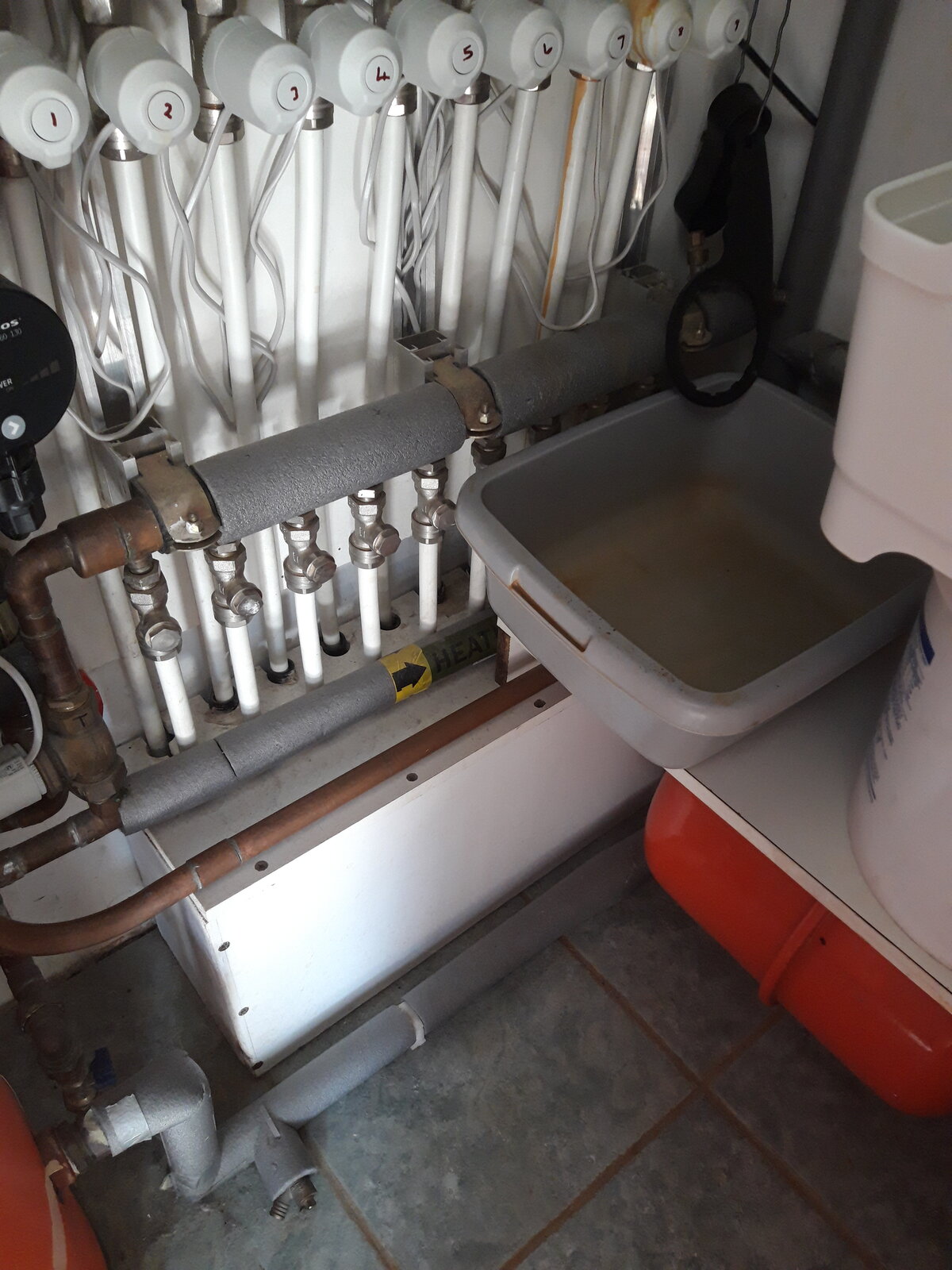

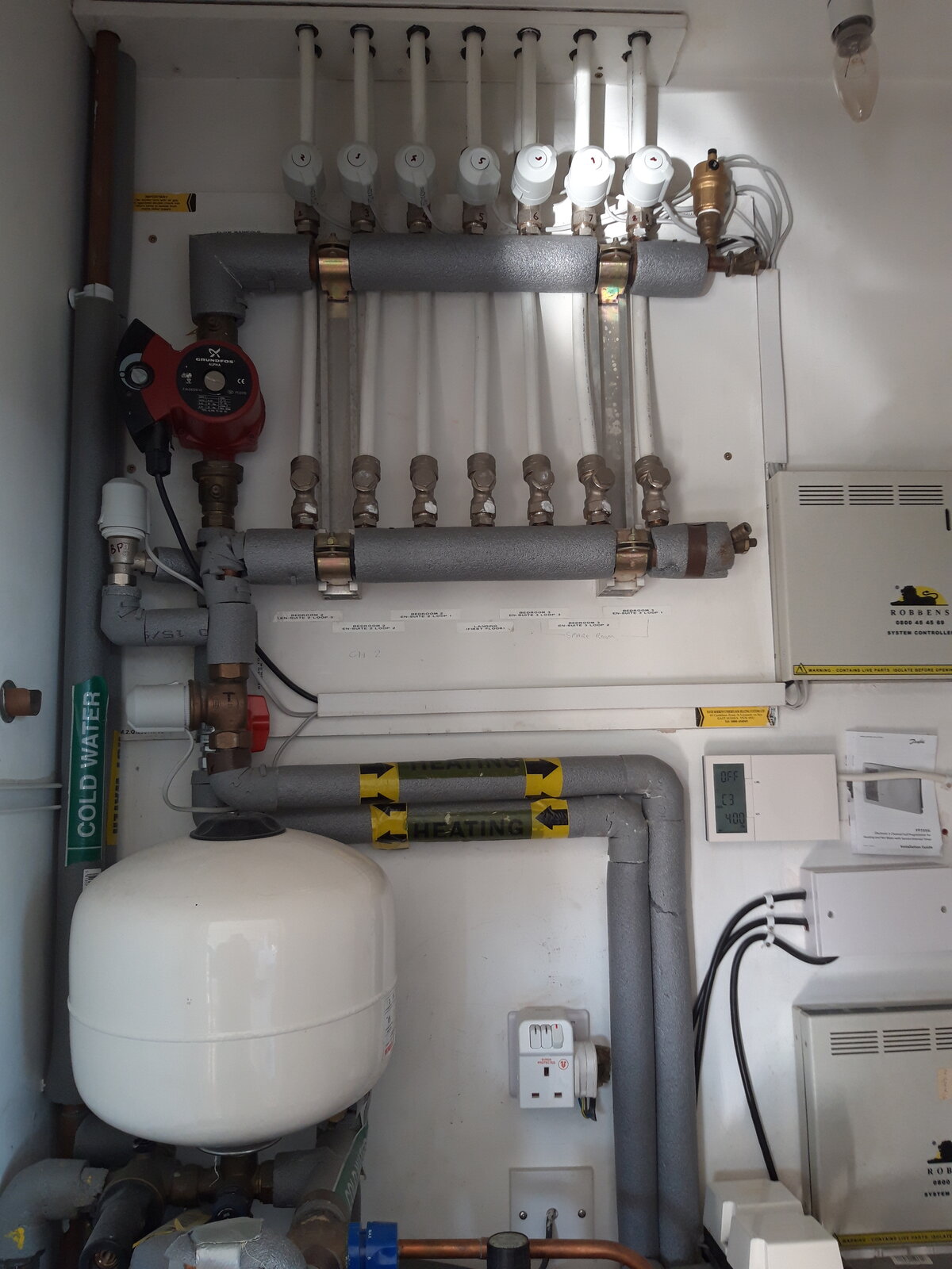

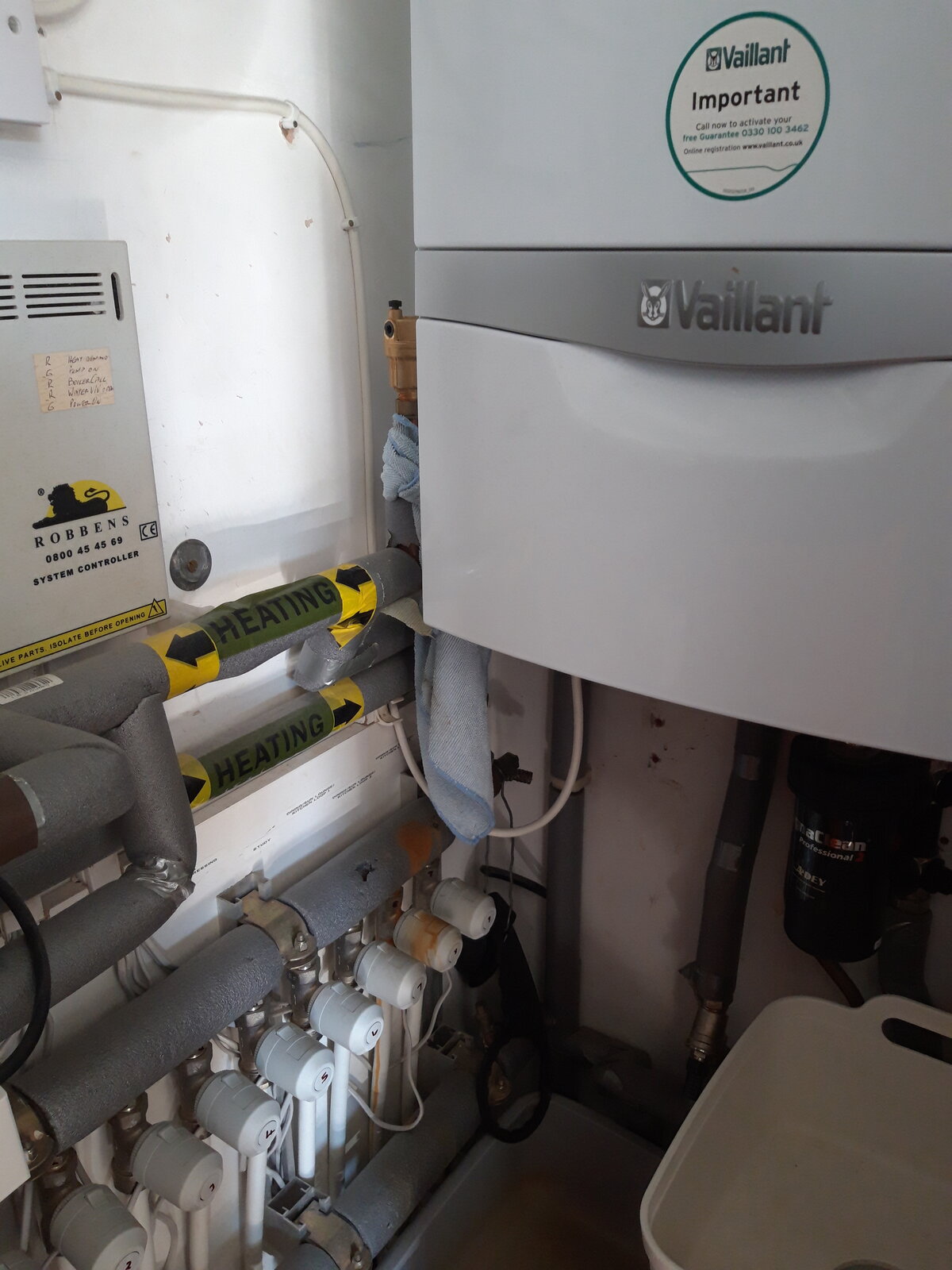

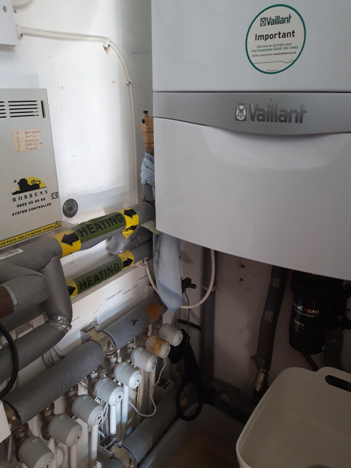

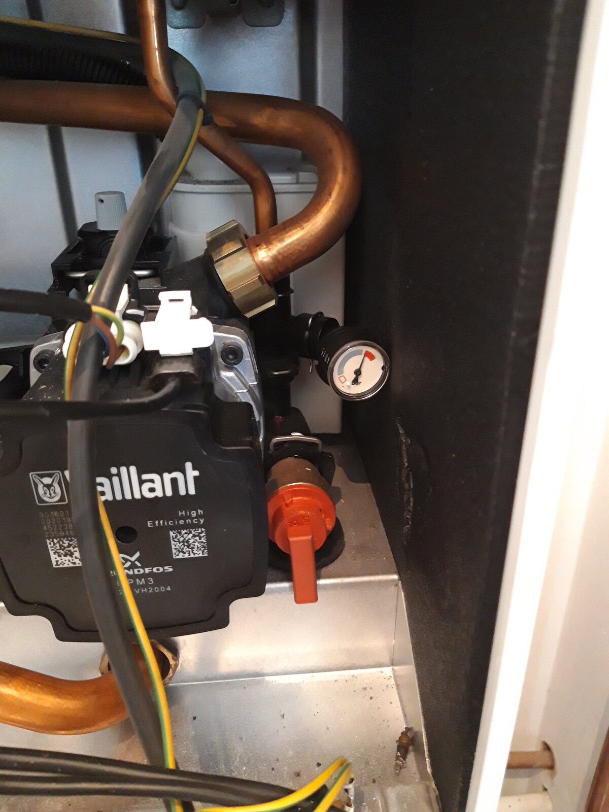

Here are some photos as requested. No rads at all, UFH in polypipe throughout.
3 pressure sensors over a 6 year period. Always the same fault.
Is that the pressure sensor in the photo with a pressure gauge on the end?.

The first photo shows a E.vessel on the right, can you see where this is teed into the system?.
Can you also show the UFH manifold pump?
No, the pessure gauge shown is not near the pressure sensor, which when they changed them before, I think were to the left side. The HWF pump seems to be inside, next to the gauge just mentioned.
I would need to dismantle the shelf above the E.vessel to get a photo.
In your second pic it looks like the auto air vent has been leaking, has this been repaired ?
