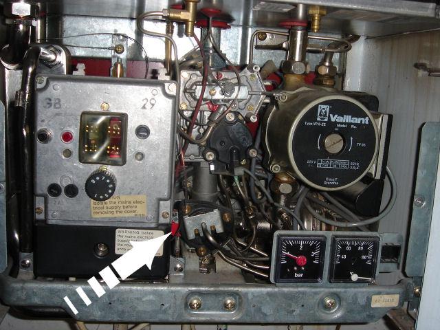

I have a valiant Combi Boiler, which is brilliant... has never let us down.
We have a little issue in that when we run the hot water, when the tap is turned off the boiler will still run, and if the CH is on, then that will not be supplied. I have found that there is a spring which doesn't quite go all the way down on its own, and as such we have to press the spring down.
I have borrowed a picture of the boiler, and the part is just to the right of the arrow. Does anyone know what this part is called and is it serviceable/repairable please?

yes it is serviceable /repairable but I doubt by your goodself, fantastic old boilers but you need someone who knows how to repair this and its not the spring, there are a few valliant gurus on here and they might be able to recommend someone in your area

If I understand your post correctly the spindle win be sticking and not retracting
Thats great news Phill... that sounds like the issue... essentially - I turn the hot water on, boiler fires up... turn the hot water tap off, boiler keeps running. I physically have to push the lever attached to the spring down to turn the boiler off. Is there anyone in the Staffordshire area that comes recommended? Im assuming its not a diy job.

Cracking boiler, well worth repairing. One of the best. Quality started slipping after this model me thinks
It is usually the gland leaking on top of the water section, corroding the coupling piston, which jams in the 'on' position with the servo valve pushed up. The spring is then not strong enough to return the servo cam and the piston. Annoyingly it can also just be a sticky servo valve. It needs an expert eye to diagnose, takes seconds.
In extreme cases where the gland has leaked for a while, a new water section is required.
