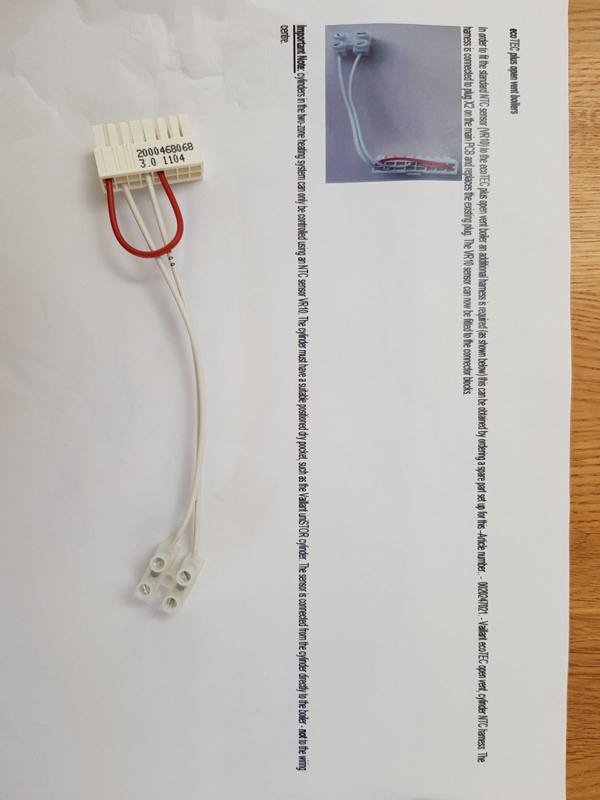

There is a plug available for the 400 series ecotecs to allow the ntc to be connected directly to the boiler pcb, do a search for mrv as he has posted about this issue.
I don't understand relevance to the issue...

Thanks, but I still don't understand the relevance to my HW issue.
I already have an out door wireless temperature sensor (VR21), that feeds data to the system so it can select its proper central heating curve. The cylinder has a VR10 NTC temperature sensor in the cylinder, for controlling the HW temperature. Both are feeding proper data to the VRC470F wireless display/ control. The VR10 NTC was included with the VR65 kit.
The boiler does have a socket for a wired NTC outdoor temperature sensor, but that is already provided to it wirelessly by a VR21.
The VRC470F is also wireless, linking to a plug in to the boiler unit, which is part of the the 470F kit.
