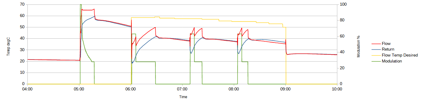

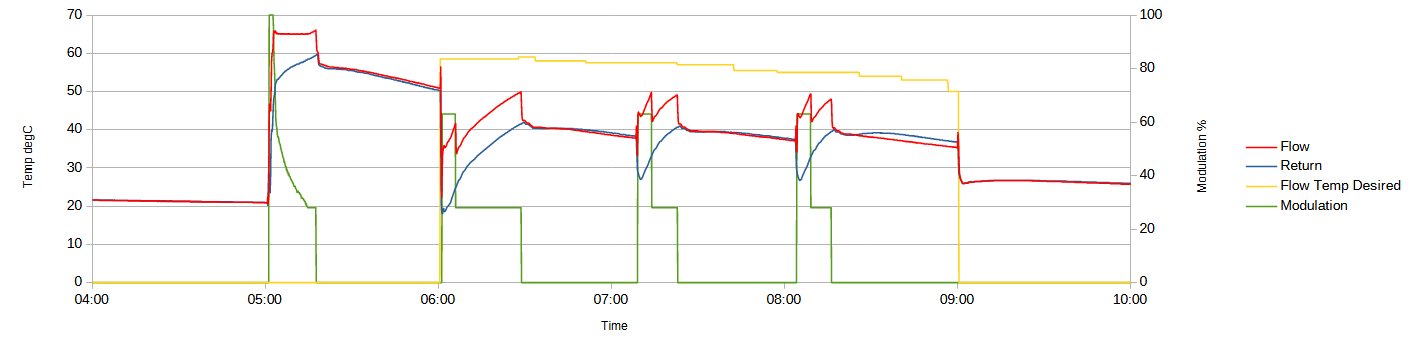

I have a Vaillant ecoTEC plus 418 on a vented system with twin 2-port valves, ABV, VRC 470f, VR65 and outdoor temperature sensor.
The CH Part Load is set to 5kW. HW is timed to come on at 5am and CH at 6am.

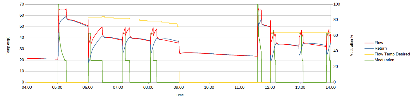

HW is working as I expected but CH cuts off when the flow temp reaches 50C, well below the target set by the controller:
Any suggestions why this is happening please?
Mike

Can you actually see the target temperature set by the outside temperature, if, for example the OT has set the target temperature to 45C then the minimum boiler output may be greater than the CH demand, in which case the the burner will trip and the boiler recycle when the actual boiler temp is 5C > than the target temperature, in your case this would mean that the OT control has set the target temp to 45C, can you post the heating curves.
You can see the modulation going to a steady 30% at a boiler temp of ~ 35C at around 0610 but the boiler flow temp keeps rising yntil cut out at 50C??.
The target temperature is shown in the graph above as Flow Temp Desired, which I presume is derived from the heat curve according to the OT.

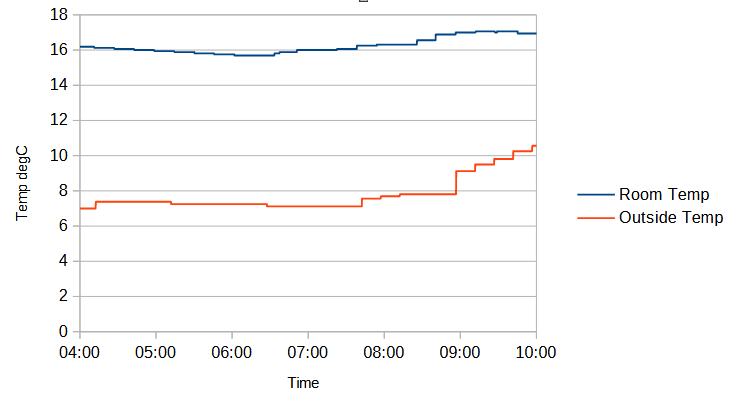

Here are the Outside and Room temperatures for the same period. The target Room temperature is 18C:

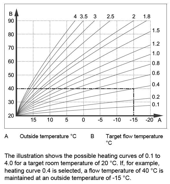

The heat curve is currently 2.5:

You were looking for ~ 58C boiler target temp but only achieving 50C, the 30% modulation is close to your range rating of 5kw (18x30%) so possiblt the boiler just can't achieve 58C, its possible that the boiler logic sees this as a problem and trips the burner??, so maybe increase the range rating (d.00) to 10kw or let it off on Auto even temporarily and see what happens.

I set d.00 to 12kW and on the next CH cycle at 1200 hrs it reached the (albeit lower) desired temperature. I shall have to wait until the morning to see if there is something else stopping the CH flow temperature from going over 50C. I have a long (60 minute) anticycle time to prevent short cycling which is not ideal but I can't get it to run continuously on a low burn. Also, it's set to Return regulation because otherwise it microfires continuously.

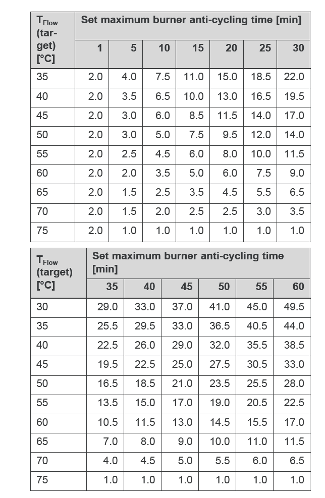

The anti cycle time of 60 mins, ~ 16 minutes at 58C target flow, seems a bit more than adequate as it increases with reducing target temperature.

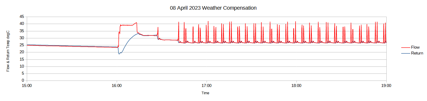

Here's what it did with Flow regulation, which is what I understand to be microfiring:

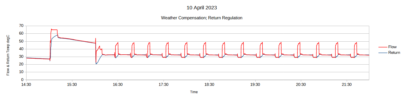

And this is Return regulation but with an anticycling time of 20 minutes (default):
