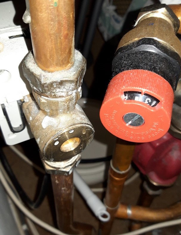

I should say that 3 radiators are usually off unless we have people staying. I tried the pump on setting 3 but it didn't seem to change anything. Should I adjust the ABV?
Mike
Yes, might tell something, reduce index until it just starts to get hot.
What make ABV?
It's a Honeywell.

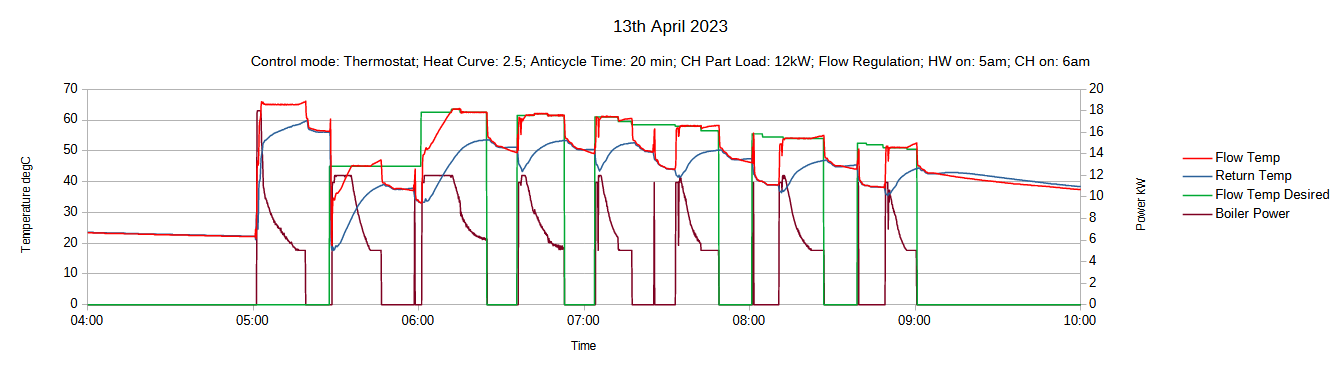

Well it turns out that I was on a wild goose chase with this. I was about to test the pump as you suggested when I noticed that the CH zone valve was stuck half open; the return spring in the actuator was broken. I replaced the actuator, set the boiler back to Flow regulation and the Anticycle time to the default of 20 minutes and now the Desired Flow Temperature is being attained and there were only a few instances of microfiring.

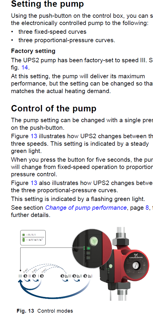

Thought I'd come back to this forum as this is where it originated. I don't know of any model of UPS2 that doesn't have proportional pressure (PP) mode, its pretty useless any way as far too low but could account for those low readings, You should get 22 watts reading on your setting of speed 2 even with the pump discharge valve closed, it is strange that the EM reads OK on other items but not apparently on your pump. I have used my monitor on numerous Grundfos pumps and all read exactly as per pump curves.
Thank you for explaining that. When I get home later I will try to measure the pump power again. I know the meter is OK because it measured down to 1Watt on another device.
Mike
OK after a couple of days away I started again with a clear head and this time got sensible results.
I switched off the boiler, connected the pump to a separate supply and operated the zone valves manually. The results were the same whether HW or CH was selected:
I - 29W
II - 43W
III - 56W
PPI - 9W
PPII - 10W
PPII - 11W

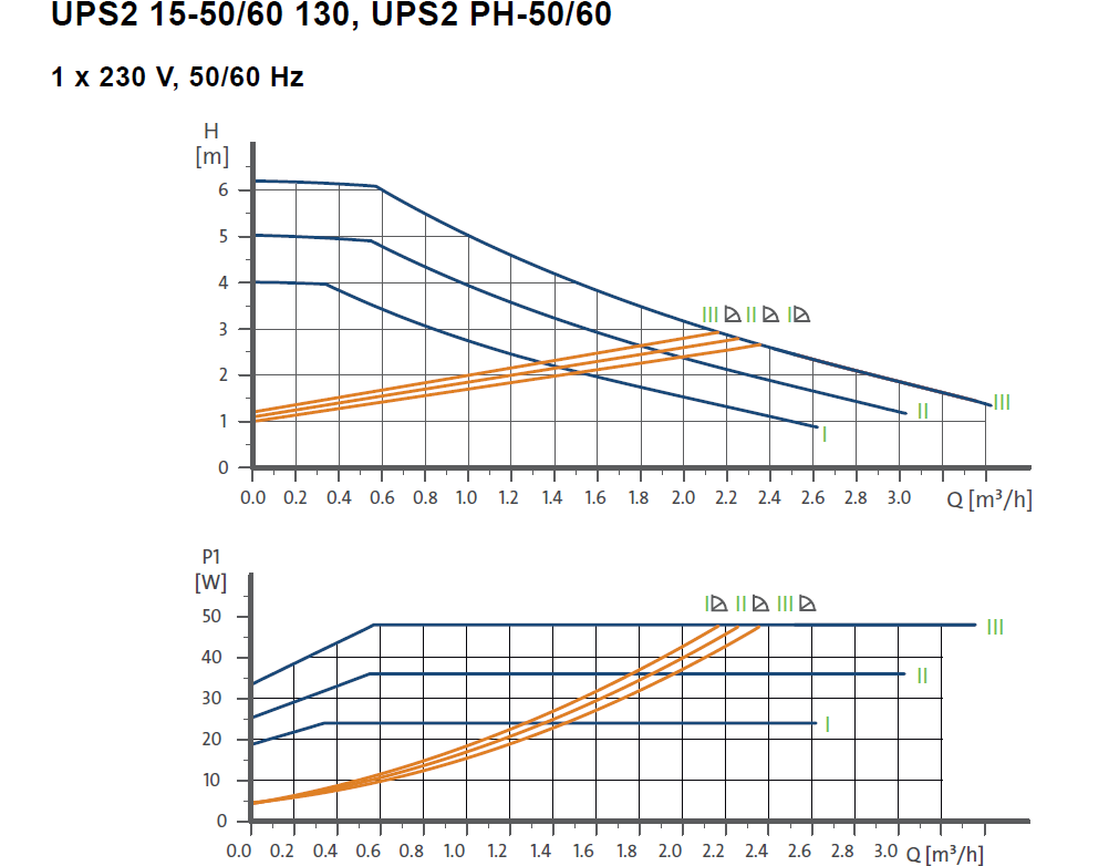

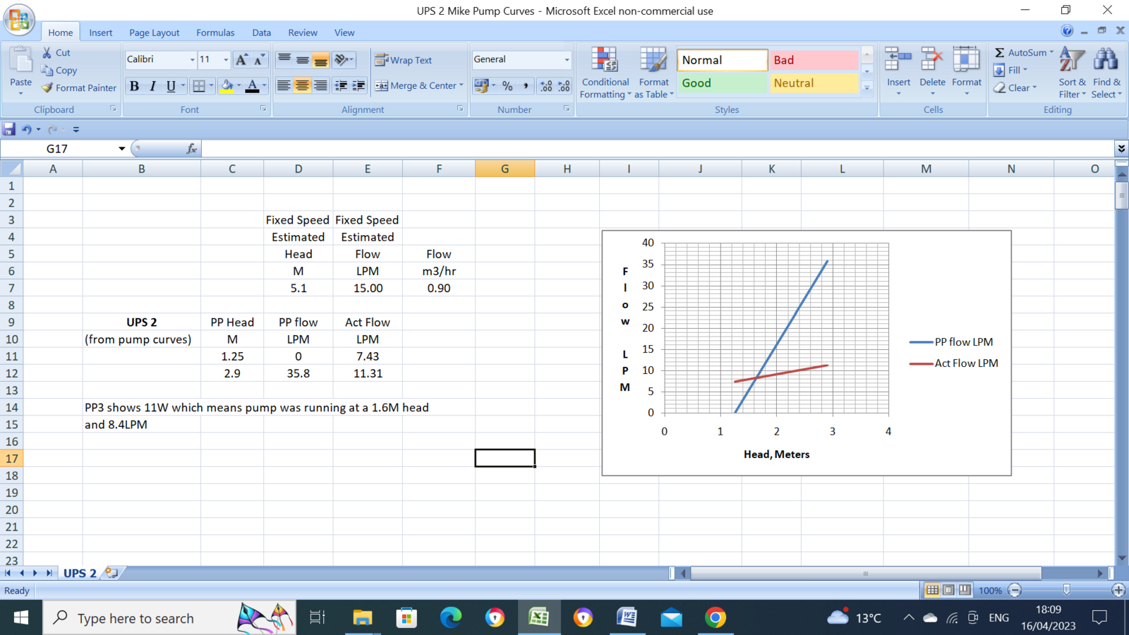

The PP curves seem pretty accurate but can't make sense of the speed curves as the max pump powers are 23W, 37W & 47W for speeds I,II&III and you are reading 29W, 43W & 56W.
So based on a PP3 setting and 11W equates to a head of 1.6M @ 8.4LPM (0.5m3/hr), this would equate to a 5.1M head @ 15.0LPM, (0.9m3/hr),in turn this maps fairly close to running at speed 3 but power would be 46W, so best guessestimate is that the pump on speed 2 is pumping ~ 13LPM to15LPM @ a 4.6M to 5.1M head.
Thanks for this, but not sure what to do with it!

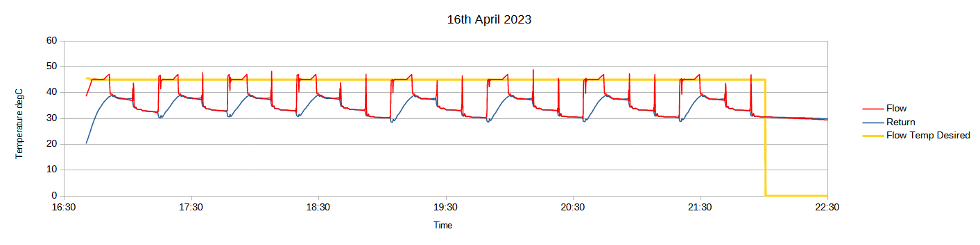

On the graph above (13th April) the OT was 6C and the heat curve was 2.5, giving a desired flow temp of around 60C. Under these conditions the desired flow temp dropped to zero periodically causing the burner to cut out.
This afternoon the OT was 15C and I'd lowered the heat curve to 1.5, giving a desired flow temp of around 30C. However, the minimum desired flow temp is set to 45C which overrides the heat curve, and in this case the desired flow temp didn't drop to zero but the burner still cuts out and the microfiring has returned:
BTW the controller is still in Thermostat mode.
