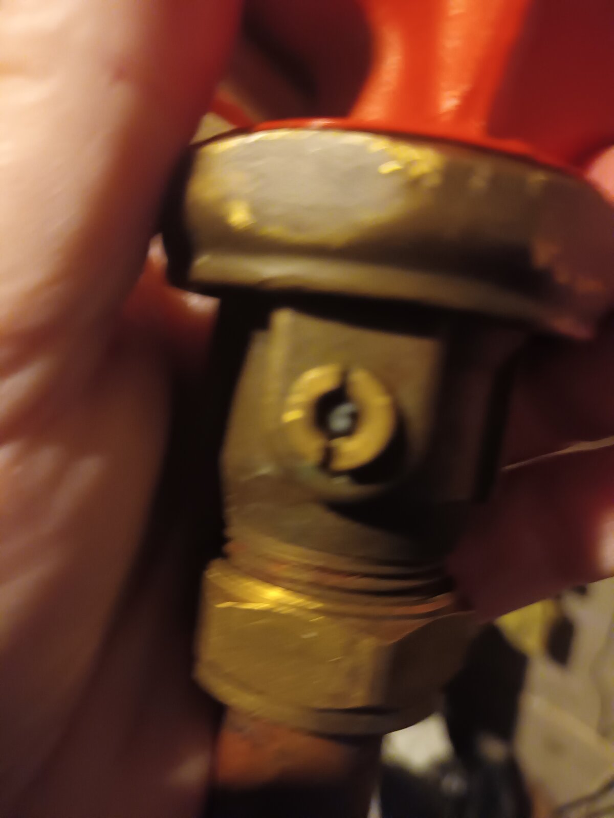

The discharge valve is the pump outlet gate valve, there is a arrow on the pump body to show the flow direction.
Flowtemp seemed to exceed target temp by 5C on a few occasions.
Mike,
Word of caution re shutting the pump isolating discharge valve, if its like the one shown, do NOT shut it as its more than likely that it will leak, if it has a spindle with a square on it where you can open/close it with a adjustable spanner or such, then OK.
But still run test with pump discharge valve opened but all zone valves shut, then on say speed 2 & 3 slowly increase the ABV index until the power decreases to its minimum, then increase it again until the power just starts rising, at least this might give some indication of what head the pump is actually running at.
Mike,
The gate valve has a square spindle. Is it really OK to run the pump with its output completely blocked?
Sadly I've run out of time to do this as we're going away shortly and the other jobs are piling up. I may just give up on weather compensation altogether and put the old (VRT 392f) controller back, at least until next winter.
Mike
Its no problem to run the pump (dead headed) with the discharge isol va;lve closed for at least 10 minutes, (very) eventually the pump just might heat up to seal damaging degrees but I would doubt that even. My Wilo will heat up by ~ 0.7C/minute when dead heading at 4.8M.

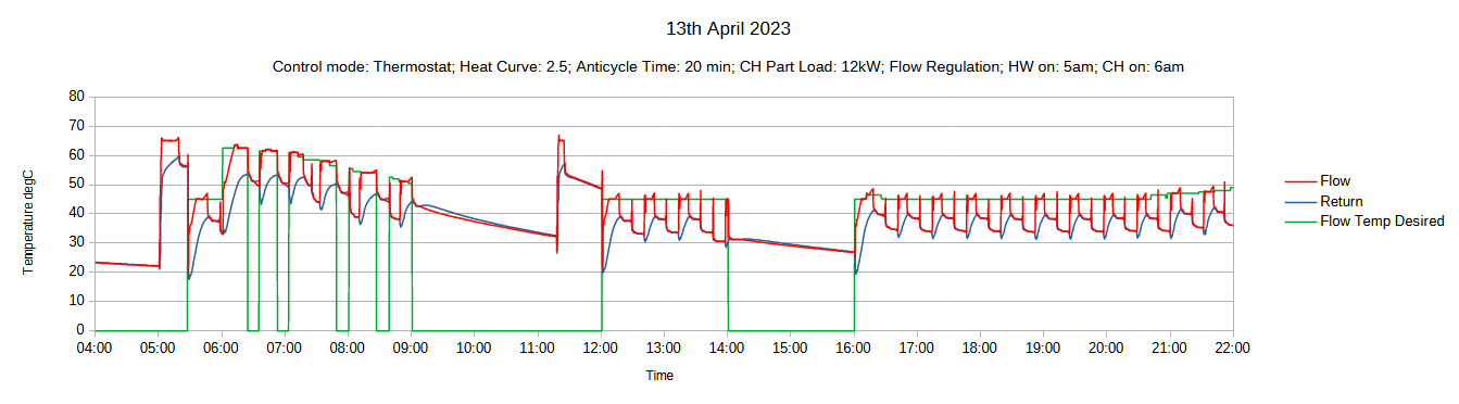

As I've decided to stop playing with this for a while I thought it would be a good time to summarise my experience with the Vaillant VRC 470f weather compensating controller. This graph best illustrates the problems I've been having:
My observations:
1) The HW cycle works just fine. The flow temperature reaches the set value of 65C and the boiler stays alight until the (wired) cylinder thermostat is satisfied.
2) The CH behaviour is bonkers. The heat curve I chose is typical for a 50 year old house in the UK. The resulting desired flow temperature in the morning started at 62C and dropped gradually, but for some reason it fell to zero several times and the burner cut off. In the afternoon the desired flow temperature was lower and did not fall to zero but the boiler still cut off anyway. There is also some microfiring.
3) I removed the wireless receiver from the boiler so there is no communication with the controller and set the flow temperature manually to 65C. Because the room thermostat bridge (pins 3 and 4) is closed the boiler ran continuously for several hours with an initial power of 12kW (the value of d.0) followed by 5kW (the boiler's minimum power). I think this proves that the boiler, pump and heating circuit are all working correctly.
My conclusion is that the VRC 470f wireless controller is not working as it should. I don't think it's a problem with communication because the signal strength is 7/10 and the manual states that anything above 3 is OK. Also the behaviour is too regular to be caused by an intermittent wireless connection.
I may send this to Vaillant tech support for their comments but doubt I'll get a sensible response.
I've now gone back to the previous Vaillant wireless controller to see if that is any better.
Mike

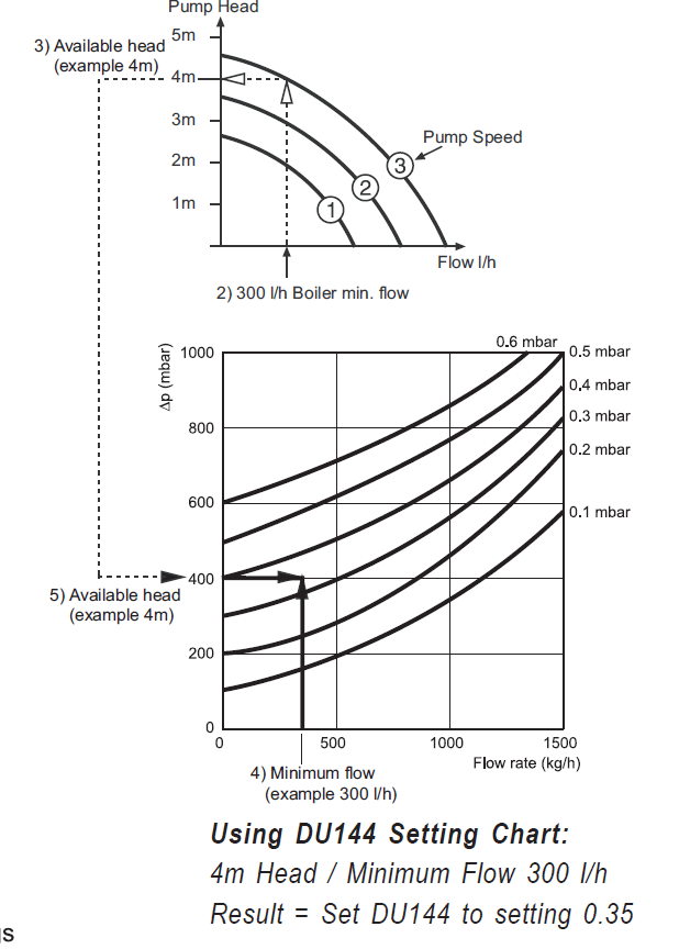

The flow rate of 9.2LPM is interesting in that its reasonably close to the pump flowrate of 8.4LPM based on the PP3 curve and 11W but then the fixed speed settings make absolutely no sense, if you change from fixed speed 2 to fixed speed 3 then the ABV, at 3.5M,should be red hot and passing quite a lot of water so don't really know where you go from here apart from as suggested reducing the target temp to give better boiler efficiency.
Example of typical ABV capacity below.

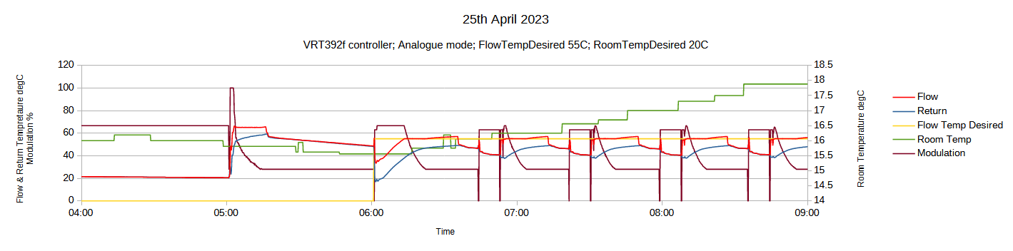

I replaced the VRC470f weather controller with the VRT392f room thermostat. Here it is running in Analogue mode:
You can see the Flow temperature starting to rise as soon as the Modulation drops to 28%, and when it exceeds FlowTempDesired by exactly 2 degrees the burner shuts down:
Any ideas what might cause this temperature rise? Incidentally exactly the same thing happens with the weather controller.
Mike
I have no idea but have read of other Vaillants doing the same thing, a dT of 2C is far too low.
OK thanks, not just me then. It doesn't look like a controller issue so maybe a new boiler control PCB might make a difference.
