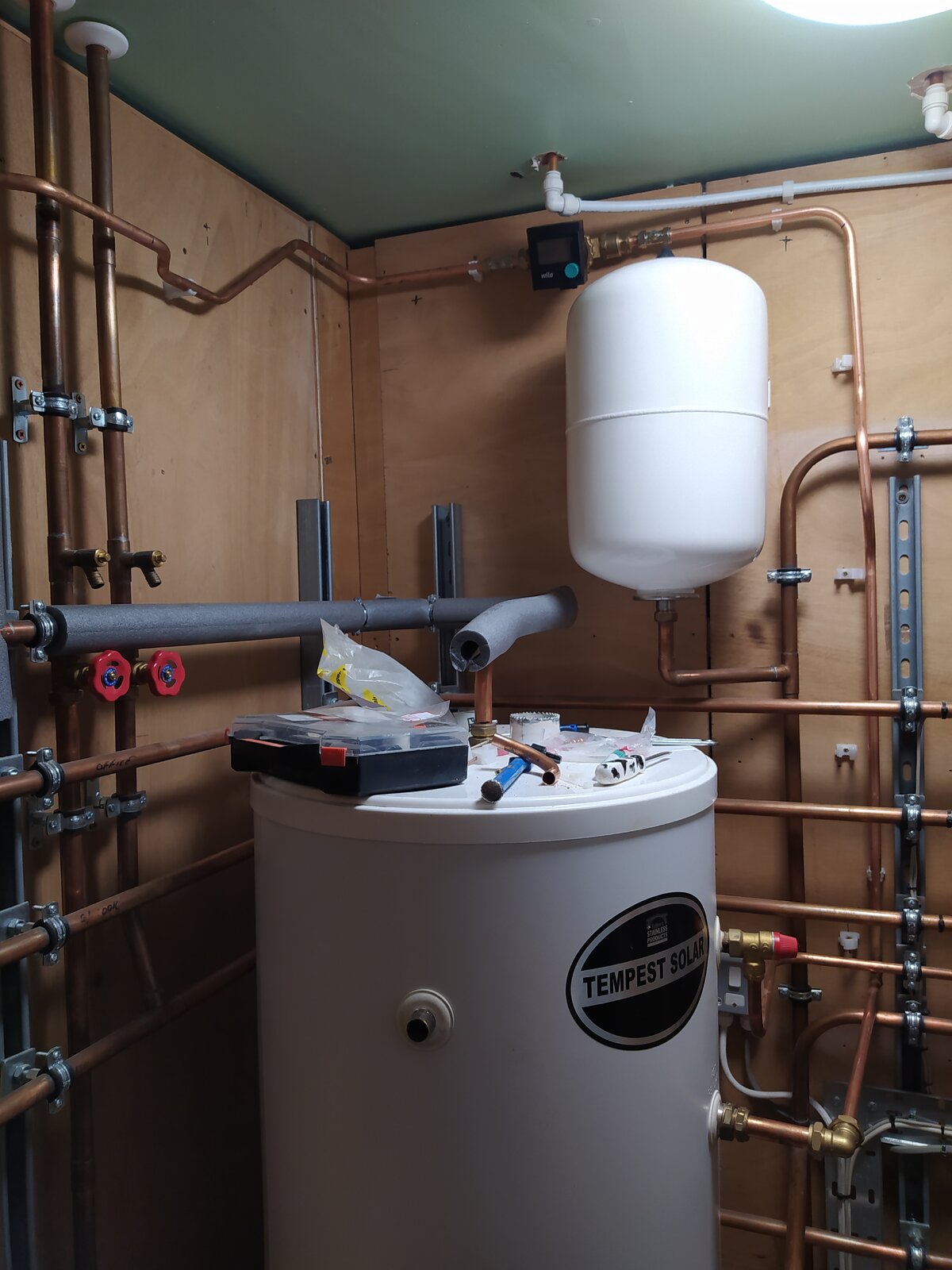

Well, sometimes if you want a job done properly, you have to get on and do it yourself. First time bending pipes and I thoroughly enjoyed it! Wilo bronze pump fitted (above expansion in pic) and pipe as close to furthest tap as possible, but still 7 meters away. Pipes all lagged now and works great - hot water time reduced from an unusable 40 secs to 6 secs!
