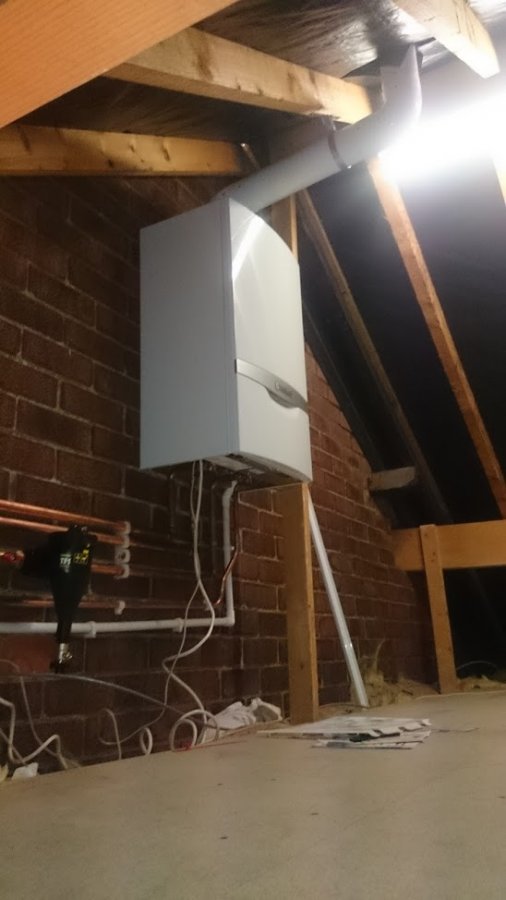

Having had some issues with the system with the above items and not being able to get it all working i spoke to a few chaps and called Vaillant technical to be told i could not do what i intended with the kit i bought and i actually need to buy other items, So my system is built up of the following:
ecoTEC Plus 624 - stored in my extension loft

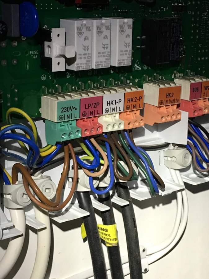

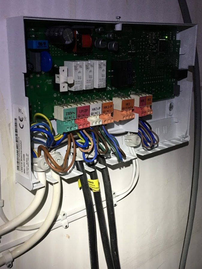

3 Honeywell zone valves all hard wired into my VR61 - i will take some pics of cabling later to see if anyone can help with that.
Howdy all,
here is my VR61 wiring.
LP/ZP = Cylinder Honeywell Zone Valve
HK1-P = Heating Zone 1 (Down S) Honeywell Zone Valve
HK2-P = Heating Zone 2 (Up S) Honeywell Zone Valve
Can anyone advise?
I'm doing this every day, but I would still need to be in front of the kit with testers and possibly my laptop connected to trouble shoot that...
Hi Bunny,
Thanks for your reply mate, i have just dropped you a PM.
can you point me any direction in terms of testing?
