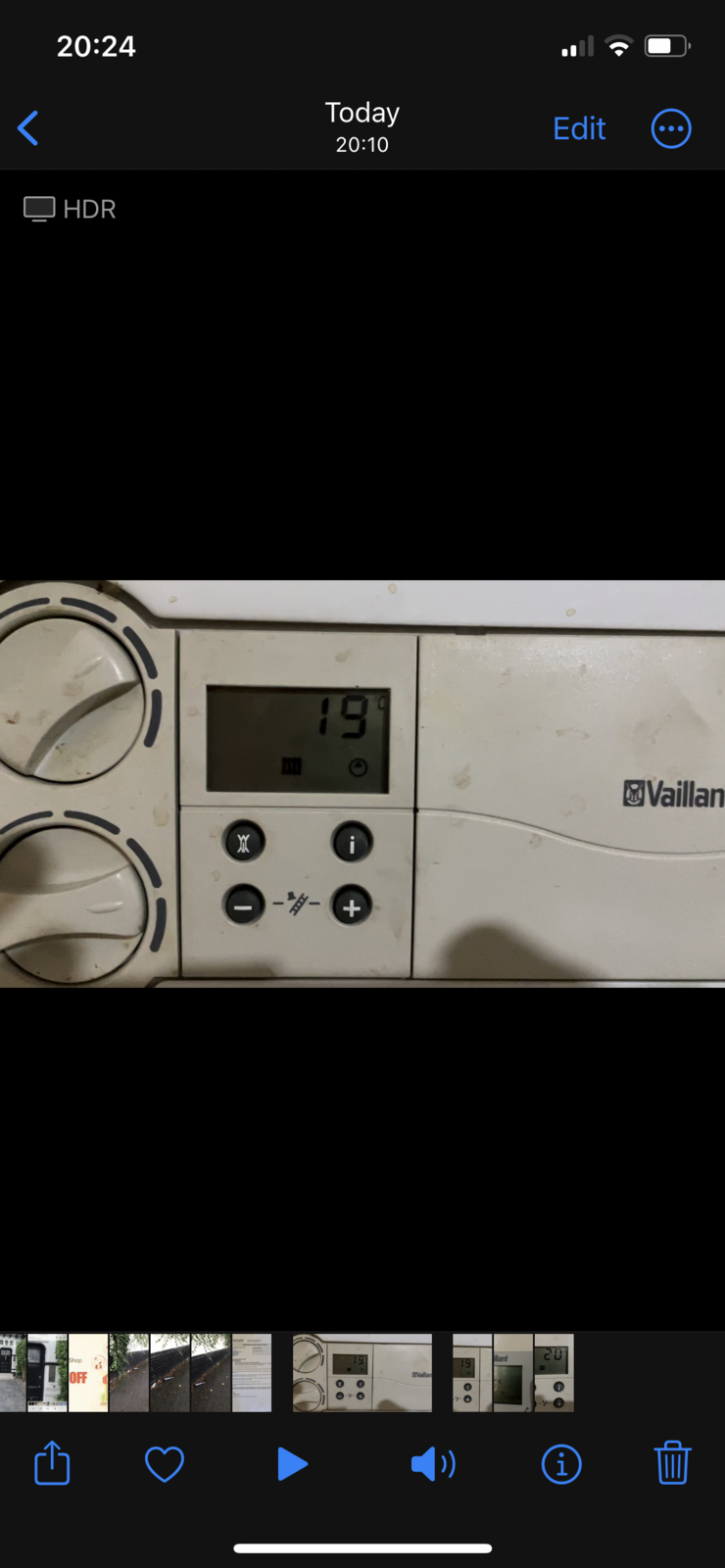

Vaillant Ecotec Plus 637 Pump over run problem- Please Help !!!!
Thats the boiler
Two things you need to do before we can diagnose this. When the pump is running (when you think it shouldn’t) press the i button and make a note of the code, press the i button again to get back to the main screen. Press the i and + together, the display should say d.0. Press the + button repeatedly to go to d.9, press i and make a note of the figure. Post back and we can go from there.
Hi, ok sure thing. I will run through that sequence once the pump comes on again. I do know that when it came on before without any demand the code was S7 which I believe is for pump overrun. I have not recorded the D9 value but will do this once it comes/plays up again. Many thanks
The temperature on the boiler display then dropped to 18 c and the pump over run stopped. The room stat is reading 19c and now so is the boiler
@The831Bunny
Just to give u an update. The pump has come on the S code is S7 and the D 9 value is 10?

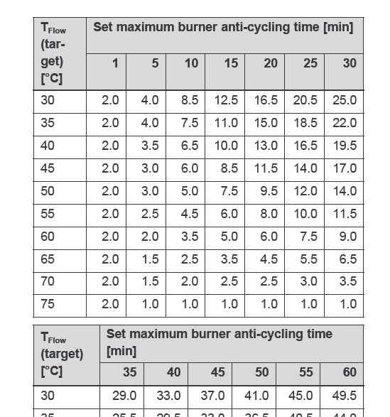

If everything was/is normal then the pump overrun time is, as set in d.001, 1 to 60 minutes, default time 5 minutes, easily checked out, you don't really know whats going on there especially since input d.009 is "wrong", at least you can check d.047 to see what actual outside temperature its reading.
Because of all this the boiler may be "firing" and then doing multiple anti cycles + pump overrun, whether its displaying a s7 or not.
the anti cycle time depends on its setting (default, 20 minutes, set in d.002) plus the boiler target temp, it only goes as low as 30C so don't know what it thinks if it sees a apparent target temp of 10C, a 30C target temp + 20 min setting gives a actual anti cycle time of 16.5 minutes.
