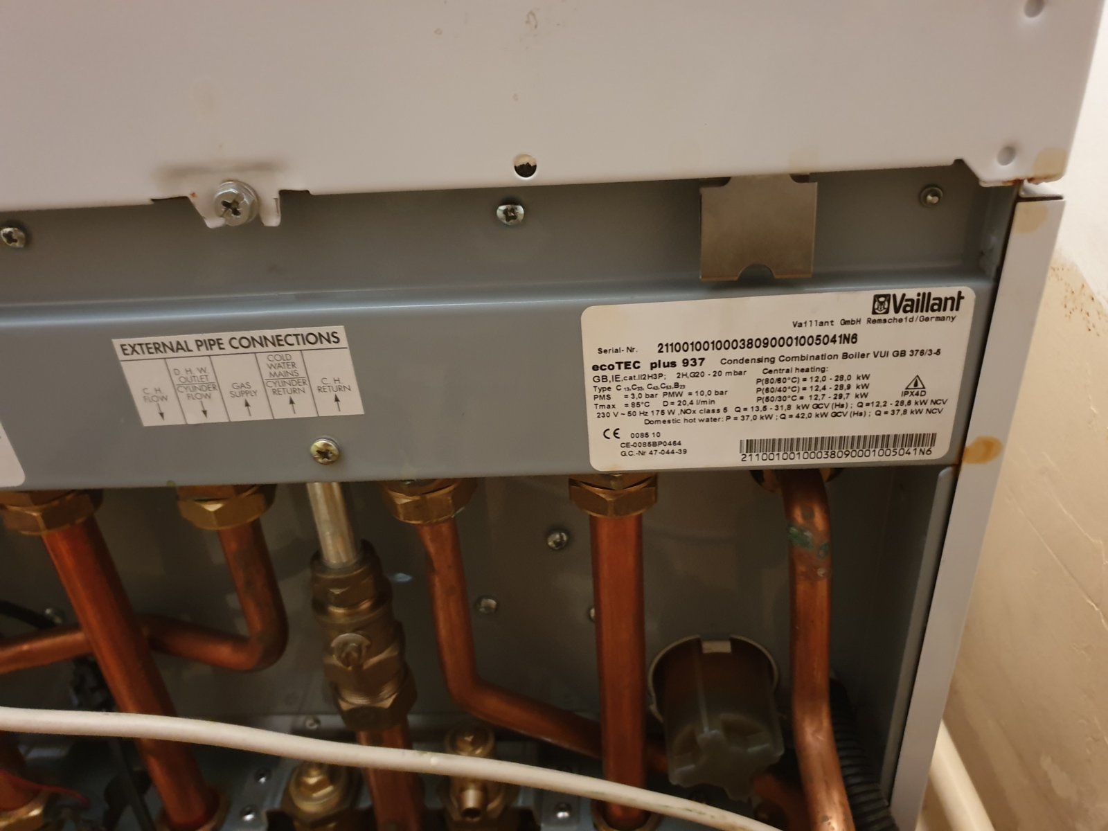

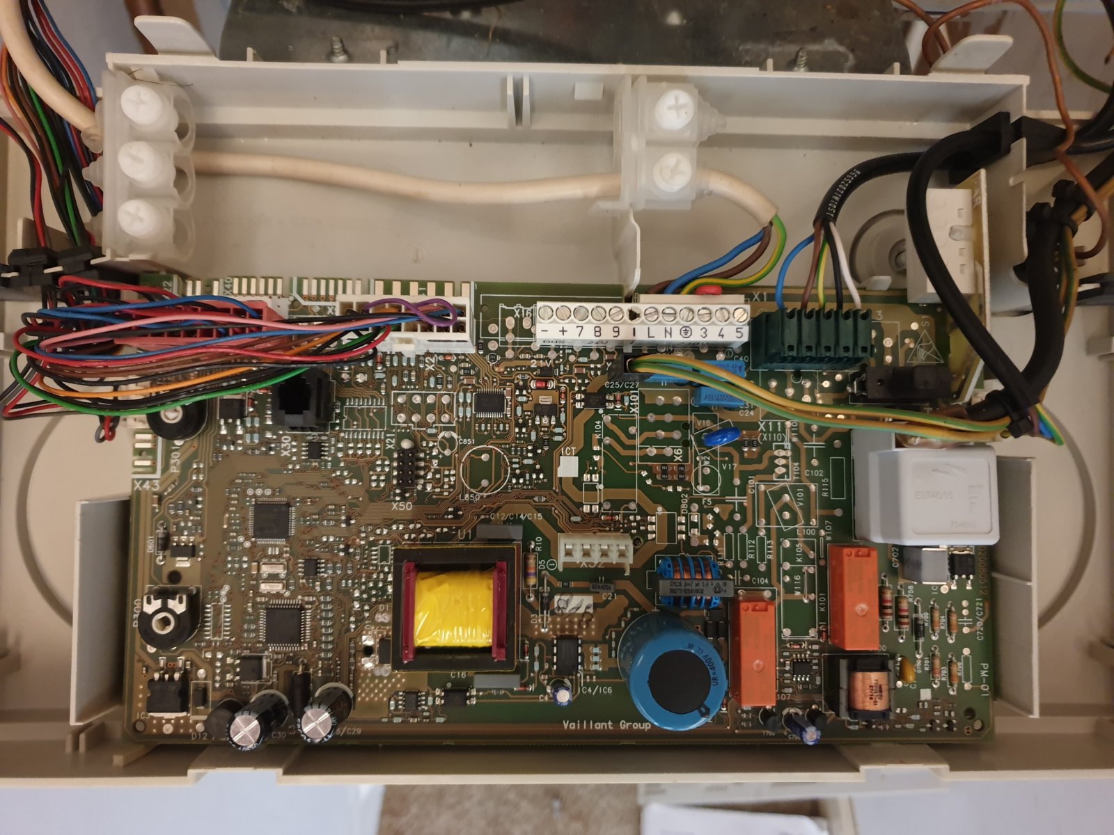

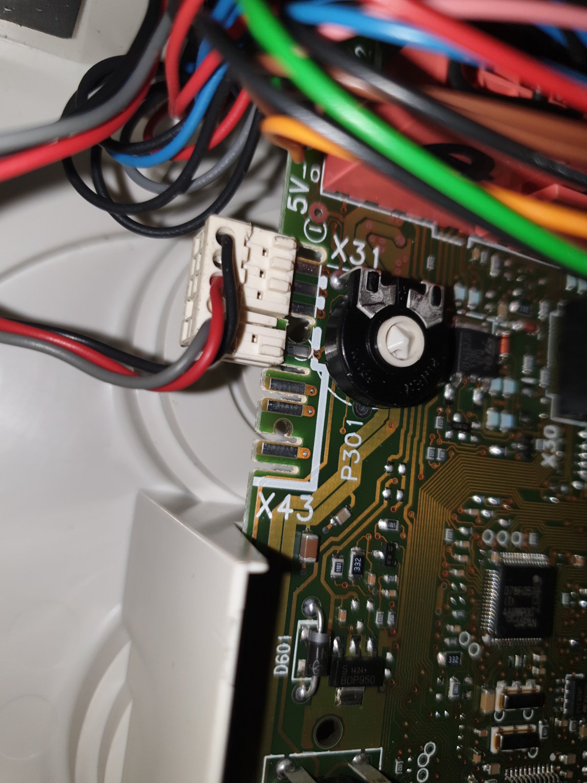

Hi All,
I'm looking to wire up our Ecotec 937 plus with Opentherm and Evohome. So far I can source the VR33 module and have located the X31 interface on the PCB where this should be plugged in. Unfortunately it appears to have another connection already plugged into this serving the shift load storage tank. There are the free ebus connections - does anyone know how I can get this to work? I'd really like to get OT running, if not I'll use the more conventional BDR91 approach.
Thanks for any help in advance.

Thanks Ian, it is well out of warranty - 9 years old. My issue is where or how to plug in the VR33 now X31 appears to be taken. Any solutions welcome.

Where would you plug the VR33 in on that boiler if X31 is being used for the tank electronics?
I wouldnt advise it myself. And as said shouldnt be in there if your not competent to ensure full safe working of the appliance afterwards
Hi, Yes - you can use the VR33 as a pass through - there is a second terminal on the board that will allow you to plug in the X31 connection.
