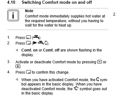

Sounds like your diverter valve is sticking, turn the hot water comfort off and see if the boiler stops heating when there is no demand.

I'm thinking on the same lines as you, so when I left this morning at 7:30 comfort was off and heat set to 15C. I'm looking at the Nest app now on my phone and heat is still set to 15C and says not heating, but house temp is 19C..no its not sunny, its Manchester! so the boiler has been up to something of its own accord in the past 5 hours. I guarantee it will stay at 19C until 4pm when the heating officially comes on and takes it to 20C.
