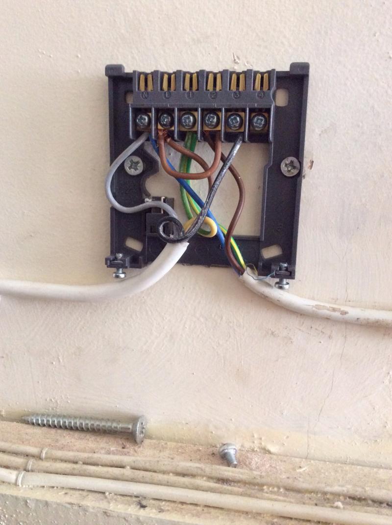

Wired wrong :D see if link removed in 3-4 on terminal box an if its the newest ecotec without the knobs on the front have they removed the 24v link :D :D these are on the boiler not the stat
I'm glad ur an expert :rolleyes: the new ecotec has a 24v internal that needs removing unless u use Ebus controls :rolleyes: ;)

sorry guys but your losing me. the thermostat in the living room is wireless and the receiver seems to be mains run which is next to the boiler. When I get my mrs to operate the thermostat downstairs the receiver clicks but nothing happens with the boiler????
I didn't think I was legally allowed to open the front of the boiler as I'm not gas registered? I assume your on about checking the panel inside the boiler?
Hi all this is how the receiver is wired.
