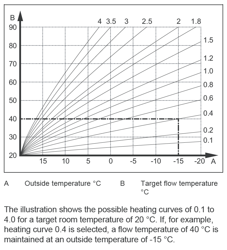

Regarding the Heat Curve, it is currently Set at 1.2 which picked up during Installation and the House is Slow getting to Temperature.
The Adaptive Heat Curve is Enabled.
Does anyone know how long it takes for the Adaptive Heat Curve to Adjust?

If its this set of curves then by knowing the outside temperature and looking at the actual target temperature you can see if its adaptive or not. If the outside temperature just now is 10C then the unadapted target temperature is ~ 38C (1.2 curve) and so on. If the rated output of your rads are 6.39kw then they will only emit ~1.55kw at a flowtemperature of 38C, (return, 35C) so your boiler might never even get up to 38C, is it firing on/off continuously?.

As I said Kevin, measure the outside temperature, go to the WC curves (if like above), go vertically upwards from the ambient temperature reading until it hits the 1.2 curve, the set target temperature is horizontally to the left (Y axis).
What is the outside air temperature just now and what is the boiler flow temperature?
I have no idea how long it takes to adapt.

I have the Wireless Weather Sensor connected to the sensoComfort which Reports the Outside Temperature as being 11.5⁰C.
The Current Flow Temperature is 40⁰C (ish).
All of the Rooms except one are upto Temperature (20⁰C) after approximately 4.5 Hours.
increasing the Heat Curve would presumably Help.

11.5C OT = 37.5C target temp so it may have made some adjustment.
Something strange here though, at a boiler/rad flow temperature of 40C the rads will emit 27.7% of their rated (T50) output, the 28kw Vaillant Sustain has a minimum output of ~ 7.5kw, its not cycling, so the installed rated output of your rads must be ~ 27kw to enable the boiler to run continuously at its minimum output, yet you have only 6 rads?

Yes, I saw that but its minimum output is 7.5kw, you say " I only have 6 Radiators, all P+ which come to a Total of 6.39kw" so at ~ 40C flow temperature the boiler (on CH only) will have to be cycling very frequently as the demand is only ~ 1.8kw, based on that rated rad output, the target temp wold have to be > 70C to enable the boiler to stay firing for most of the time but that corresponds to a outside temp of minus 20C or even less.
