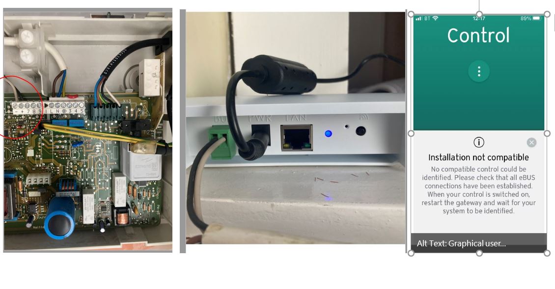

Hello
I bought a Vaillant Ambisense Starter pack (three TRVs and control unit) for my EcotecPlus boiler. I've connected the boiler's BUS terminals and the R920 controller's BUS terminals and , set up the Vaillant VRC700 app. There's an internet connection but when I open up the app I get 'Installation not compatible - no compatible control could be identified '. I've done the re-start etc but am getting nowhere.
Any ideas? I used 2 of the 4 core heat resistant cable that was used by my previous Siemens RF controller, might that be the problem?
I've swapped the cable for 0.75mm2 2core multi-strand but it's still not working. I've reversed polarity. I've deleted and reinstalled the app. Still the same message. Please help!
Hoping today's weather might mean a Vaillant/Ambisense expert abandons outdoor plans and goes online to rescue floundering diynotters... :)
Hi Chris - there's a photo in my first post - the boiler's electric board, the controller's connection and the app message - can you see it? (It's there when I'm logged in but disappears when I'm not)

No, I can’t see anything, it’s not on your profile media either.
Have you also got a VRC700 controller plugged in somewhere?
That’ll be why it’s not working. You’ll need a VRC700 as well.
Setup seems ok, perhaps it actually isn’t compatible? Unless it’s as per @Cal10 and you need the additional controller?
Ah ok. Shame Vaillant didn't tell me that when they advised me to buy the Starter pack, I thought including everything to needed to get started was the point of it! o_O Thank you for pointing me in the right direction!
