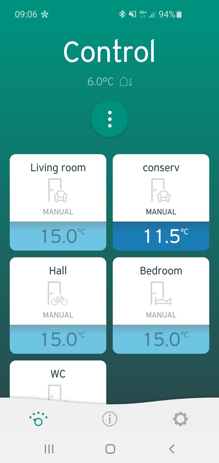

It should look like this in app. Are you still getting a zone for the vrc700 showing?
If so, go into the installer menu on the 700 and system config, then post up the settings ill look and tell you if somethings not right
Hello, Thank you for your reply.
Yes, my app still shows ZONE2, with the VR50s.

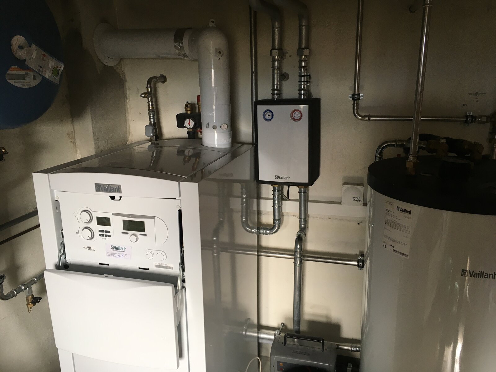

Do you have an electronic mixer on the system? I'm assuming this is a combi boiler just heating radiators?
There is a Vaillant VDM mixer. Attached is a photo of the system. I have wondered if it is an issue with the system being Swiss. VR50s are not sold in Switzerland or on the Swiss Vaillant website. Maybe the app itself knows, as when I first registered the app, I selected Switzerland. It could also be the firmware on the VR920 or VRC700 which is a Swiss edition. I got the valves from Germany. I asked Vaillant for help, but they refuse to, as VR50s are not sold in Switzerland.
