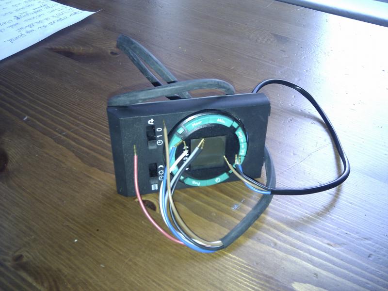

I have a Vaillant Turbomax 282e boiler. The timer is one of the green mechanical jobs, and it appears to have a fault - when on timer, the heating never goes off when it's meant to; if the timer says on from 8 to 9pm, I will find it still firing at 9.30, showing no signs of stopping. when it is in this state I can "reset" by powering off the boiler, and sometimes just by moving the timer to the off position, but that doesn't always work.
So I found a replacement timer on ebay... I'm not sure it's the timer, I imagine there might be other causes, but I found what looked like a good replacement, a digital version which if it worked would be an upgrade. It was only £25 so I took a punt.
Sadly, I am a prat.
The new timer is for a Thermocompact 282e, and despite being the right shape and colourscheme, the wires are different (why Vaillant? Why the same boiler number?).
The old timer has a 4-wire white ribbon cable which plugs into the PCB.
The new one has heavier wires that have to be separately screwed into a connector block. The wires are blue, brown, black, red, white and grey. There's a secondary loom which extends the black/brown/blue, presumably a power circuit for something else.
Question. Is there any point at all in trying to make this fit? I assume not, and the seller has agreed to refund, but I thought it might be possible and that someone here would have a definitive answer!
Many thanks, sorry for being longwinded.
The new clock you have is for a system boiler not a combi I'm afraid. Its not the same part number at all so I guess the seller mis-led you a bit You probably have a VUW 282/1, the clock is for a VU 282 (amongst other system boilers).
I'd get a refund and look for the right clock. You can still operate the heating manually with the old one.
What a shame. It wasn't a mis-sell, it was clearly labelled for a Thermocompact, I just went by the number, which I correctly remembered. The seller actually offered to refund, which is very good of him, it was my mistake.
Thanks for the advice. I'm thinking of wiring in a wireless unit, hopefully that will solve the problem, and if it doesn't I'll just wire it into the replacement boiler, this one is 14 years old so it's bound to need replacing pretty soon.
