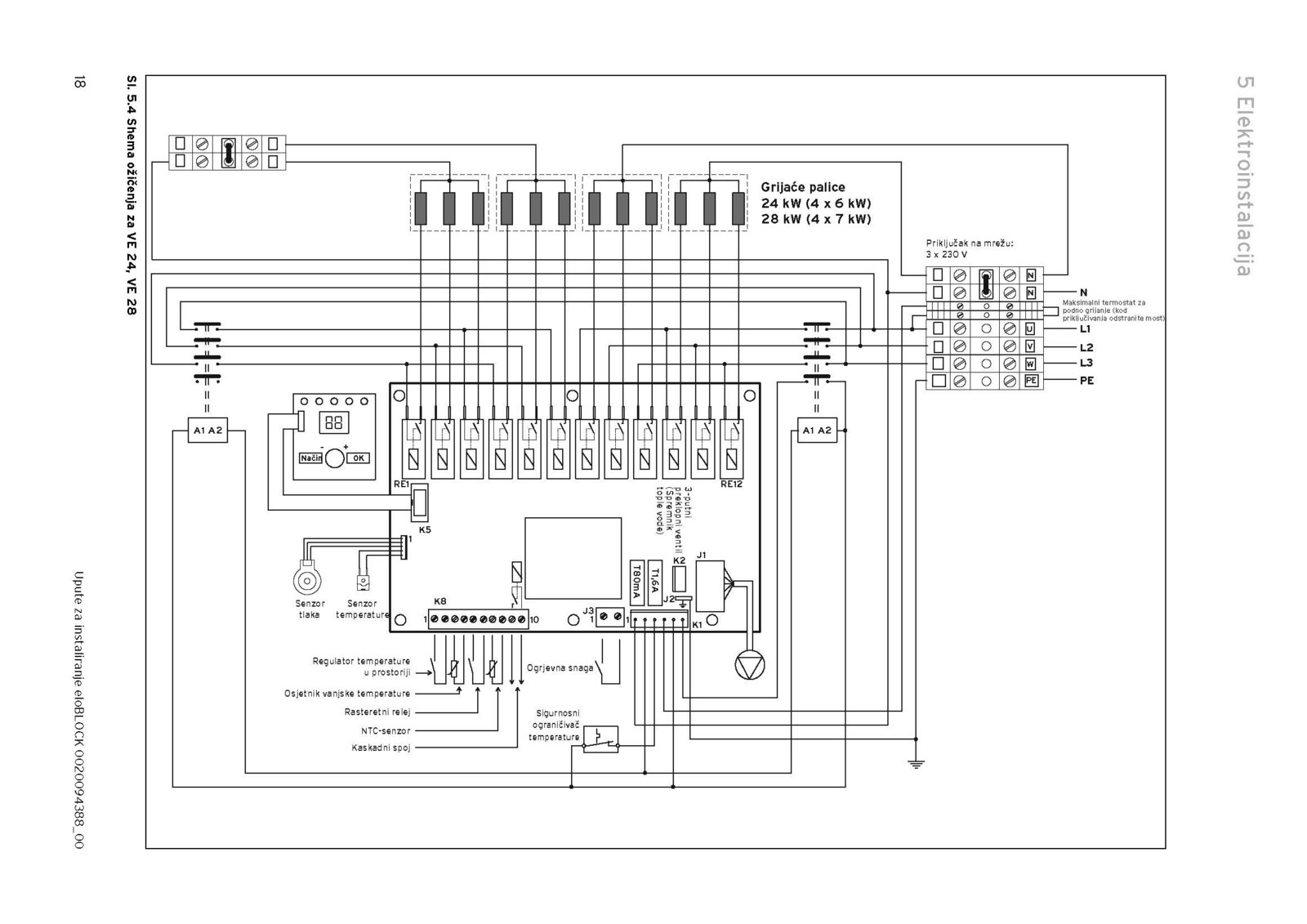

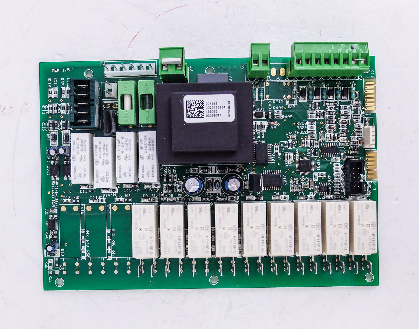

Dear all,
I would like to apologize in advance for maybe repeating this question in this forum. Unfortunately i could not find the right thread that answered my question that is why I am addressing you guys and gals once again.
I just recently purchased a Vailliant eloblock 28kw electric boiler heater for my house, and I am interested in knowing if i can connect this unit to a Nest Thermostat. This unit i believe is also know in some other countries as ECOBLOCK, although I am not sure.
Unfortunately where i live, I could not find an English schematics of the unit so bare with me and for the Russian speaking people or individuals with electronic skills please let me know if I could be able to connect this unit and how to connect it if possible to a NEST thermostat.
I will attach also two links/files as how this board looks in reality and the Russian/Polish schematics i found online.
I would be very great-full if someone could help me, and I do apologize in advance If I missed a relevant post on this topic that could have helped me.

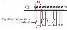

My mistake, when I tried to translate in Google Translate it showed as Russian.
"regulator temperature u prostoriji" (Croatian) translates into English as "Regulator Temperature in the Room" and shows a voltage free switch....
....that has a 'bridging link' fitted, which is usually found when a room thermostat is not connected....
.....which to me, all seems to point quite nicely to the connections being for a room thermostat. And, as the Nest is a room thermostat and has a voltage free switch (Terminals 2 & 3)......
....personally I can't think of any reason (but can't guarantee it) why it wouldn't work.
Having said that, I have two comments for you to bear in mind:
1) If there are any external motorised diverter valves that control the water flow to a stored hot water tank or heating zone, as we often have in the UK (Sorry, I don't know anything about heating systems in Albania) then the Nest would usually control them, and they in turn control the boiler. If you don't have any external controls, then this is not a concern.
2) The current capacity of the Nest Heat link switch is limited to 3A (resistive) and 1A (inductive) which is the same as most room thermostats I have seen, and I can't imagine from looking at the size of the terminals and 'bridging link' shown in the photo you provided that it would be in excess of this.
The Heat link also does require a permanent mains supply (230V) to power it connecting to N and L, and the Nest Thermostat requires a 12v supply which can come from terminals T1 & T2 or via a separate plug in power supply.

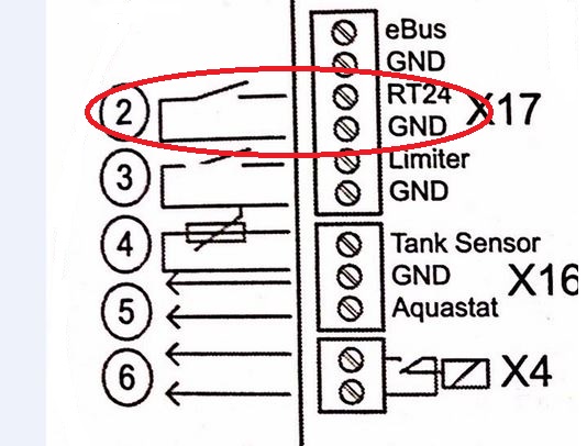

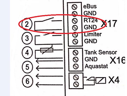

Sorry for the delay on my response.
Thank you very much Stem for your very helpful response.
I was able to open the heater and found a different PCB from the one posted earlier.
As you can see it is a little bit different from the schematics found online.
Below is also a photo of the schematics from its original manual:
A more detailed photo of the terminals:
I would really appreciate if you can give me insights as to how you would install the Nest to this device Stenm.
Thanks in advance.

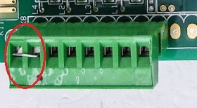

In that case the terminals for the Room Thermostat [RT] are those marked RT24V. The red link is removed when the thermostat is connected.
They would go to the voltage free Nest Heatlink switch via terminals '2' & '3' or 'C' and 'NO' depending on which version of the Nest Thermostat you have. It doesn't matter which way around they are connected.

I'm not so sure about that design...talking to design engineer the other day (that specialises in switching high current elements) suggested using just relays is flawed.
Far better to use triacs to do the initial switching and breaking and only use the relays to hold the elements on...of course that wouldn't create a nice profit in replacement boards.
It's not easy to replace the relays on Vaillant boards...with plated through holes and a very tight pin fit making it almost impossible to remove them without destroying the tracks.
