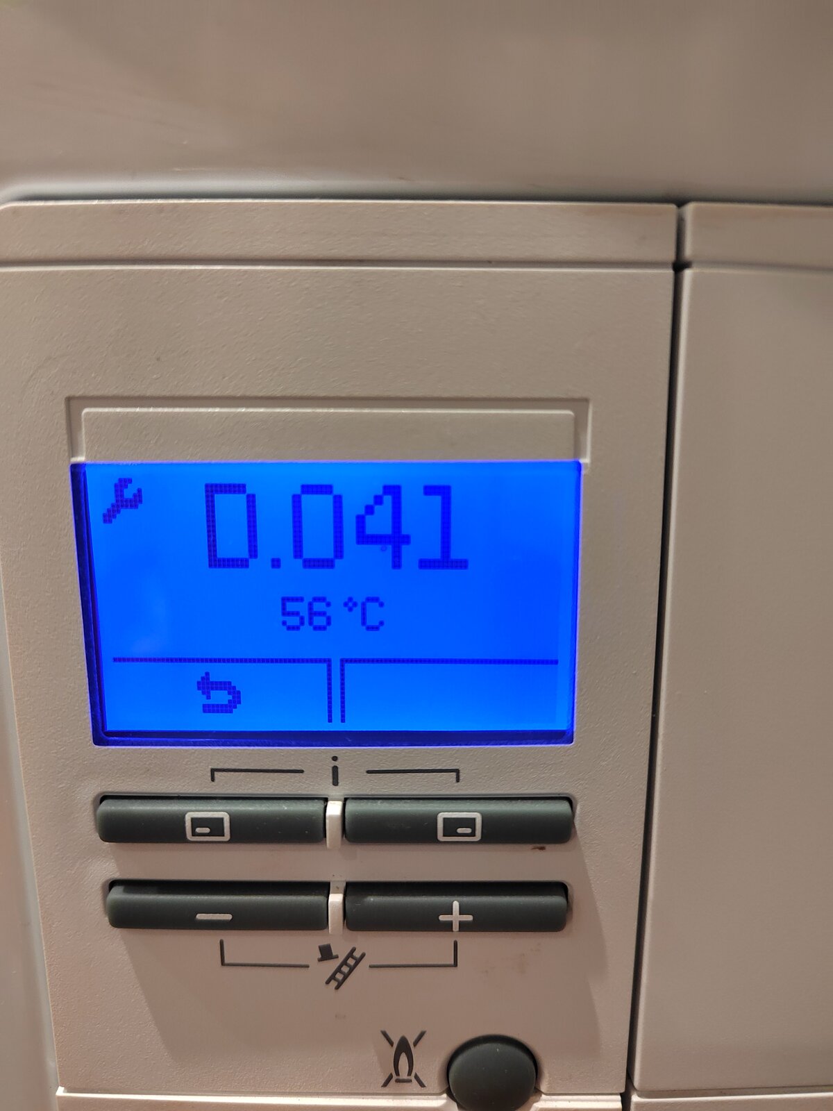

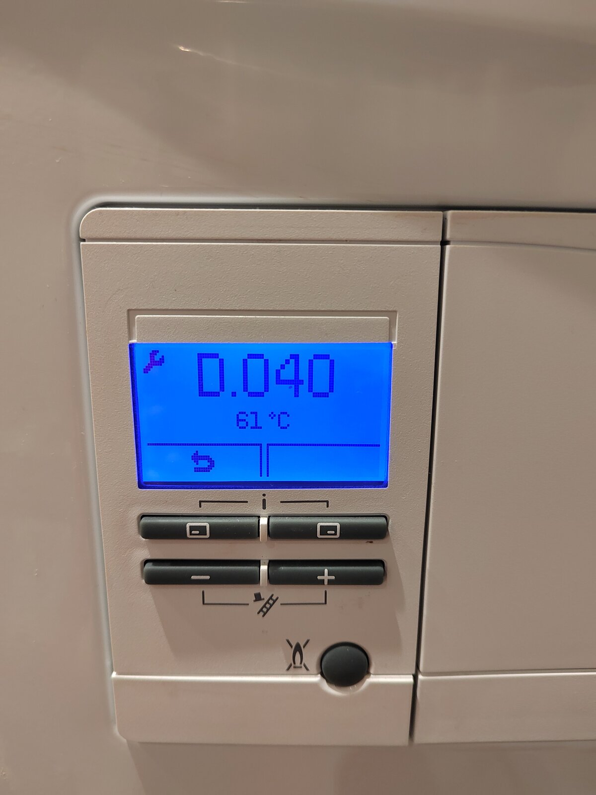

Have you looked at the boiler return temperature, d.41?.
Hi guys. New rads fitted. There was barely any debris or sludge, just slight in that one rad in my room, they drained it all out and water was barely discoloured. Flat sooo cosy. So after they left I kept heating on and checked the temps. 40 - 61c. 41 - 56c
What do those flow/return temps mean? is the boiler running continuously?
Your rads will be emitting 53.7% of max at flow/return temps of 61C/40C, the min output of your boiler is ~ 6.0kw if its running continuously close to its minimum then, by calculation, the T50 (100% output) rating of the 7 rads is 11.2kw or 1600W/rad, seems very high for single panel rads.
I'm surprised the boiler isn't cycling. (if its min output 6kw.)

No. I certainly dont, did the installer not give you theeir outputs if they supplied them, it wouldu be nice to know, also the 20C dT is interesting, wonder is that set in the d parameters or just by chance due to pump speed or whatever.
20c difference? It was only 5c.
61C - 40C = 21C ??
If not what ARE the flow and return temps now that the boiler is running continuously
Here is snapshot I took earlier
