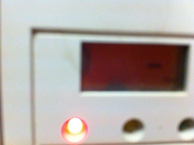

I have been having an issue with my valiant boiler which is approx. 4 years old. Last week I got the F.73 fault (water pressure sensor) but the manometer read 1.5 bar and the EV seemed to be correct pressure. I read on these forums that sometimes cleaning the pressure sensor would cure this. I removed and cleaned the sensor and all seemed fine.
However, two days later I had the same F.73 fault again so I tried cleaning the sensor again. This time it didn’t work (I think the first time may have been coincidence). I also found that when I pressed the ‘-‘ button I had no pressure reading at all, the screen just displayed ‘–bar’.
I thought that the sensor could be U/S and ordered a replacement. However, I just fitted it and still get the same error. When I press the reset button (flame with cross) the fault light goes off for a few seconds and I hear something turning, but I’m assuming that the pressure fault stops any further operation.
I just wondered, is there something I can check when I get the ‘-bar’ reading on the display. Have I missed something when refilling the system with water?
Any information would be appreciated before I call out an engineer. Thanks in advance.

I've just metered accross the green signal return cable of the water pressure switch and unbelievably I think it's open circuit. I'm getting 5v supply to sensor but nothing back on PCB from green signal cable. However, if I meter at sensor itself, green cable shows 2.5v.
Going to double check it now and replace cable if it is (I'm sat in loft next to boiler with laptop at moment)....freezing....

I found it was the pressure senser return cable open circuit. When I 'cleaned' the temp sensor the first time I must have moved the cable and that's why it worked (not me cleaning the sensor). I have just replaced the cable and the bioler started up first time. Don't know how it went open circuit though?
Maybe the original sensor wasn't faulty at all or maybe I damaged cable when exchanging, although it's easy to unplug and can't see how I could damage the cable. Ah well, at least we now have hot water and CH :)
