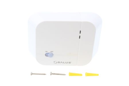

Have you checked the batteries in the wireless thermostat?
I don't have a Salus receiver - just the room thermo (attached)
The thermostat is wireless. (of the above pics, 41 & 53 are from the thermostat, the others (39, 42) the boiler itself.
THEN YOU DO HAVE A WIRELESS RECEIVER !!! How do you think the salus thermostat talks to the boiler ?
Follow the cables from below the boiler will probably look like this
"Salus Receiver" - didn't mean much to me.
Assumed the thermostat would be understood as wireless.
glad we got that sorted!
I will replace the batteries - this seems a probable cause here - AND the best outcome possible with heating malfunction.
