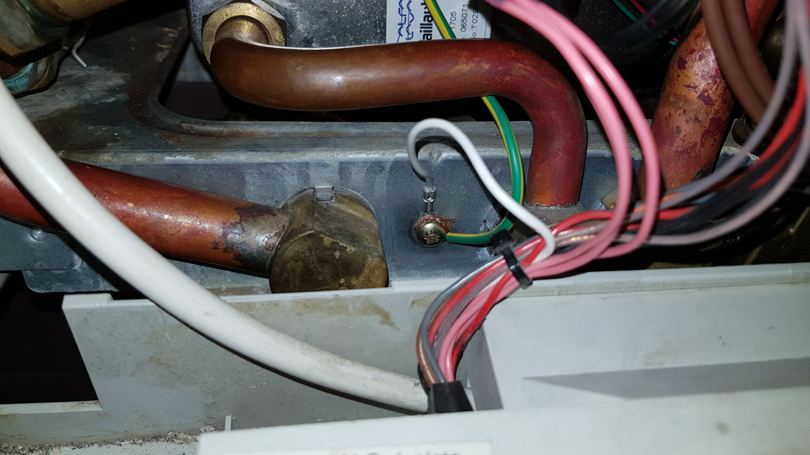

So... back to the F22 fault that started randomly creeping back in, only things left I'd read on here not tried were the somewhat expensive PCB replacement and a burner pressure tweak, but then I happened upon a youtube vid. of a boiler engineer fixing an intermittent problem on a newer valliant that saw the DHW temp rapidly rising on display (causing lockout) but actual water temp. not reflecting display temp. He pointed out that the NTC sensors are single wire and use boiler pipework as an "earth" return to PCB via boiler chassis. After 18 years, the boiler pipes and contact points were hardly prime electrical conductors and on the return sensor there was a good 60 to 70 ohm resistance so I simply used electrical earth straps to bond freshly polished flow and return pipes where they emerge from the bottom of the burner box, directly back to the PCB earth point on the boiler chassis.
Switched boiler off and back on presuming there might be some kind of initial NTC resistance calibration carried out by PCB and it's been running perfectly, DHW is back on and the boiler hasn't had an F22 or any other lock-out since.
Here's to another 20 years of fault-free, service free operation and if there are any of these beauties left in the wild, hopefully the motivation to inspire others to try this extremely simple fix that doesn't even require opening the burner box!

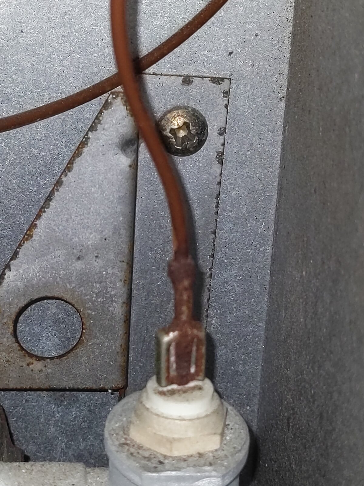

Still working on a bad connection theory, I reseated the connectors on the NTC sensors several times to hopefully improve the connection between the connector and the spade terminal on the sensors.

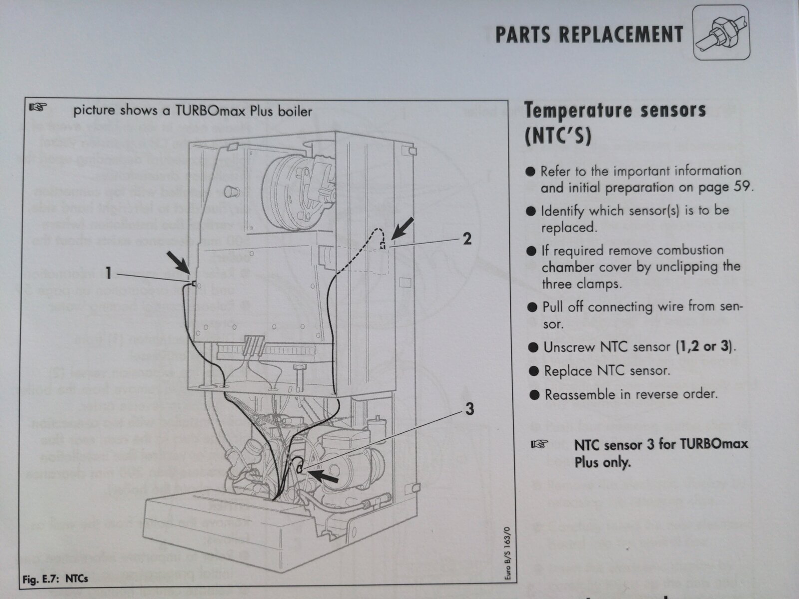

The TurboMax Plus has 3 NTC sensors, one each on the flow and return and the third is called the Warmstart -NTC which is located in the burner box.

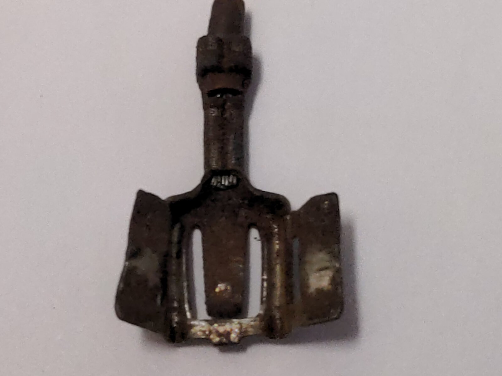

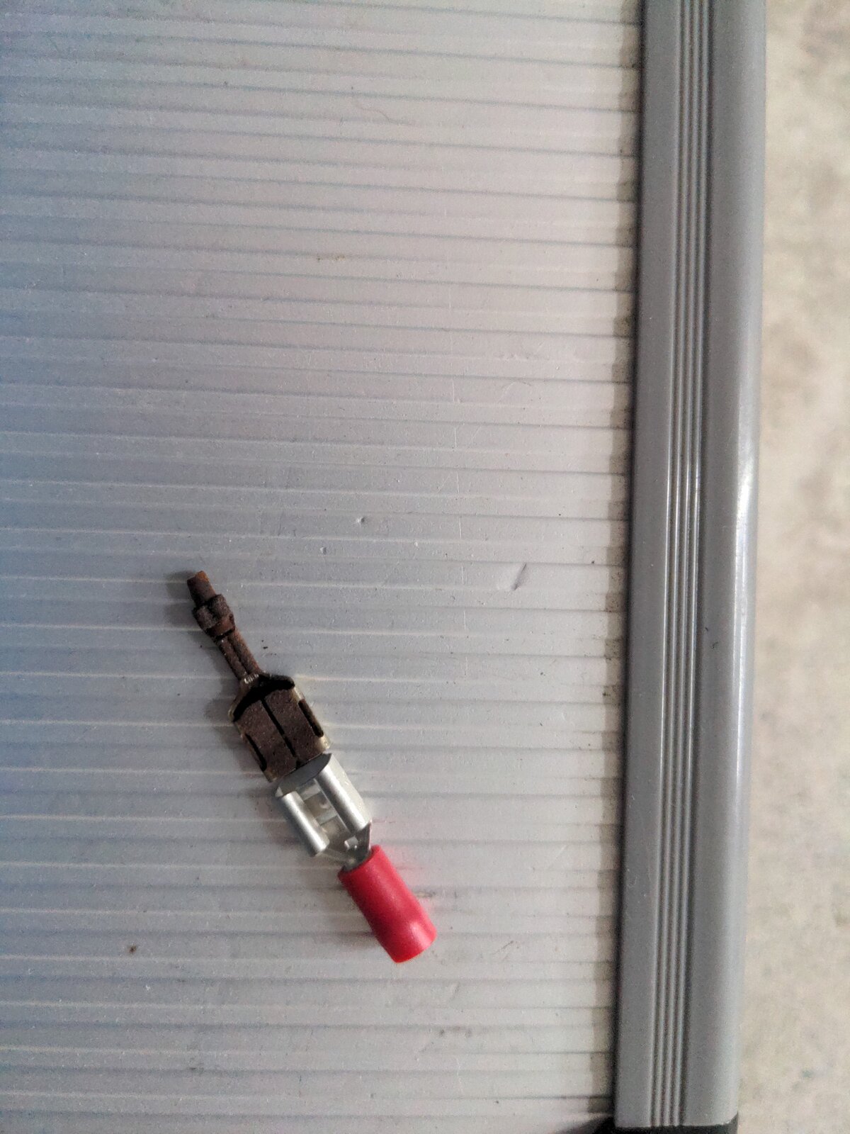

Having found my way into the burner box, after turning off the gas supply and powering down the boiler, I found the Warmstart -NTC sensor at location 2 as in the attached diagram. As can be clearly seen, the spade connector is well corroded but it still had some clean contact with the NTC sensor spade lug but because of the nature of the NTC sensor calibration within the Vaillant controller the readings were probably changing uncharacteristically as the water heated/cooled.
So, one week later, I can say that the replacement of the spade connector has solved the F22 error on this boiler.
