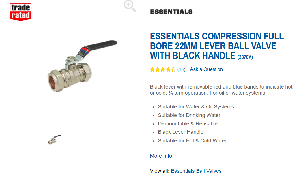

was about to replace one of these for our garden water, and I noticed it says not suitable for drinking water - why ?
Because the valve is meant for gas lines? Perhaps seals not tested to 10 bar or whatever that you gas line will never ever reach on domestic sites. Perhaps Gas112 will have a more definitive answer
Either that or it will have materials in its construction that aren't suitable for use with potable water.
Why wouldn't you just use one of these, same valve but is suitable for potable water and is cheaper?
Yellow handle indicates gas!
Why would you want to use this for your garden water, rather than a blue one?

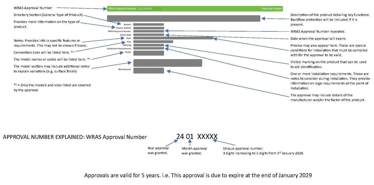

The valve has probably not undergone the tests required for suitability to connect to the public water supply and in this country most quality importers/manufacturers would also seek WRAS approval.
Of course that doesn't stop 1000s of suppliers selling unapproved/untested products for the public & plumbers to illegally install knowing little checks will be done.
You can search for products here...
