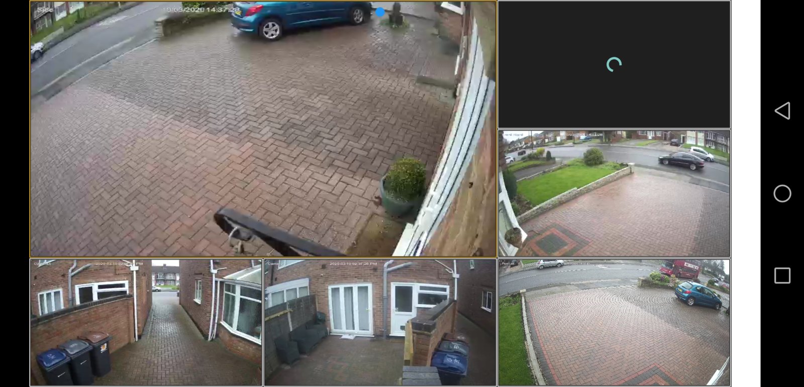

I have attached a pic of my current cctv (quality lacking and struggling to load as im on my mobile). I basically want to replicate this with a better system that has the alarm output as mentioned in a previous post. The main purpose is to monitor intrusion onto my property, i also want to protect certain areas such as the wall of my garden and area around my car with the line protection feature so it can trigger my house alarm if anybody crosses at night for example.
The 2 cameras cover the street as my ex used to park around the corner or down the road and walk to my property. Should anyone come and try to steal from me by doing this i i wanted to capture their vehicle.

so you have 8MP cameras already, just the live views on your phone wont show the 8MP in all its glory to be fair, so the images will look worse on there than they actually are, assuming your cameras are on full res
given these are wide angle cameras, and your seeing a lot of next doors property, then I would look at your house on ivpm calculator and use 4/5MP cameras with 4mm lens to see what I get roughly before jumping up to 8MP, you could look at the color vu or full colour options from Hik or Dahua.
you can put your exiting cameras on to see how they compare too?
Yeah 4k atm as i say im on the phone so the quality is lacking. I really only wanted to change to get the alarm function, but on the other thread where you said dont use swann cameras it got me thinking...i hate them. The app is terrible, the advanced functions like line cross etc are useless as the notifications are either always on or always off as i cant hook them up to an alarm, id be triggering them every time i go home. Some of the app functions dont work and the cameras constantly fail to load.
