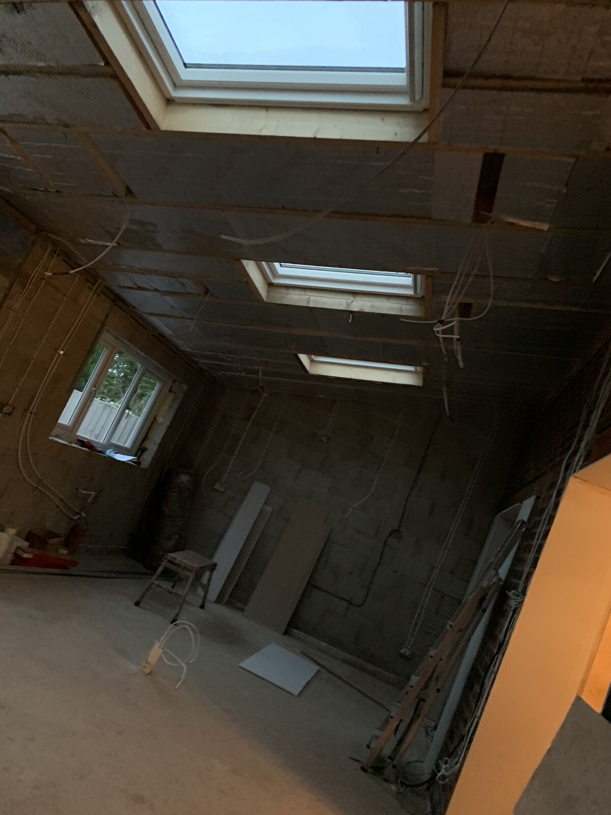

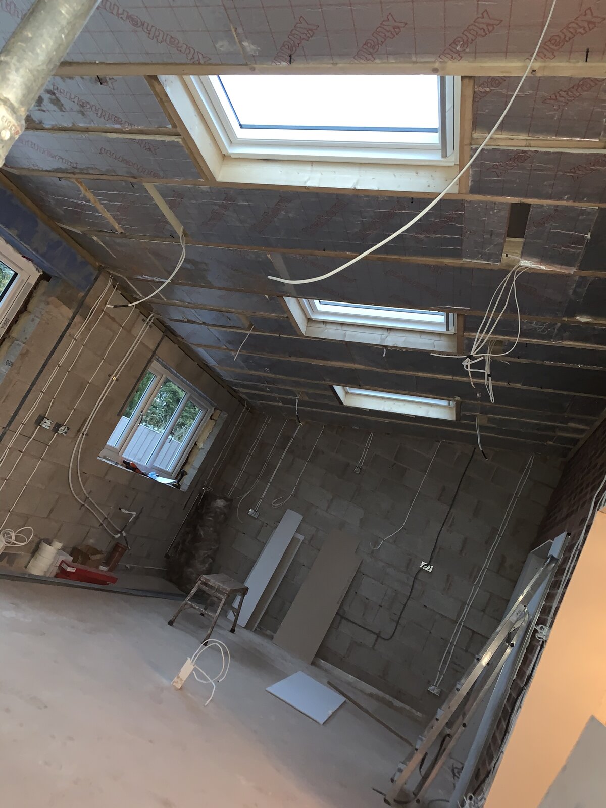

ALWAYS fit insulation across as well as between. Then robustly foil tape all joints and fill those bigger gaps* with foam first. I can't emphasise enough the importance of a robust VCL in vaulted, vented roofs - especially those in kitchens and bathrooms.
*Note the foam around the edges in the first image.
Also note (in both jobs above) provision was made for (heavy) light fittings with timber nogg's brought through the insulation layer - and taped of course. Nowt worse than an irate electrician hunting for a fixing point!
Wish I knew what I do now… mine was no where near as good as yours unfortunately.
I just don’t want to spend all this money and miss anything and have the same problem!
