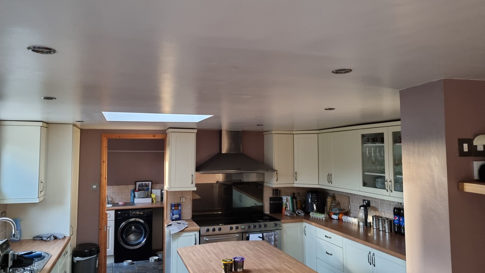

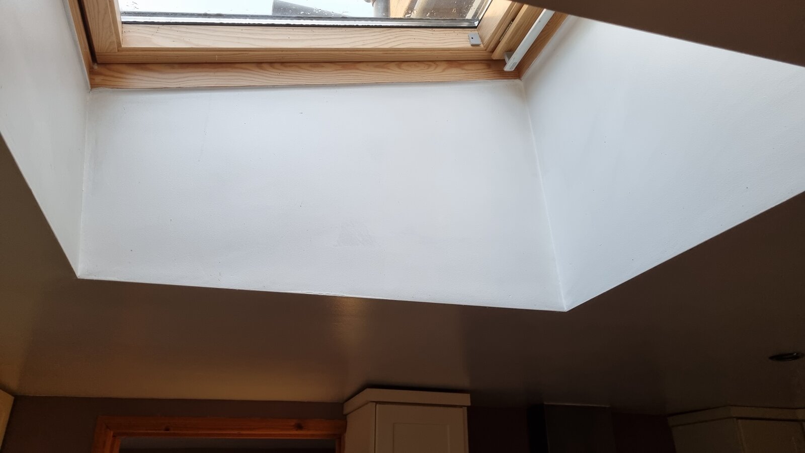

After some advice, we brought our home a few months ago and are planning on renovating the entire kitchen, we want to vault the ceiling as it's low (see photo). The cabinets are literally to the ceiling and they are not even positioned at the correct height above the worktop, hence why the ceiling needs raising.

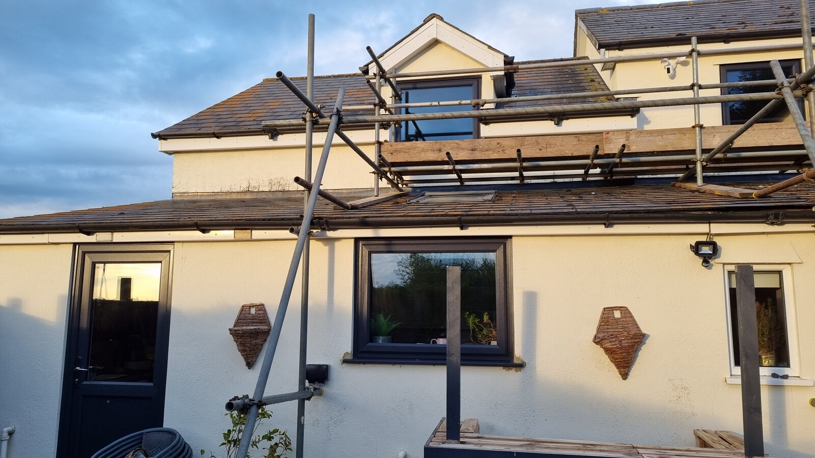

Hopefully the photos give you an idea as to what I am working with here. (Ignore scaffolding, it is there as we had new windows installed).
Any advice would be greatly appreciated. Thanks in advance.

Thanks for your reply. I think the ceiling is low because of the roof pitch having to start low on the wall above due to the existing upstairs windows, the roof was unable to go higher up the wall for that reason.

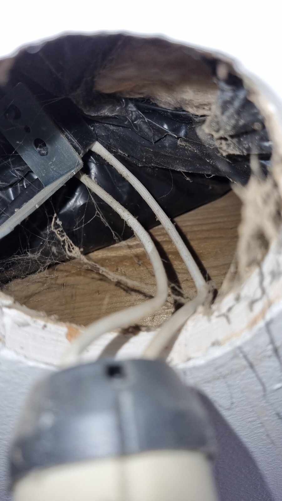

Tried to take a photo through the spot light hole but my phone dont really fit. So can't get a good look. I have attached what I could take a photo of which is probably of no use.
Quite the draft coming from the spotlight hole when the light is removed, brrrrrr chilly! Lol

Just clear the hole and shine a torch through and have a look if its rafters or trusses. We'll believe you.
Urgh I've tried to get a good look up there but there is black plastic sheeting everywhere above the joists so I can't get a look. I'll have to cut a hole out which I'll try and do later today. The wife was on nights last night so don't want to wake her up to a mess
Gonna look for other alternatives to access it in the meantime

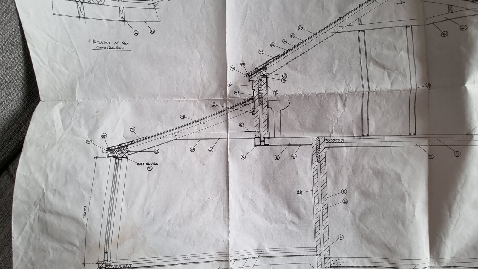

Ok I have found the original structural engineers drawings for the extension. Maybe someone here can make sense of it and tell me if that looks good enough to remove the joists and suggest alternative for vaulting ceiling not gonna obviously go off these plans as gospel will eventually check the ceiling but whilst the weather is crap I don't fancy having a drafty hole in the ceiling.
