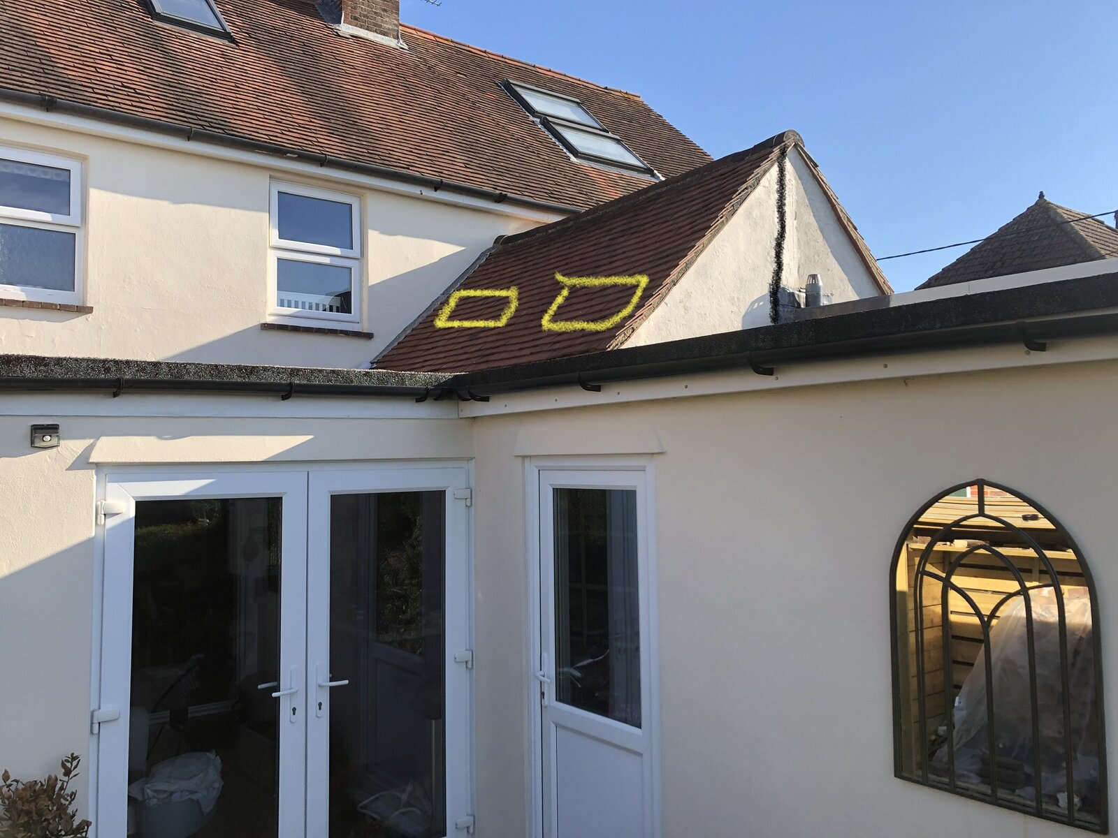

I'm wondering if someone could offer up some advice regarding either vaulting a ceiling or raising the ceiling so I can put a couple of velux windows in.
This is where i'm wanting to put a couple of windows in. The black line indicates there is a wall between us and our neighbours

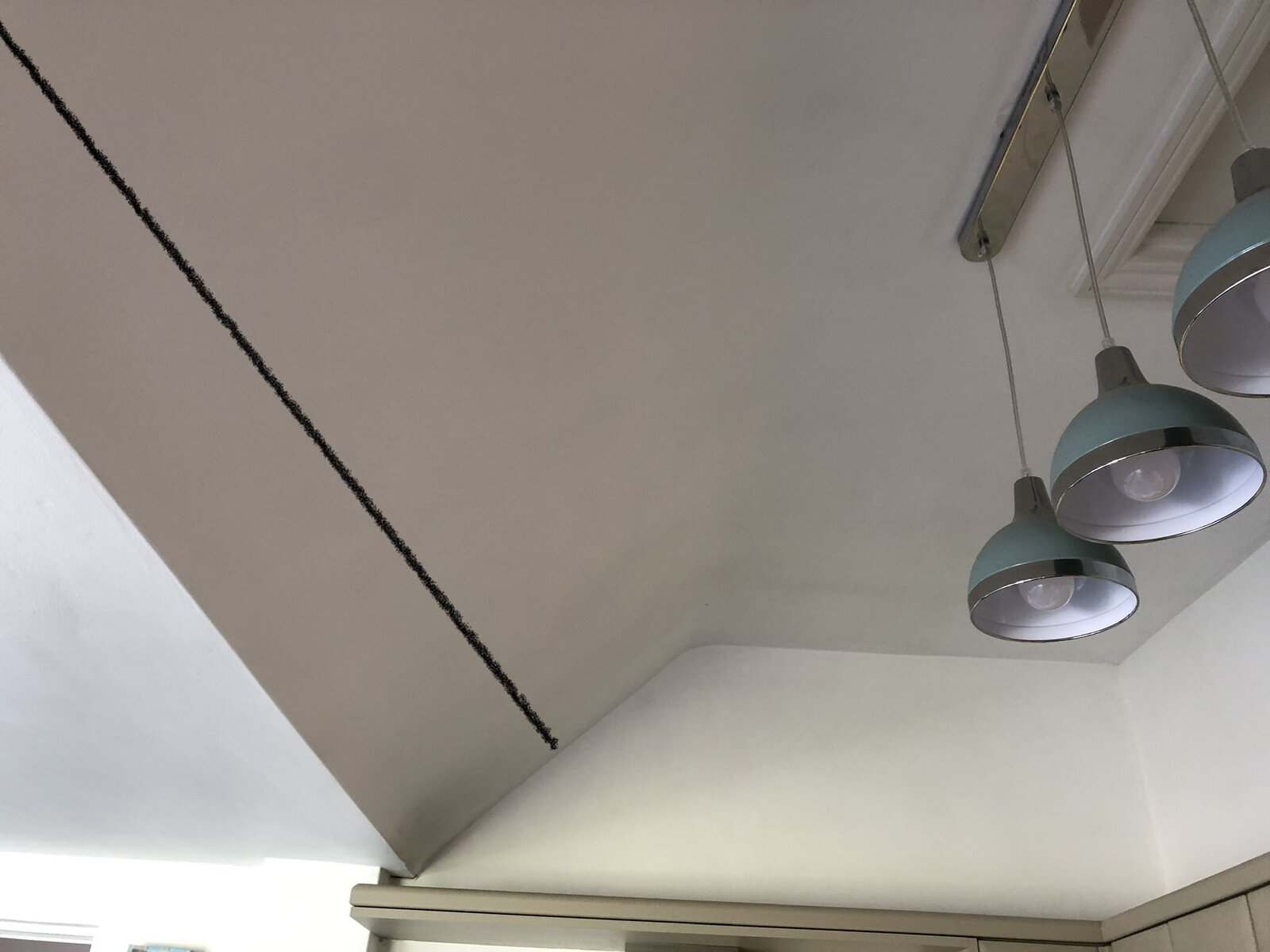

This is the inside, the black line is roughly where the top of the flat roof comes to. So need to raise the ceiling to accommodate them.
Because it's such a small pitched roof, am I right in thinking the ceiling joists won't that structurally important?? and i could vault or raise it.

I'm finding it a bit difficult to work out what is going on!
I get the impression there have been a few extensions?
Have you considered a couple of sun tunnels?
Yes you could do that, as long as the joists are not shared with the neighbour and you take their bracing away.

All the flat roof part was extending a while ago by the previous owners. The pitched roof part was the old kitchen, which has now been incorporated into the new kitchen.
I've considered the sun tunnels, but to be honest would prefer the look of the velux's if i can do it.
When I looked through the "loft hatch", there appears to be no bracing just the ceiling joists attached to the pitched roof rafters and onto the wall between the 2 properties. I've no idea if these continue across into neighbours house, should this matter if the joists on top of the dividing wall?
Ceiling joists are bracing for rafters.
You'll need to check if the rafters are suitably connected/supported at the apex, or if any ceiling joists do in fact brace both eaves
