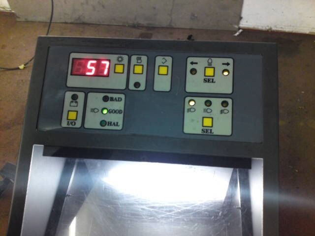

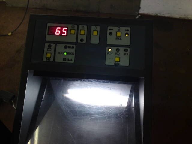

Back in 2009 when I had just bought a new Golf, I wanted to get better bulbs for it. I carried out a test of uprated H7 bulbs using the MOT headlamp test equipment. I only tested the road legal ones. Bear in mind that this was 10 years ago and the prices were trade prices excluding VAT. I won’t show you them all, just the cheapest and the most expensive. If you look on the machine, you’ll see the actual light output which shows that the most expensive were the least effective and the cheapest were the best. All the others fell in between. The standard bulbs at just under £4 a pair gave a reading of 48.
Phillips extreme £29.16 a pair plus vat.
Ring extreme £9.99 a pair plus vat.
