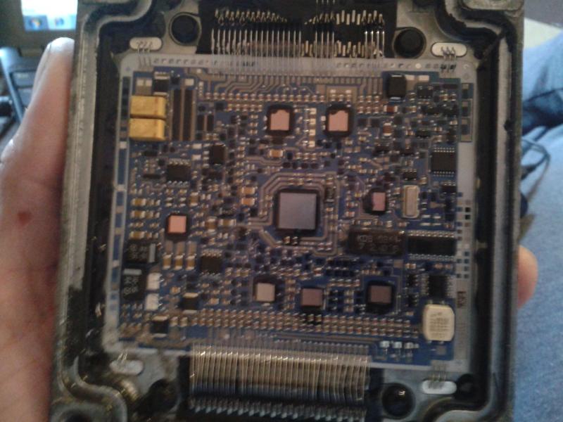

Right my van cut out the other day and wouldnt restart. I parked it up and went home. Collected the next day and it started, then after ten mins driving same thing. Left it a few hours then bingo she started.
Long story short everyone is saying its the ecu, some saying the edu.

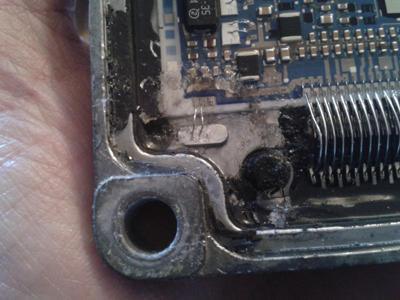

AA come out and said theres no diesel being supplied, so its the ecu or pump. He told me i could take the ecu off and have a look for damage. I did this and had some rouble getting the backplate off. When i did it was covered in a jelly type solution, a bit of it wa squashed and right in the corner there is three thin wires each one connecting two points tohgether. one was broke, im not sure if i done this getting the plate off or this would be the damage. A pic of the damage to the unit is below, can someone tell me if this broken link would stop the van working or if i have the wrong unit out and now iv ****ed that one too!
You've broken one of the earthing leads - nothing to lose too much sleep over. If you can, bridge the broken pad across to its neighbour, otherwise I suspect it'll work fine without that one pin.
Otherwise put it back and get the EDU out. The ECU's are not serviceable because of all the jelly inside them, and need programming to the car if you're going to replace it, but even so it's more likely to be dry solder joints on the EDU as I keep telling you, and as I instructed in my guide.
yes mr mfarrow you have been a great deal of help, i suspected it was earthing as it was the same in all four corners. lthough i was stressing out like a mother ****er thinking iv broke and unrelated part. I will try bridge some cable and put it back. One thing about that. It has a k and an m marked on it. hich way does it go back in??#

well, ive had the edu out. Im used to working in tight spots on boilers. I done the top 2 bolts from above, and within a minute with the van jacked up just loosened both bottom bolts from underneath and unclipped the wire. Then i manage to loosen and remove the edu from above.
When i opened it up, bearing in mind i have no magnifying glass, i could visibly see a burnt one which looked cracked all round the bottom side. This must be the issue??/ i thought i see 3 other little ones cracked but mayby it was just my mind playing tricks.
Anyway i added some solder but am not sure i have done a very good job. Messy and blobby, but im guessing this will not matter to much. Im waiting for the silicone to go off then refit. Im actually excited!! lol and dont want to be let down. hances are it was just the main burnt one i see?? right??
is there any effect if ive added too much solder or added to ones that wasnt cracked?
You cannot add too much, but some flux will have helped it flow. The important thing is that you got the pad nice and hot so all the solder melted/re-flowed.
Best to do more pads than strictly necessary as they'll be the next ones to go! Many have had repairs fail pre-maturely due to the new joints being nice and rigid but the neighbour then fails, so good to be on the safe side.

points taken, well im a plumber so i should hope i did get the solder flowing! Its def not cutting out when it would before and i notice theres not as much exhaust crap even when it was working before so all seems good. Thanks for your time and patience. Top bloke
