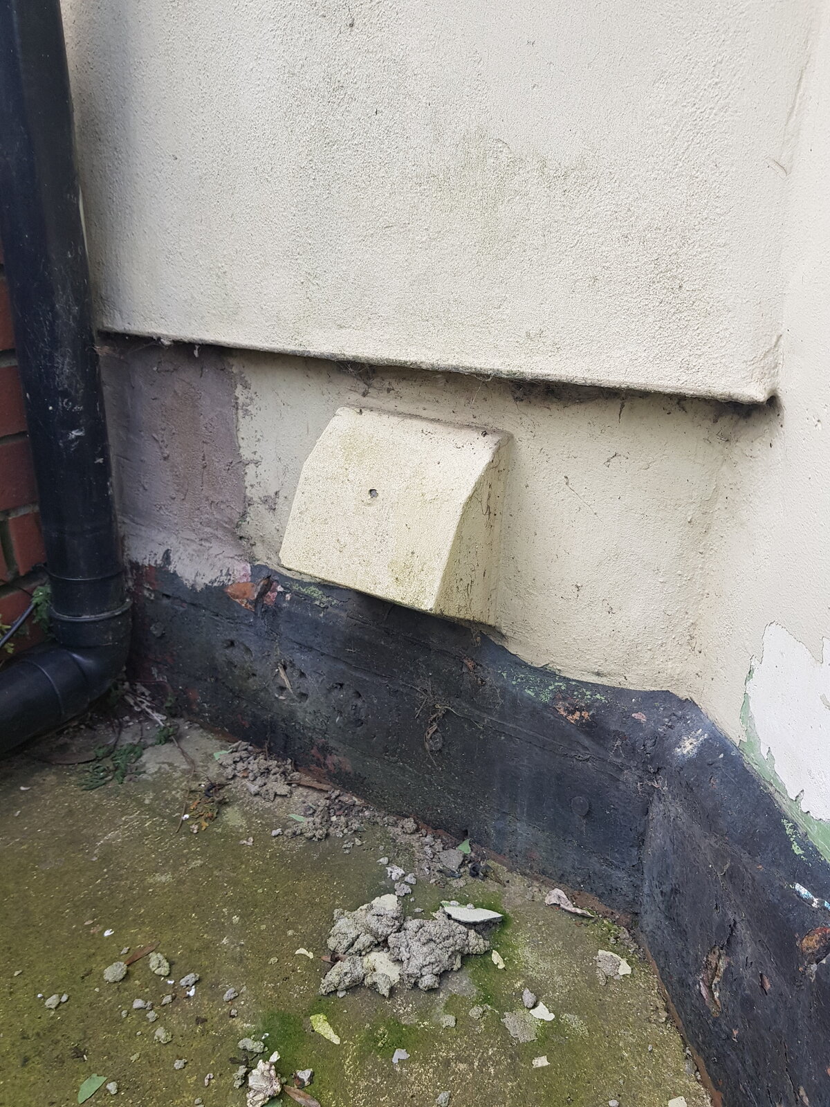

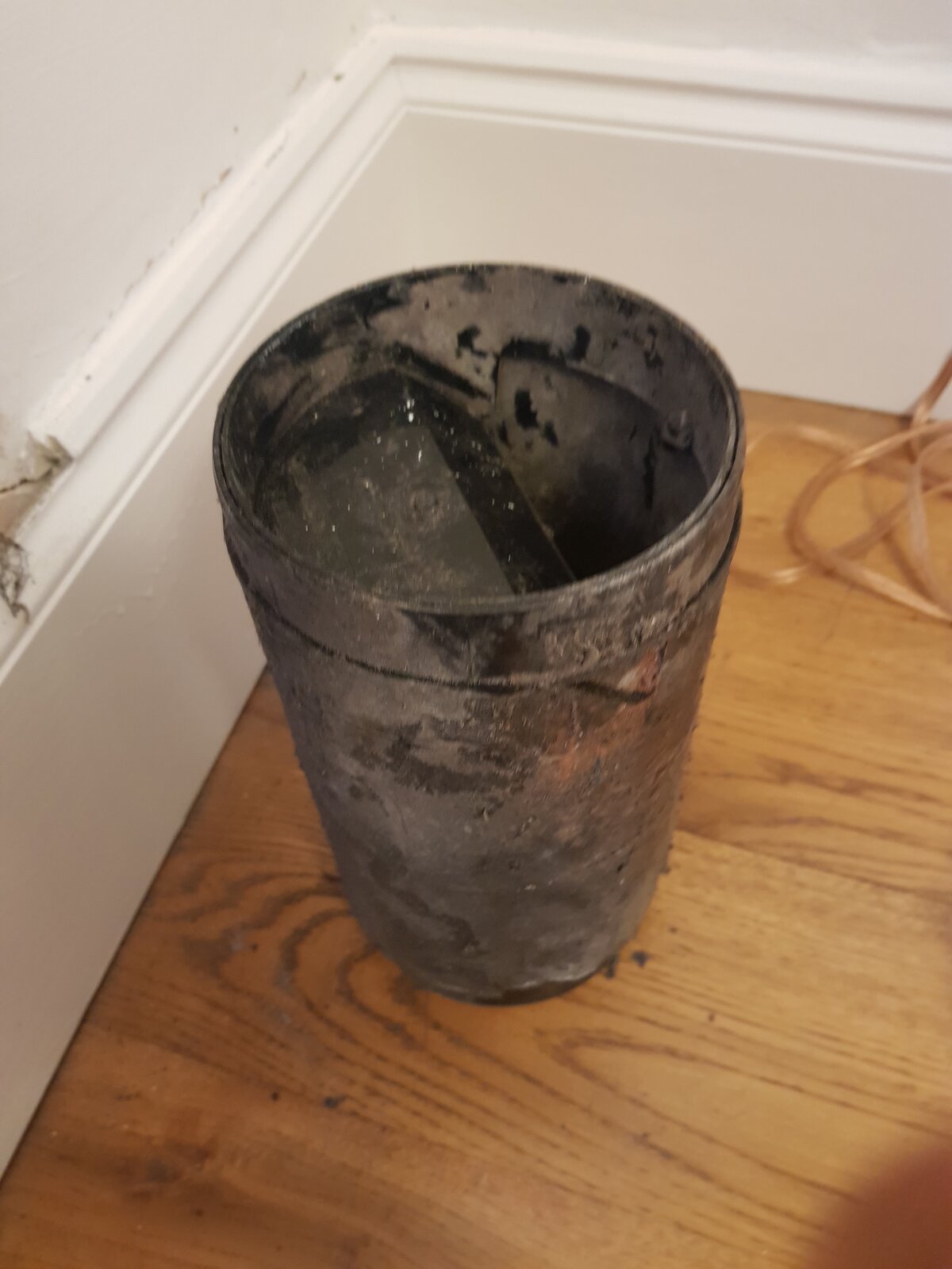

Hi, I've been renovating my house, and removed the front cover of this vent in my living room, I don't even remember what the front looked like.
The vent appears to just be a short pipe but has some channel on the inside so air doesn't just flow straight through the pipe. I have taken this pipe out for the photo
But it's extremely draughty, the cold is coming right in.
What is the purpose of this? It's at ground level in the corner. Is it something I could remove and fill the hole?
Photos attached...
Vents are a building regulation requirement when there is an open flued appliance in the room. If that is the case it's there to make sure proper combustion takes place and you don't get poisoned by carbon monoxide.

Thanks yeah maybe a good idea. I'm just kind of shocked at the amount of cold air coming through. I dont remember what front cover was on it before, but maybe it was able to be closed up more
As above, you could just stuff some rockwool/bubblewrap/whatever you have to hand in there for now and put the cover back, and it's there if you need it.
