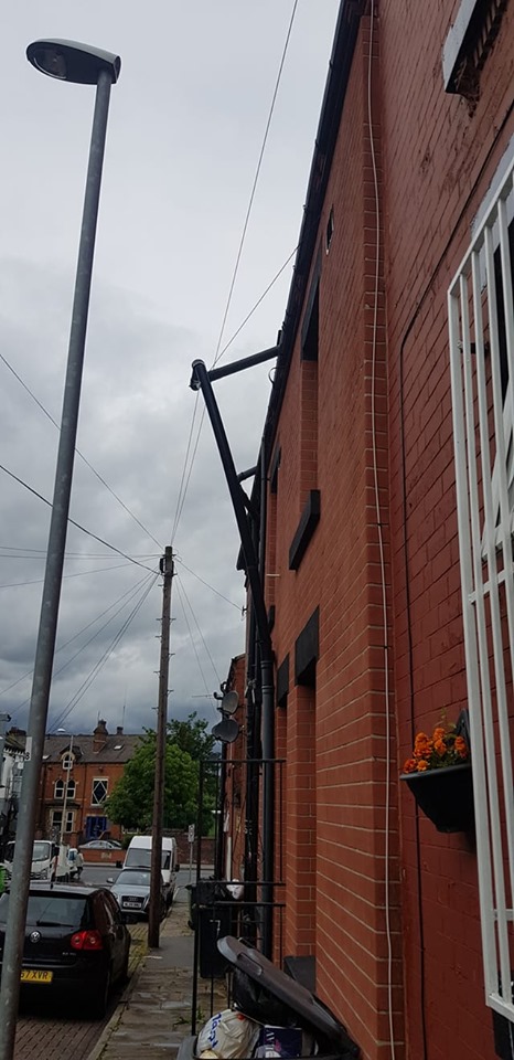

Soil pipes do need to be clipped to the wall too. ;) Saw a photo on social media earlier, of the large section of pipework that's come adrift and is hanging off the building due to lack of support!
