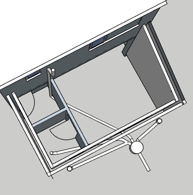

I need a little help with the arrangement of the drains and vent stack. Please see attached image.
The vent pipe has a soil, bath and hand basin connection to the first floor bathroom (not shown) and then goes through the tiled room into the roof void where it travels horizontally for a section and vertically through the ceiling into boxing and then into the floor of the cloakroom. Where the pipe goes into the floor, there will be a rodding point. The toilet in the cloakroom comes off a branch underfloor and exits through the foundation either sleeved or with a protective lintel as required. Would this be acceptable to BC as I intend to do a full plans submission?
Put it on the plans and see. It looks a bit Heath Robinson to me
How would you rod that section in the roof?
I thought the same about the rodding but then I figured it would be as difficult if it were to go vertically into the floor.
So you would have 2 bends in the wet portion of the soil stack and 2 bends in the underground drain before it got to the inspection chamber :!::eek:

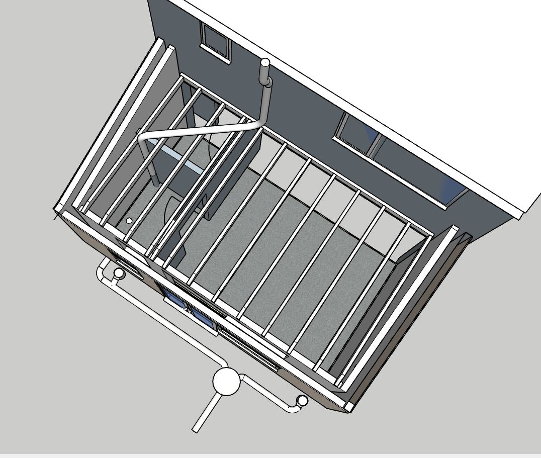

I think I see what you're getting at. Does the attached arrangement look better? The gully is roddable.
Would that manhole be right outside your bifolds?

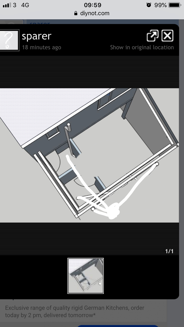

How’s about like this:

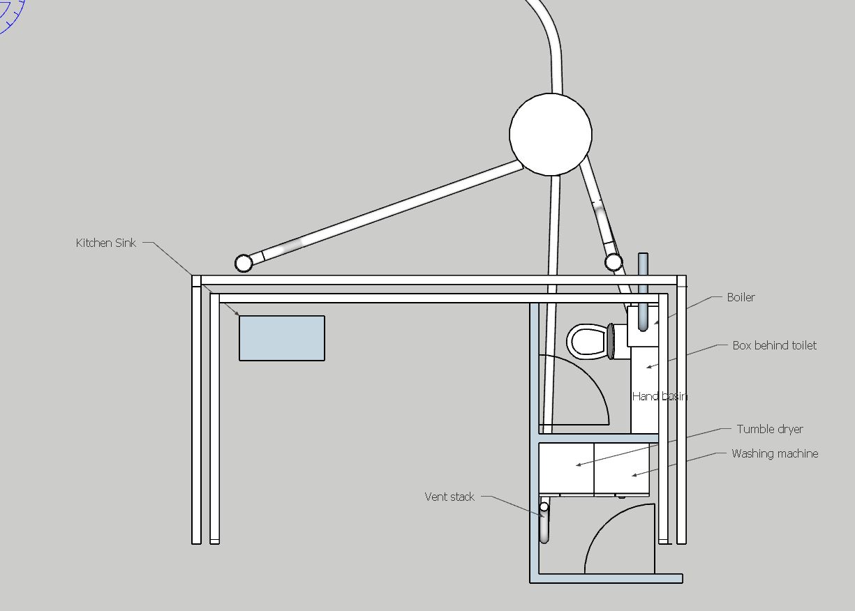

What are the two external gullies for?
There is a utility behind the WC so it is the washing machine drain on the left. Also need a drain for the hand.basin in the WC. The one on the right is for the kitchen and rainwater which is the current arrangement.
You wont be able to connect a new rain water drain to the foul water.
And its better to have internal connections for wastes.
I'll probably have to provide a soakaway for the rainwater then. I might put a short stack in the WC (over the handbasin height) with an AAV to connect branches to for grey water. I don't know of an alternative for the kitchen gully as the sink will be located under the window and the trap will exit through the wall. I guess I could bring a 100mm below where the sink will be and use one of those rubber converters to get 100mm down to 40mm. Is that what you were thinking Woody.
Getting there but why is there a bend in the drain after it exits from the new inspection chamber ? Generally the idea is to run drains in straight lines in the shortest distance between manholes/inspection chambers.
I was assuming that the current drain runs up the centre of the garden perpendicular to the property therefore the inspection chamber is now off to one side.
