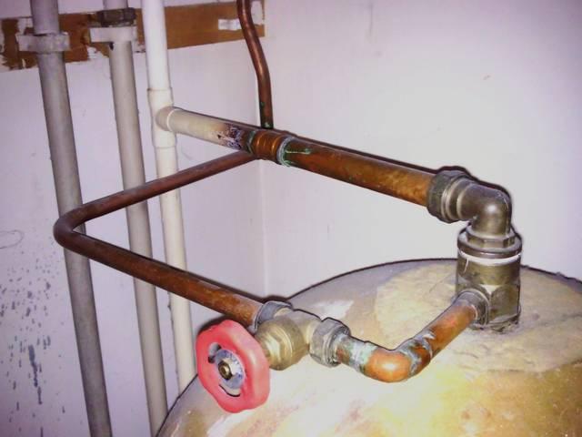

I'm installing a shower pump in the airing cupboard.
At the moment there is a 15mm hot feed that comes out of the top of the hotwater cylinder alongside the main 22mm feed. The 22mm then travels horizontally to the center of a T, where it travels vertically up as a vent, and vertically down to supply all the hot water outlets.
The 15mm pipe will travel horizontally, and then down to the shower pump on the floor of the airing cupboard.
My question is whether this 15mm pipe should have some kind of vent in it somewhere?
Obviously the pipe will be full of air when I first fit it, but when I then open the gate valve on the 15mm at the top of the hot water cylinder will this be sufficient to push the air out of the pipe?

Only showing the HOT shower feed (to try and gain some clarity), also coming from the flange on the top of the tank is the 22mm pipework for other hot water outlets and that does have a pipe that vents over the cold water tank in the loft.
If it does need a vent in the place indicated, what sort of vent do I need to get?
It shouldn't need a vent as you describe, since the design of the flange is precisely to prevent air entering the pump pipework.
Is it a Surrey flange?

I've now managed to take a photo of the current layout, which is hopefully an improvement on the ASCII art :P
From this you can see the flange on the top of the tank, and from your picture I believe it is going to be a surrey flange. You can also see the 15mm shower feed going via the gate valve before crossing and rising up the wall were it used to enter the old power-shower directly.
It's now my intention to disconnect this at the Gate valve compression fitting and then run the new leg across to the wall, then DOWN to the pump.
I can see that the flange will (should!) stop air entering the pipework when it's all in operation, but how will the air that is in there after I fit it then get out? Can it go back through the flange, then up the 22mm and out through the vent that way, or will the water pressure in the 15mm pipe be sufficient (after I open the gate valve!) to 'push' all that air down the pipe, through the pump, and then back out via the shower?

Assuming that it is a Surrey flange...
Once the pump is in, and before it is plugged in, you should prime it by directing the exit pipes from the pump into a bowl: this should remove any air and ensure the pump is full of water prior to use.

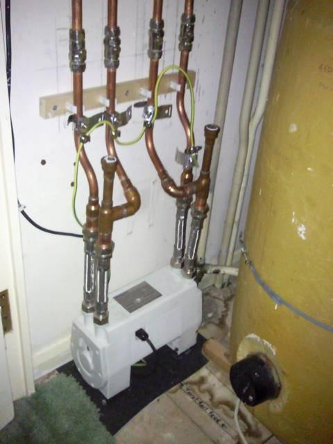

Also usual to have a 22mm feed to the pump rather than 15mm, but such a short feed would probably meet the pump manufacturer's requirements. If you keep the 15mm feed, I would change that gate valve for a full-bore lever isolating valve, just in case it doesn't completely open full-bore (and old gate valves sometimes refuse to close completely).

Is it 'standard' to put a set of valves on the supply side of the pump, AND on the feed-to-shower side? I'm thinking for servicing / changing the pump in the future. I don't imagine that a lot of water will be held in the outlet pipework to the shower, but also I think it might be more than I would want to have 'appearing' in the airing cupboard after undoing a joint, (might be more than a towel would cope with?)...
Thinking I may fit 4 of the lever valves, one on each of the inputs and outputs (hot and cold), least then if I have to remove / change the pump it is only the water held in the flexis that will come out...
It would certainly be standard to put a iso-valve on the supplies to the pump. The pump itself might come with valves on some or all of the flexi-connectors (of lesser quality).
Can't hurt to put them on the pump outputs though - you would never regret that move, but you might regret NOT having them at some point if you wanted to, for the reasons you mentioned.
I always like to see valves either side of a pump!

I actually did this a few weeks ago now, but I thought I would post a photo of the finished install in case anyone was interested :)
Thanks again for all the advice!
The vented pipes are on the outlet side of the pump, and came with the pipework that was fitted to the pump when I got it second hand, (inlet side had nothing, and outlet side had the vertical vents, but had been chopped at the side exit of the reducing T's)
