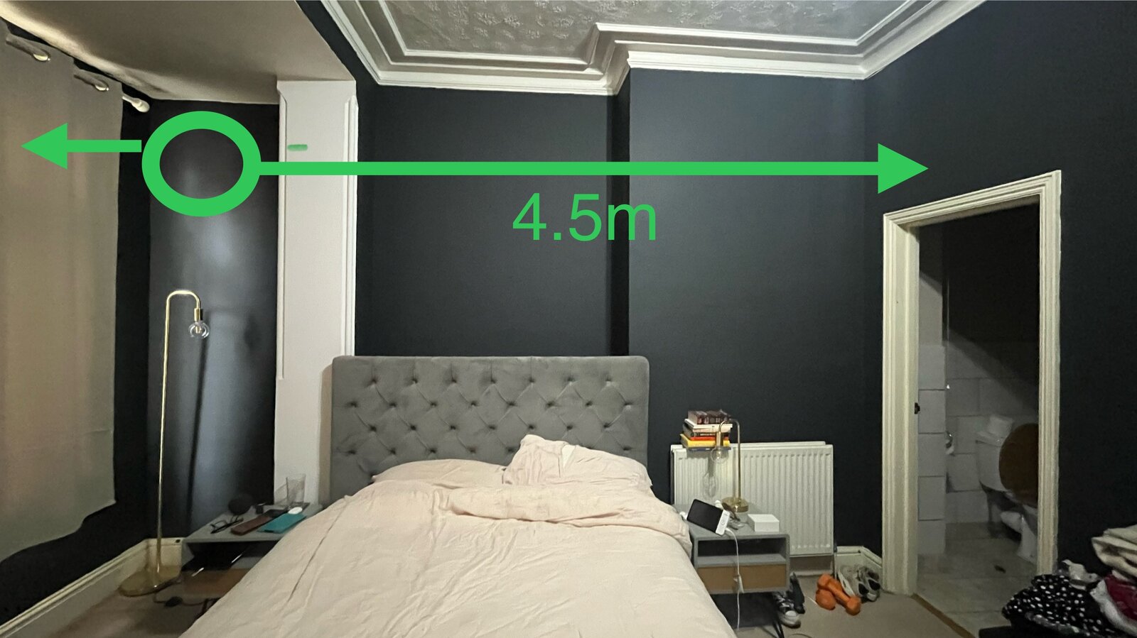

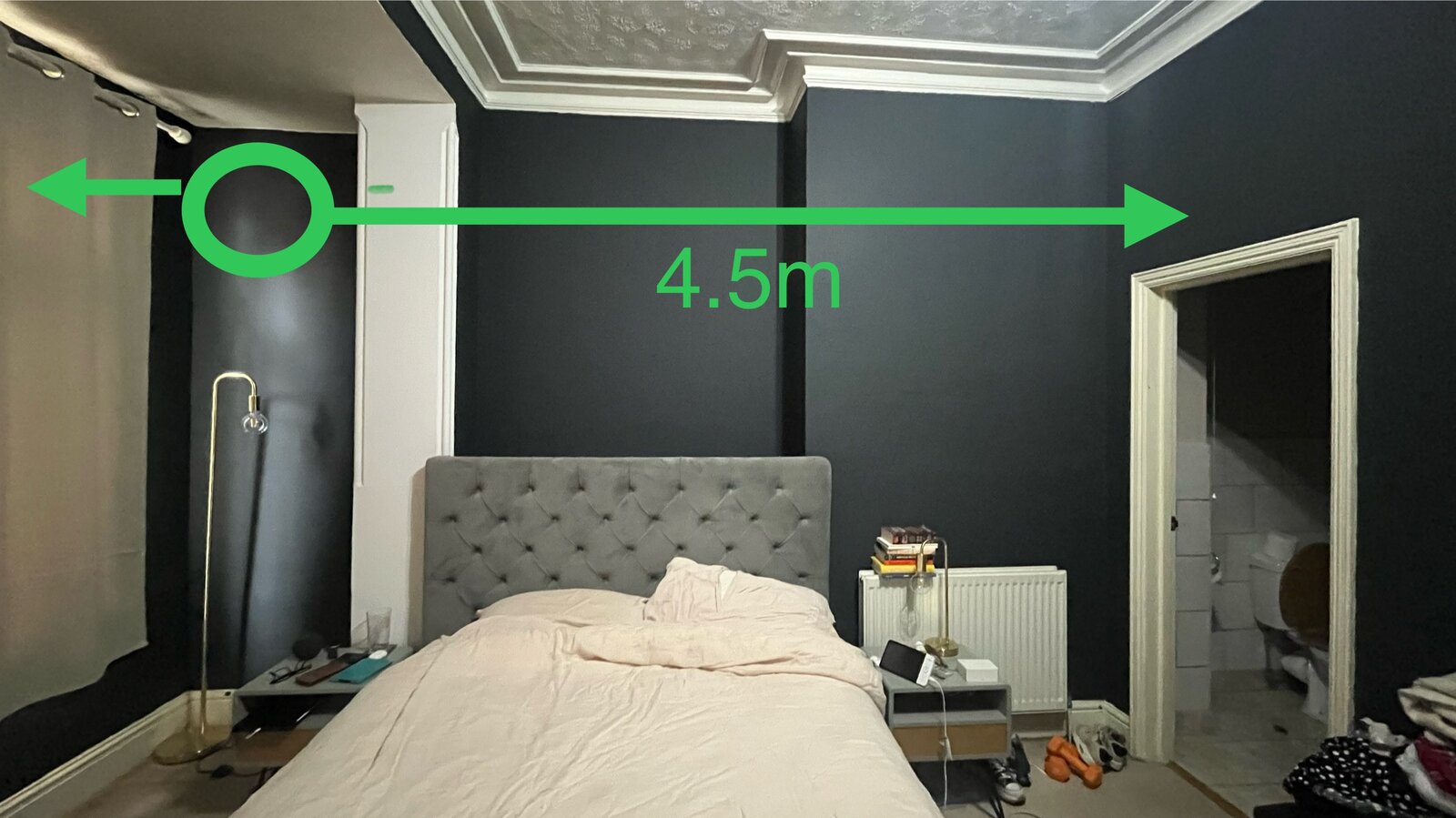

Hi all
My en suite (right of picture) is completely ‘internal’ - there’s no exterior walls. It’s right in the middle of my flat, and has zero ventilation.
It’s a period conversion, I’m on the ground floor and there’s 2 flats above me, so venting ‘upwards’ isn’t an option.
The closest exterior wall is on the left side of picture. I’ve been told that placing an inline extractor fan where the green circle is WON’T work - that a ducting run of 4.5m is too long for the extractor to pull from.
If anyone has any bright ideas I’d love to hear them! (Other than ‘move your bathroom’ which is no doubt correct but not an option, unfortunately)

You can get a more powerful ducted fan. Longer ducts need more power. Builders like to use cheap, ineffective fans.
In most cases a 110m diameter round duct is used, but you can also get rectangular ones that might be less obtrusive. Smaller ducts will obstruct flow and be noise. 125mm and 150mm ducts are sometimes used. Sometimes they can be run between joists or on top of or inside wall cabinets, such as in a kitchen. It is usually preferable to run the duct to the closest external wall. Ducts can be painted to match ceilings or walls or boxed in.
Ducts can also be run under floors and inside disused chimneys.

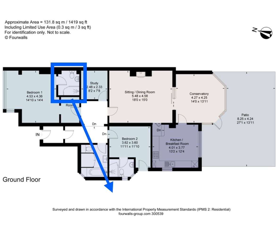

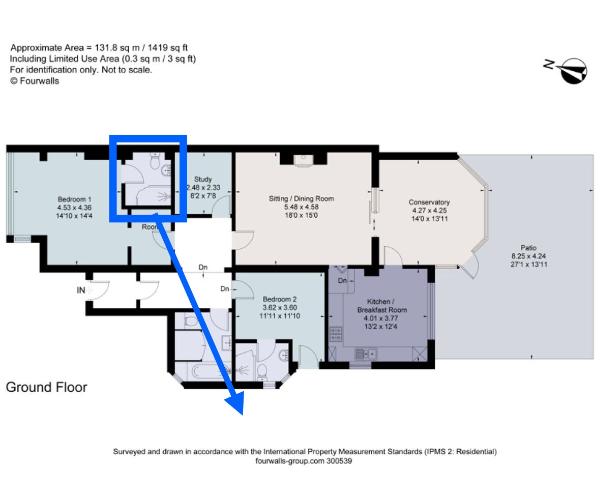

Where does the plumbing go?
Show us a floor plan please.

Thanks!
It was done in the early 90’s I believe, and judging by the rest of the property, I don’t think ‘building regs’ were high up on their list.
I *think* the plumbing heads out as per this new picture.
Do you think a 150mm inline fan will have the necessary power? Or maybe I should just buy one and test it??

Or go across to the entrance hall and go 'out through the in door' or at least on that bit of wall.

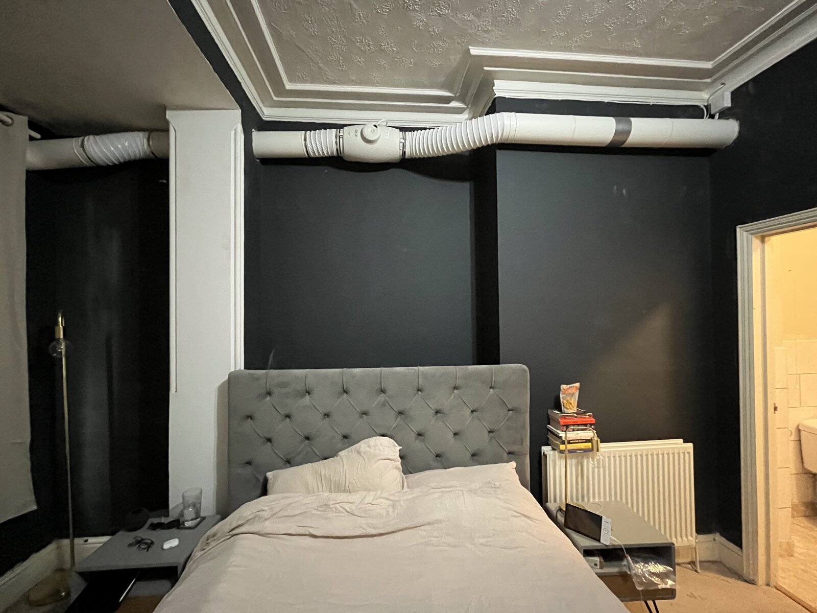

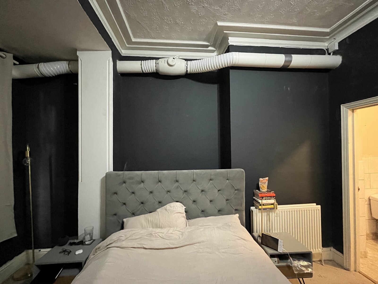

If anyone is interested, here’s how it worked out. The fan, if anything, is possibly too powerful! Ventilation is really effective. And yes, I’m going to box it all in…
