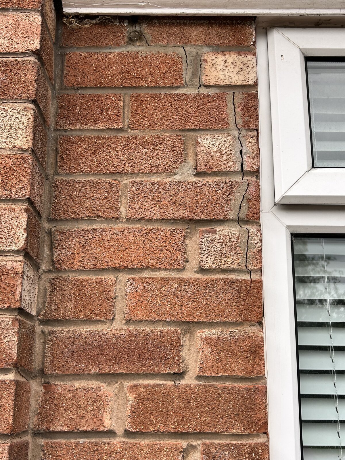

In the final stages of a house purchase and returned today following a Level 2 survey highlighting some potential issues with the over-garage extension. The survey didn’t mention these cracks outside the living room though, which we spotted only today. We’re going to push for the vendors to stump up for a structural inspection but in the interest of not wasting anyone’s time, does this type of crack always mean subsidence etc? Or could it be something less troublesome? Thanks in advance
Doesn't look like anything particularly serious - maybe a too-short bearing of the lintel over the window putting additional stress on the edge of the brickwork.

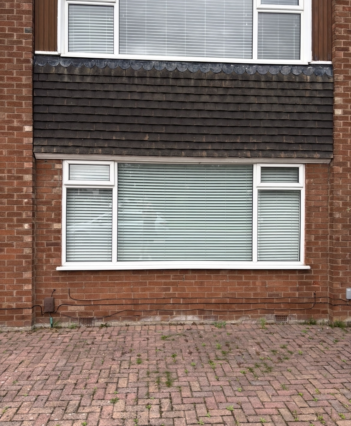

It would be better if you could show a pic from further back so that we could see the context.
That has signs of being pointed up before on both the existing crack and to the left on the bricks, it looks a different colour mortar, im not a builder but a diyer.

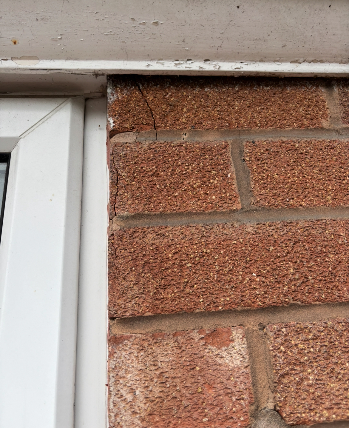

Hi Tony, thanks for coming back to me. Attached a wider pic and also a pic of a smaller crack to the other side of the window.
Yes I thought that too - someone’s tried to patch it up. My worry was that this new mortar has come away which I was concerned was a sign of further movement..?
To me they look like someone has been extremely heavy handed putting window fixings in. Perhaps they used concrete screws and blew the bricks?
