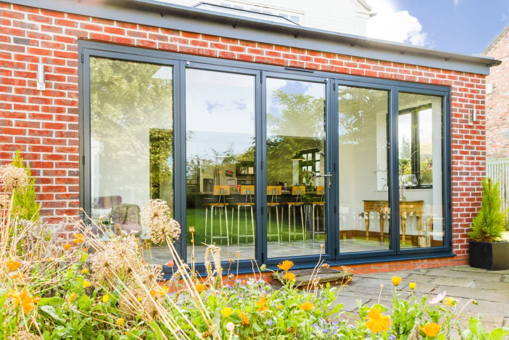

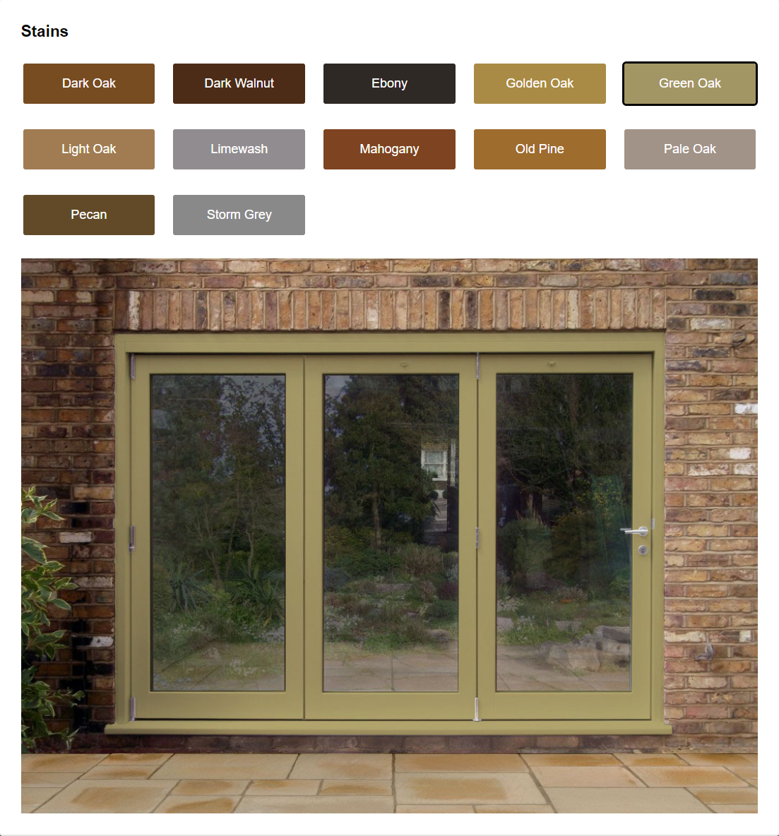

I saw some builder lay the brickwork vertically above the bifold door( potientially on the steel beam), some are not. Why is that? Better structural support or purely decorative?

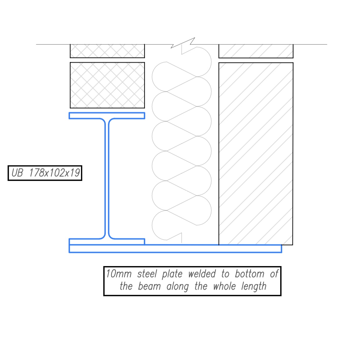

Another question, my builder is confused with this structural section drawing for that part, is the steel beam gonna “ exposed “ from outside?? how to lay the brickwork for that?

The plate should be on the outside and internal blockwork sat on beam, the soldier course above the lintel is for aesthetics, either way is ok.
Im confused too. The section drawing has bricks on the beam and blocks on the plate. That plate will also bend if formed like that.
Common woody, you know as well as me the hatching symbols for brick and block. Cross section of the beams showing a soldier course and coursing block.
No way!
That can't be a soldier on the right, it's about 3x as high as it is wide. :p
