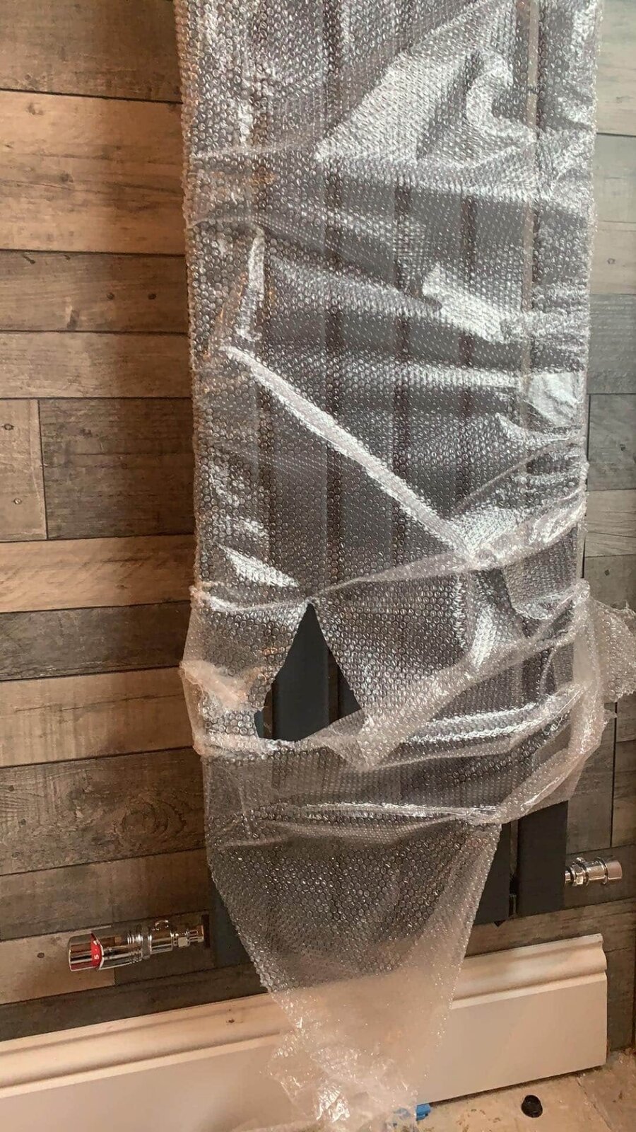

I’m doing this myself and never had a vertical rad before
Do these valves ok or not?
Be carefull and read the instructions with the rad , some have a baffle fitted and the pipes are connection sensitive , or in simple terms the Flow can only go on one side unlike a conventional rad where it doesnt matter
Ok thanks will check
do the valves look ok on the sides like that?

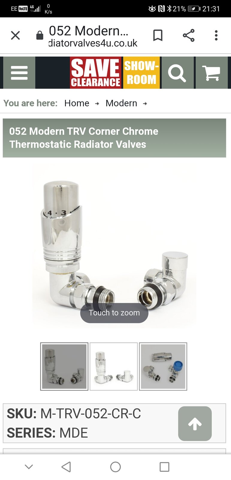

I had some TRV's fitted as you show, the problem was reading the display, in the future you may want to fit some thing like this
which gives more control, and you want to be able to read the display, however TRV's will still work as shown.
