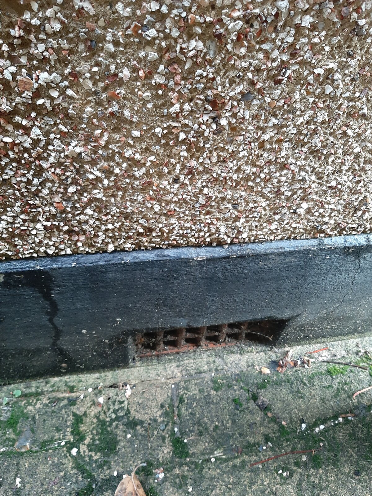

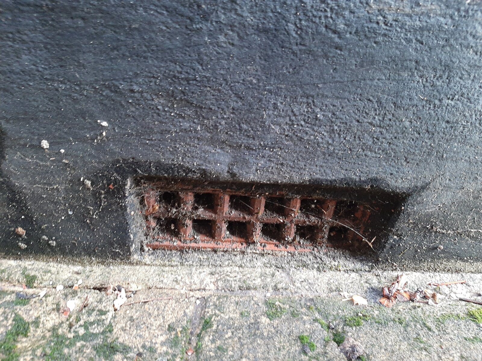

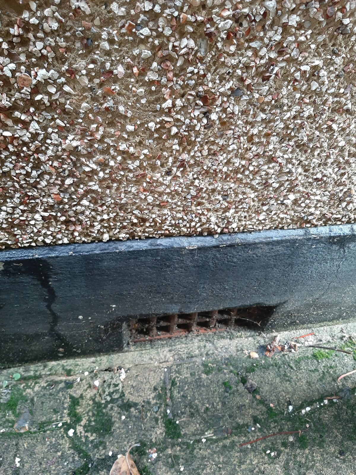

Very low ventilation to ground floor
7 Sep 2008
579
21
Kent
I have several of these around the house wall and I suspect that they allow water in during heavy rain. Is it OK to block them until next summer? What would be the best way?
They ventilate your floor space and prevent timbers rotting. Do not block.
The external ground level should be lowered to prevent rain ingress.
